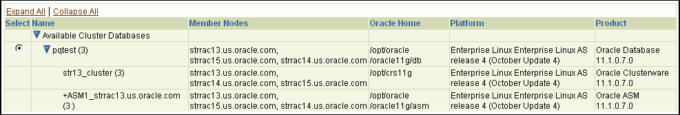

    1. In the Select Real Application Clusters (RAC) section, select the Oracle RAC you want to extend. The associated clusterware and Automatic Storage Management (ASM) also get extended if they are not already existing.
      You can use the Search section to search for a particular Oracle RAC. From the Search list, select the target type based on which you want to search, and click Go. You can use wildcards such as % and *.
      If the cluster database you want to extend does not appear on this page, then:
      • Specify the clusterware home location for the cluster target in Enterprise Manager Grid Control. In Grid Control, click the Targets tab, and then click the All Targets subtab. On the All Targets page, from the Search list, select Cluster and click Go. From the results table, select the cluster for which you want to specify the clusterware home location. On the Cluster Home page, in the Related Links section, click Monitoring Configuration. On the Configure Target page, specify the clusterware home location and click Update.
      • Configure Enterprise Manager Grid Control settings to display them. In Grid Control, click the Deployments tab, and on the Deployments page, in the Configuration section, click Refresh Host Configuration. On the following page, from the Available Hosts pane, select the hosts and add them to the Selected Hosts pane. Then, click Refresh Hosts and wait for the job to succeed. Return to this Deployment Procedure page and run the search query again to view the hosts in the search results.

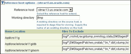

    2. In the Reference Host Options section, from the Reference Host list, select a host that you want to use as the primary host for performing this operation. Reference Host is the host that is selected for creation of clone archives and then transferred to the new target nodes being added.
      Reference host options
      For Working directory, specify the full path to an existing directory on the selected host that can be used for staging files for cloning. If the directories you specify do not exist on the target hosts, then they will be created by the Deployment Procedure. Ensure that the working directory is NOT shared on the nodes.
      For Files To Exclude, for each Oracle home, specify the files you want to exclude while performing this operation. Note that any file or folder corresponding to the regular expressions provided here will be excluded.

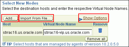

    4. In the Select New Nodes section, click Add to add new nodes that you want to include to the selected Oracle RAC. After adding the node, specify the virtual node name for each new node and verify the values displayed by default.
      Select New Nodes
      Ensure that you select nodes that are monitored by Oracle Management Agents 10g Release 5 (10.2.0.5) or higher.
      Optionally, you can click Show Options to specify Private Node Name, Private IP, Virtual IP, and Working Directory. Private Node Name and Private IP are required only if you want to set up a private network as part of the procedure.Virtual Node Name and Virtual IP are required only if they are fixed and not DHCP-based. If the node is already part of the Oracle Real Application Clusters (RAC) system, it will be ignored. If the node is part of the Oracle Clusterware, the private network and virtual host information will be ignored. For Working Directory, ensure that the location you specify is NOT shared on the nodes.
      If you already have these details stored in cluster configuration file, then click Import From File to select that cluster configuration file. This file typically contains information about the new nodes to be added. It may also include information about the private node name, private IP address, virtual host name, and virtual IP address to which the Oracle RAC should be extended.

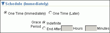

    6. In the Schedule section, schedule the Deployment Procedure to run either immediately or later.
      Schedule
