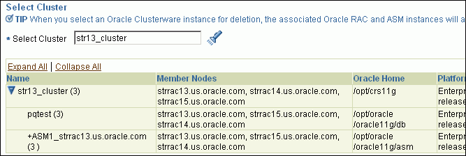

    1. In the Select Cluster section, click the torch icon for Select Cluster and select an Oracle Clusterware instance that you want to delete. Along with the selected Oracle Clusterware, the associated Oracle RAC and ASM instances will also be deleted. The table displays details about the member nodes that are part of the selected Oracle Clusterware.
      Select Cluster
      When you use the torch icon to search for Oracle Clusterware, if you do not find the Oracle Clusterware that you are looking for, then from the tip mentioned below the table, click here to manually provide details about that clusterware and search for it.
      This is particularly useful when you want to delete partially-provisioned or configured Oracle Clusterware instances because, by default, when you click the torch icon, only the fully-provisioned clusterware instances appear for selection. In this case, to search, select, and delete the partially-provisioned instances, click here, and in the Enter Cluster Details window, manually provide details about the cluster node that contains the partially-provisioned instance and click OK. You can then select the host that appears in the Select Nodes to Delete section and mark for deletion.

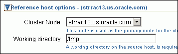

    2. In the Reference Host Options section, from the Cluster Node list, select a node that you want to use as the primary node for all cleanup operations.
      Reference host options
      For Working directory, specify the full path to an existing directory on the selected node that can be used for staging files temporarily.

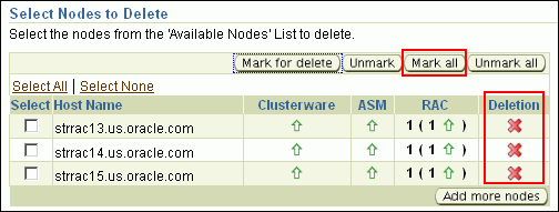

    3. In the Select Nodes to Delete section, click Mark all to select all the nodes for deletion. On clicking Mark all, you should see a cross icon against all the nodes in the Deletion column. These cross icons indicate that the nodes have been selected for deletion.

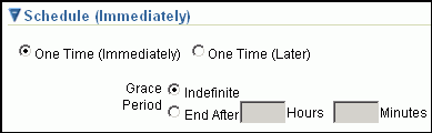

    5. In the Schedule section, schedule the Deployment Procedure to run either immediately or later.
      Schedule

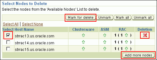

    3. In the Select Nodes to Delete section, select the nodes you want to delete, and click Mark for delete. On clicking Mark for delete, you should see a cross icon against the selected nodes in the Deletion column. These cross icons indicate that the nodes have been selected for deletion.
      If you do not see the nodes that are part of the cluster, then click Add more nodes to add those nodes so that nodes that do not appear as targets in Enterprise Manager Grid Control also are selected for deletion.
      If you want to deselect a node, click Unmark. If you want to select all nodes at a time, click Mark all, and if you want to deselect all nodes, click Unmark all.
