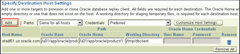

    2. In the Specify Destination Host Settings section, click Add and select the target hosts on which you want to clone the existing instance of Oracle Database Replay Client.
      By default, Oracle Base, Oracle Home, and Working Directory are prefilled with sample values. Edit them and specify values that match with your environment and standards. If the directories you specify do not exist on the target hosts, then they will be created by the Deployment Procedure.

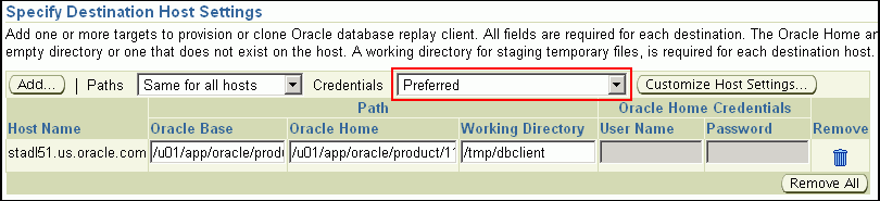

      From the Credentials list, retain the default selection, that is, Preferred, so that the preferred credentials stored in the Management Repository can be used.
      Credentials
      You can optionally override these preferred credentials. The credentials you specify here are used by the Deployment Procedure to run the provisioning operation. If this environment is secure and has locked accounts, then make sure that:
      • The credentials you specify here have the necessary privileges to switch to the locked account for performing the provisioning operation.
      • The Deployment Procedures has been customized to support locked environments.
      For more information, see Chapter 23, "Customizing Steps to Run as Another User".

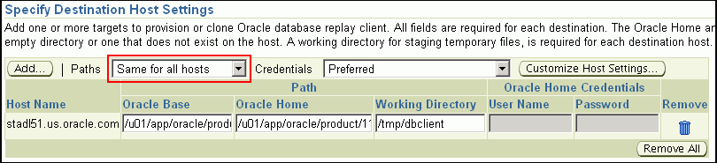

      If you have selected multiple hosts, then from the Path list, select Same for all hosts if you want to use the same path across hosts, or select Different for each host if you want to use different paths for each host.
      Paths

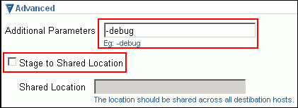

    3. (Optional) In the Advanced section, specify any additional parameters you want to run while installing the Oracle Database Replay Client. For example, -debug, -invptrloc. You can specify any Oracle Universal Installer (OUI) parameter that can be used in this provisioning operation.
      While installing software binaries from an existing Oracle Database Replay Client location, if you want to also stage them to a shared location, then select Stage to Shared Location and specify a location that is shared across all destination hosts. This staged location can also act as a source for future deployments.
      Advanced

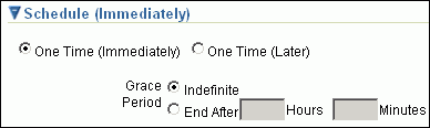

    4. In the Schedule section, schedule the Deployment Procedure to run either immediately or later.
      Schedule

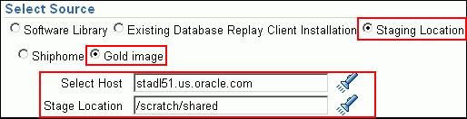

  4. On the Select Source and Destination page, do the following:
    1. In the Select Source section, select Software Library. Then click the torch icon for Component and select the generic component that has the gold image. Ensure that you select only components that are in "Ready" status.
      Select Source
      If you do not see the required component in the Software Library, then follow the workaround described in Appendix A, "Troubleshooting Issues".
    2. In the Specify Destination Host Settings section, click Add and select the target hosts on which you want to install the gold image of Oracle Database Replay Client.
      Credentials
      Paths
    3. (Optional) In the section, specify any additional parameters you want to run while installing the Oracle Database Replay Client. For example, -debug, -invPtr. You can specify any other Oracle Universal Installer (OUI) parameter that can be in this provisioning operation.
      While installing the Oracle Database Replay Client location, if you want to also stage them to a shared location, then select Stage to Shared Location and specify a location that is shared across all destination hosts. This staged location can also act as a source for future deployments.
      Advanced
      Schedule
    1. In the Select Source section, select Staging Location, and then select Gold Image. Click the torch icon for Select Host and select the host on which the gold image is staged. Then click the torch icon for Stage Location and select the location where the gold image is staged.
      Select Source
      Credentials
      Paths
      While installing, if you want to also stage them to a shared location, then select Stage to Shared Location and specify a location that is shared across all destination hosts. This staged location can also act as a source for future deployments.
      Advanced
      Schedule

    2. In the Specify Destination Host Settings section, click Add and select the target hosts on which you want to install the Oracle Database Replay Client.
      Credentials
      Paths
    3. (Optional) In the section, specify any additional parameters you want to run while installing the Oracle Database Replay Client. For example, -debug, -invptrloc. You can specify any other Oracle Universal Installer (OUI) parameter that can be in this provisioning operation.
      While installing software binaries from the Software Library, if you want to also stage them to a shared location, then select Stage to Shared Location and specify a location that is shared across all destination hosts. This staged location can also act as a source for future deployments.
      Advanced
      Schedule
