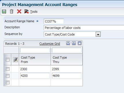

This section provides an overview of account ranges and discusses how to set up an account range name.
You can set up account ranges to restrict the accounts that the system displays in the Project Management Console form. You use the Project Management Account Ranges program (P51X100) to specify the account range name and whether to sequence the accounts by cost type and then cost code, or by cost code and then cost type. The system saves the account range information in the Account Range Table (F51X100).
When you set up account ranges, you:
Can specify multiple account ranges.
Can specify account ranges that overlap.
Do not need to specify contiguous account ranges.
For example, you could set up these ranges under one account range name:
1001 – 2000
1800–2799
This range overlaps with the 1001 – 2000 range.
5000–5499
This range is not contiguous with the 1001 – 2000 or 1800–2799 ranges.
You can use the account range names that you set up when you set up visual alert columns and when you specify your selection criteria on the Work with Project Management Console form.
You can use the account range names that you set up in the Project Management Account Ranges program when you set up column definitions for visual alerts. When you specify an account range in a visual alert column, the system applies the alert thresholds to only the accounts within the specified range.
When you set up account range names, you specify the sort order of the accounts. You can specify to use either the Cost Type/Cost Code or the Cost Code/Cost Type order.
You also specify a sort order when you specify your selection criteria on the Work with Project Management Console form. Because the sort order of the account range that you use must match the sort order that you specify on the Work with Project Management Console form, the system allows you to select only account range names that are assigned the sort order that you select on the Work with Project Management Console form. For example, if you select the Cost Code/Cost Type option in the Sequence by field on the Work with Project Management Console form, then you can select from only the account range names that are assigned the Cost Code/Cost Type sort order in the Account Range Name field.
See Cost Sequences.
To set up an account range name:
Access the Project Management Account Ranges form.
| Form Name | Form ID | Navigation |
| Project Management Account Ranges | W51X100A | In-Memory Project Portfolio Mgmt (G51411).
Project Management Account Ranges (P51X100). Click Add on the Work with Project Management Account Ranges form. |
Figure 2-2 Project Management Account Ranges form
Enter values in these fields:
Enter a name for the account range. You will use this name to enter the account range when you specify a range for a visual alert column or on the Work with Project Management Console form. This field is required.
Enter a description for the account range. This field is optional.
Select Cost Code/Cost Type to sequence the account range by cost code. Alternatively, select Cost Type/Cost Code to sequence the account range by cost type.
Specify the beginning of the account range. You complete this field only when you select Cost Code/Cost Type in the Sequence by field.
Specify the end of the account range. You complete this field only when you select Cost Code/Cost Type in the Sequence by field.
Specify the beginning of the account range. You complete this field only when you select Cost Type/Cost Code in the Sequence by field.
Specify the end of the account range. You complete this field only when you select Cost Type/Cost Code in the Sequence by field.
Click OK.
