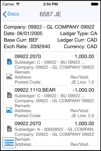

The G/L Batch Approvals smartphone application enables you to review journal entries that are pending approval, and approve them from your mobile device.
Before you can use the application, you must download and install the application from the application store on your device.
To open the application, tap the G/L Appr icon and log in.

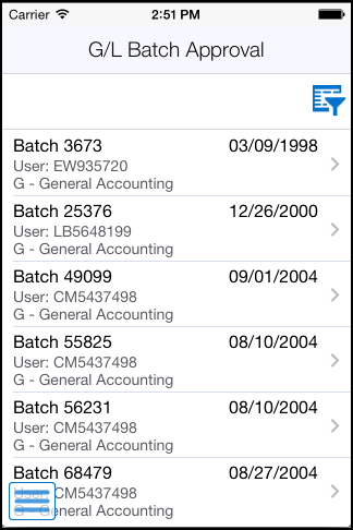

From the G/L Batch Approval home screen, you can view the list of batches that are currently awaiting approval.
Figure 25-3 G/L Batch Approval Home Screen: Smartphone
To refine the batches that appear on your screen, tap the filter icon at the top right of the screen.
You can use these fields to filter the batches:
Batch Date
User
Batch Number
Batch Type
By default, the system populates this filter field with the batch type specified in the Batch Type processing option of the version of the Work With Batches program (P0011) that you use for the mobile application.
In the Filters pane, to continue the search using the specified filter values, tap the Apply button. When you tap the Apply button, the system:
Takes you to the list of batches that are displayed based on your filter values.
Saves the filter values that you entered. The next time you open the filter screen, the system displays the filter values.
To discontinue the use of filter values in your search, tap the Cancel button. When you tap the Cancel button, the system:
Takes you to the list of batches associated with the last saved filter values, if applicable.
Ignores the filter values that you entered, and restores the last saved filter values to the filter fields.
To delete all the filter values that you specified, and to enter new filter values, tap the Clear button.
To review a batch, tap the batch from the list of batches.

To view line-level information of the document, tap the document.
Figure 25-5 Document Details: Smartphone
The system displays the document screen, and you can:
Review the document header information, such as company, ledger type, ledger currency, base currency, and exchange rate.
Review line-specific information, such as the account number and description, company address number and description, subledger information, the journal entry line number, remark, posted code, address number, whether reverse or void, and the amount.
To review text attachments associated with a journal entry line, tap the top icon on the left of the line. The system retrieves the text attachment from the base EnterpriseOne system and displays the texts in a different screen. To view photos attached to a journal entry line, tap the icon below the text attachment icon. The system displays the Photos screen with a list of photos in the left pane, and the first photo in the list on the right pane.
When there are no image and text attachments associated with the journal entry line, the icons are disabled.
To go back to the list of documents in the batch, tap the Docs button at the top left of the screen.
