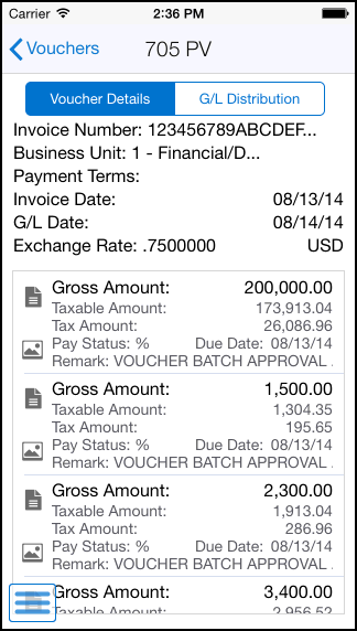

Figure 29-5 Voucher Details Screen: Smartphone
The system displays the Voucher Details screen, and you can:
Review the voucher header information, such as invoice number and date, exchange rate (if it is a foreign transaction), G/L date, payment terms, and business unit.
Review line-specific information, such as the gross amount, taxable amount, tax amount details, pay status, due date, and remarks associated with the line.
To review text attachments associated with the voucher line, tap the top icon on the left of the line. The system retrieves the text attachment from the base EnterpriseOne system and displays the texts in a different screen. To view photos attached to a voucher line, tap the icon below the text attachment icon. The system displays the photos screen with a list of photos in the left pane, and the first photo in the list on the right pane.
When there are no image and text attachments associated with the voucher line, the icons are disabled.
To review general ledger distribution information, tap the G/L Distribution tab. You can review header information, such as the supplier address, tax rate/area, amount to distribute, exchange rate, and G/L date.
Below the header information, you can review line-level details of how the invoice amount is distributed to multiple accounts. You can tap on the text and image icons to view text and image attachments.

From the Voucher Batch Approval home screen, you can view the list of batches that are currently awaiting approval.
Tap the batch that you want to approve. The system takes you to the screen that has a list of vouchers.
To approve the batch, tap the Approve button.
On the Confirm Approval screen, tap the Approve button to approve the batch. Note that you can also click Cancel if you do not want to proceed.
If you are not an approver, the system displays an error message when you select the Approve button.
After approving a batch, the system returns you to the home screen. Notice that the batch you approved is no longer displayed.
