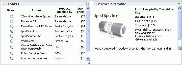

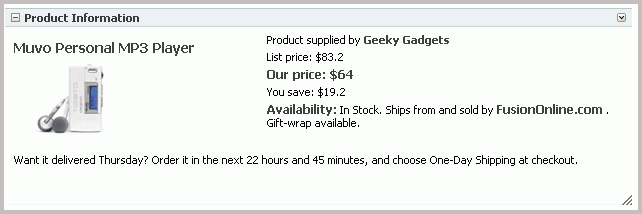

Figure 6-1 shows how the portlets section of your page will look.
Figure 6-1 Portlets Section of MyPage.jspx

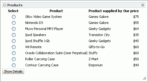

In this step, you will create an application based on the Portlet Producer template, then build a standards-based portlet. Afterward, you will consume the portlet into our Tutorial application. Figure 6-2 shows the portlet at runtime in MyTutorialApplication.
Figure 6-2 Standards-Based Portlet (JSR 168) at Runtime in MyTutorialApplication

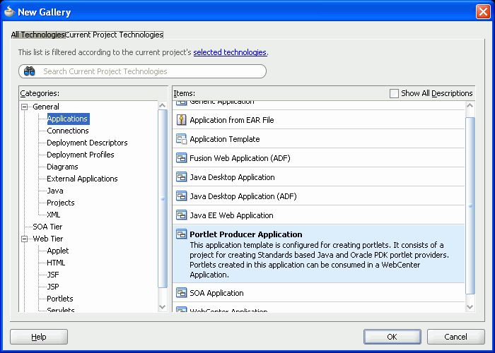

In Oracle JDeveloper, create a new application based on the Portlet Producer Application template (Figure 6-3), then click OK. To do so, choose New from the File menu to display the New Gallery.
In the New Gallery, choose Applications from the Categories list, then choose Portlet Producer Application.
Figure 6-3 Creating a New Portlet Producer Application

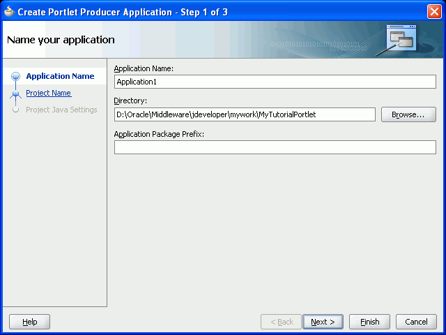

In the Create Portlet Producer Application wizard, in the Application Name field, enter MyTutorialPortlet.
By default, the Directory field should contain the directory where the application will reside (Figure 6-4). You can change the directory location, if you like, but let's leave it as it is for the purposes of the Tutorial.
Figure 6-4 Creating a Portlet Producer Application - Step 1

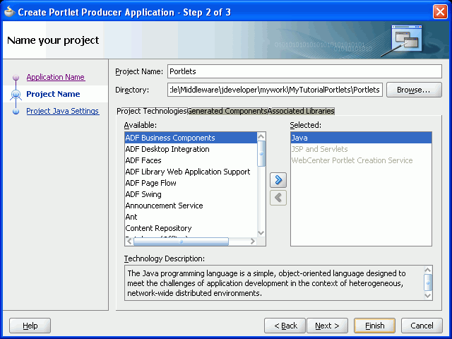

On the Project Name page of the wizard (Figure 6-5), let's leave the default name: Portlets, and click Next.
Figure 6-5 Creating a Portlet Producer Application - Step 2

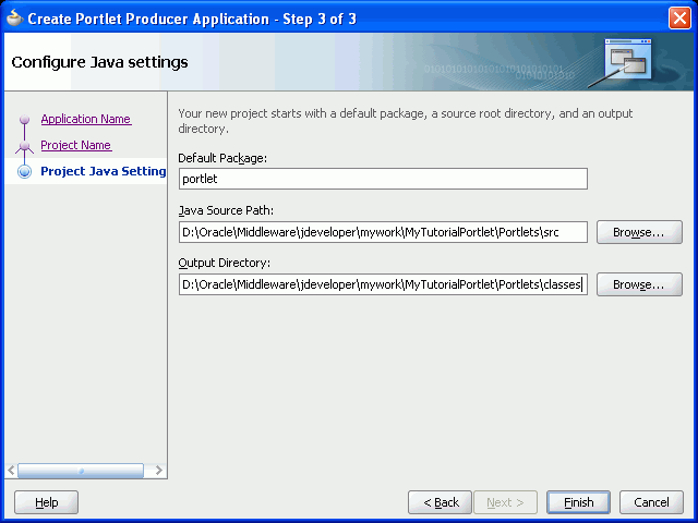

On the last page of the wizard, you can configure the Java settings. You can see that the default package contained in the portlet producer application is portlet (Figure 6-6). For the purposes of this Tutorial, let's leave the default options and click Finish.

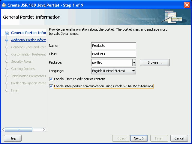

On the General Portlet Information page, in the Name and Class fields, enter Products.
| Note:The steps to build this portlet rely on the naming convention we've used, so follow the steps carefully. If you do not use the names we've provided, you may not achieve the same results. |
Select Enable inter-portlet communication using Oracle WSRP V2 extensions. Selecting this option enables your portlet to support Oracle WSRP 2.0 extensions, and generates the oracle-portlet.xml file that is used for WSRP 2.0 features, such as navigation parameters. We will need these parameters later on, when we enable the OmniPortlet and this portlet to communicate with each other. Figure 6-9 shows how the General Portlet Information page should now look.
Figure 6-9 Creating a JSR 168 Java Portlet - General Portlet Information

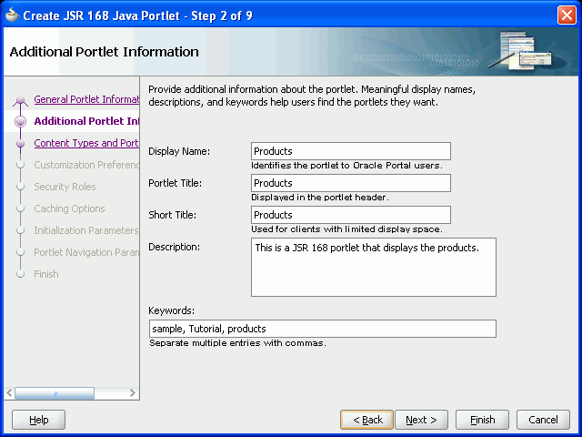

On the Additional Portlet Information page, we can either leave the defaults or, because we know we are going to show a few details about the products in our database, we can change the display name so anyone using the portlet will know what the portlet contains. Update the fields on this page according to Table 6-1. Figure 6-10 shows the resulting Additional Portlet Information page.
Table 6-1 Name and Attribution Values
| Property | Value |
| Display Name | Name that will appear in the JDeveloper Component Palette. Because you entered Products as the class name, this field is automatically populated with that name. |
| Portlet Title | Title that will appear on the portlet header. Because you entered Products as the class name, this field is automatically populated with that name. |
| Short Title | Title that will appear on the portlet header on mobile devices. Let's leave the default name,  |
| Description | Description of the portlet. This field is relevant only when the portlet is used in an Oracle Portal 10g environment. Enter a description, for example,  |
| Keywords | Keywords provide additional information about a page, item, or portlet so that users can locate it during a search. Although keywords are not supported by Oracle WebCenter Suite or Oracle Portal 10g, they are supported by other vendors from whom you may have obtained a deployment environment. Enter  |
Figure 6-10 Creating a JSR 168 Java Portlet - Additional Portlet Information

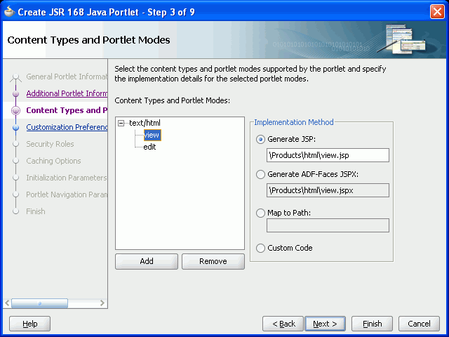

On the Content Types and Portlet Modes page, notice that text/html is the default content type. That means that the portlet will support text encoded with HTML. View and edit are listed as the default portlet modes for text/html. View is always available as a portlet mode; edit mode provides a page that allows users to personalize the portlet instance.
Notice the Implementation Method area as shown in Figure 6-11. These controls enable you to specify whether you want to generate JSP for the portlet, or use your own custom JSP code.
Figure 6-11 Creating a JSR 168 Portlet - Content Types and Portlet Modes
In this lesson, we'll ask JDeveloper to generate JSPs for us by leaving the default selection.

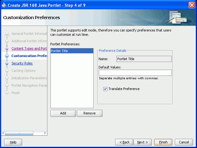

Although you could click Finish here and produce a basic portlet, let's continue and choose some other options and settings for our portlet.
On the Customization Preferences page, let's leave the default values and click Next (Figure 6-12).
Although we're not going to do anything with this page now, in the future you can use it to add other customization options for the portlet. For example, if your portlet accepted a Zip Code parameter, you might want to allow users to personalize the Zip Code label. If this were the case, you would use the Add button to make the Zip Code label personalizable.
Figure 6-12 Creating a JSR 168 Java Portlet - Customization Preferences

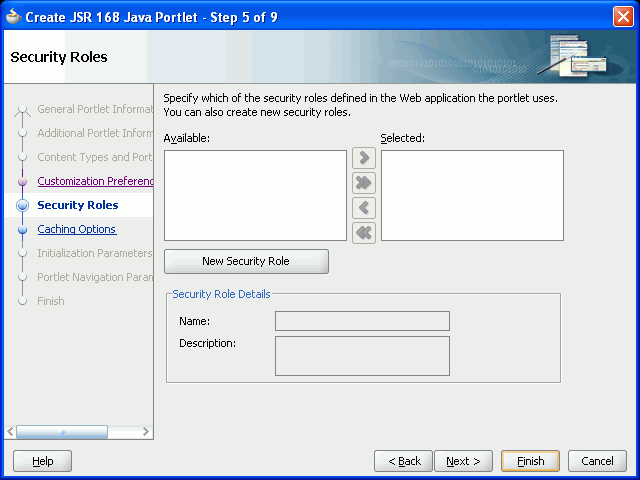

On the Security Roles page, click Next (Figure 6-13). The Security Roles page is used to specify which of the application's security roles you want to establish for this portlet.
Figure 6-13 Creating a JSR 168 Java Portlet - Security Roles

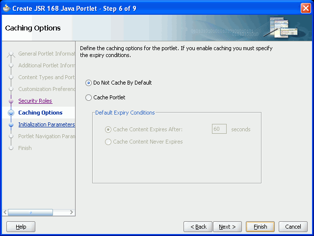

On the Caching Options page, leave the default option and click Next (Figure 6-14).
The settings on this page enable you to define expiry-based caching for your portlet. You do not need any caching conditions now.

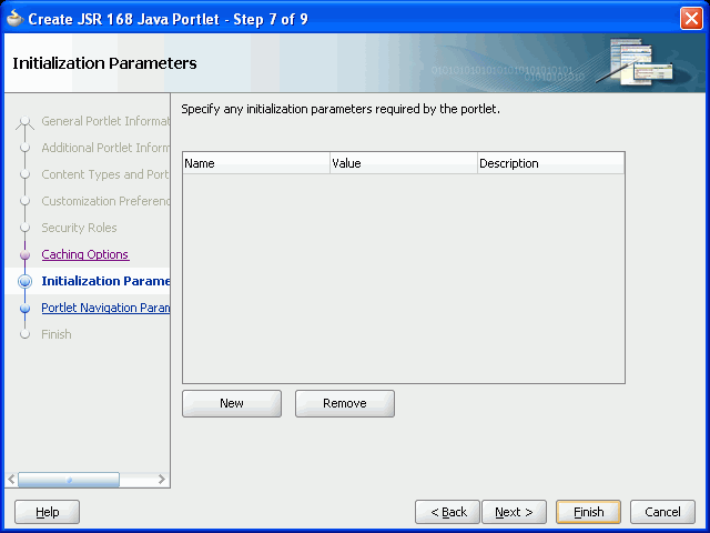

On the Initialization Parameters page, click Next (Figure 6-15). Our portlet does not require any initialization parameters.
Figure 6-15 Creating a JSR 168 Java Portlet - Initialization Parameters

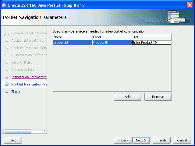

On the Portlet Navigation Parameters page, let's create a navigation parameter based on the product ID.
Navigation parameters are a WSRP 2.0 feature. This page enables you to specify external parameters to be consumed by the standards-based portlet, and only displays if you select the Enable inter-portlet communication using Oracle WSRP V2 extensions option on the first page of the wizard.
Click Add.
Double-click the values and update each value to the following:
Label: Product ID
Hint: Enter Product ID
We will use these navigation parameters later on in Step 10: Wire the Standards-Based Portlet and OmniPortlet Together. Figure 6-16 shows the updated Portlet Navigation Parameters page.
Figure 6-16 Creating a JSR 168 Java Portlet - Portlet Navigation Parameters

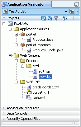

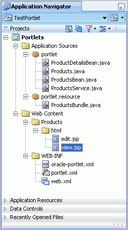

After you click Finish, you should be able to locate several newly generated files in the Application Navigator under the Portlets project. The expanded Navigator looks like Figure 6-17.
Figure 6-17 Files Generated for the New Portlet
Under Application Sources, under portlet and portlet.resource, notice two Java classes:
Products.java is invoked by the portlet container. It contains all the methods required by the portlet standards.
ProductsBundle.java contains all the translation strings for the portlet.
Under Web Content, Products, html:
edit.jsp, which contains the information needed to populate the Personalize dialog.
view.jsp, which is invoked when the portlet is sharing the page with other components.
Under Web Content, WEB-INF, three deployment descriptors:
oracle-portlet.xml, which contains information to support Oracle extensions for import/export and inter-portlet communication. It appears because you chose Enable WSRP V2 inter-portlet communication using Oracle extensions on Step 1 of the wizard.
portlet.xml, which specifies all the portlet resources (the information you entered through the JSR 168 Java Portlet Wizard).
web.xml, which specifies the web application resources.

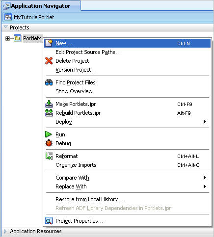

In the Application Navigator, right-click the portlet package, and choose New. Figure 6-18 shows the portlet package in the Application Navigator.

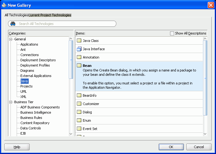

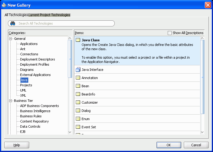

In the New Gallery, click the All Technologies tab.
In the Categories list, under General, choose Java, select Bean from the Items list, then click OK (Figure 6-19).

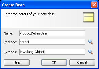

In the Create Bean dialog that displays, enter the following information to set up the new JavaBean (Figure 6-20):
Package: portlet
Extends: java.lang.Object
This creates a new bean called ProductDetailsBean in the portlet package.
Click OK. The new JavaBean displays in the Design window (Figure 6-21).

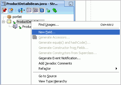

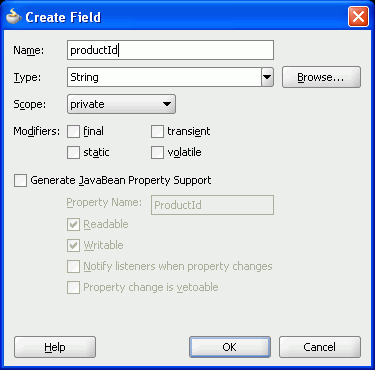

Now that we've set up our JavaBean, let's add the information we need for the portlet. In the Structure window, right-click the ProductDetailsBean, then choose New Field from the context menu (Figure 6-23).
Figure 6-23 Creating a New Field for the ProductDetails Bean
In the Create Field dialog, in the Name field, enter productId. This name represents the name of the product in our database schema.
Ensure the Type is set to String.
Ensure the Scope is set to private (Figure 6-24).
Click OK. The new field displays in the Design view of the JavaBean, as shown in Figure 6-25.

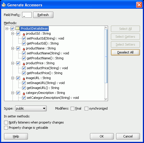

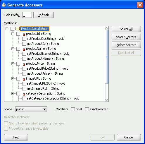

Now that we've set up the fields for the JavaBean, let's generate the accessors.
In the Structure window, right-click ProductDetailsBean and choose Generate Accessors from the context menu.
The Generate Accessors dialog displays (Figure 6-27).
Click Select All to select all the fields you created for this bean (Figure 6-28).
Figure 6-28 Generate Accessors DIalog with all Fields Selected
Click OK to generate the accessors for these fields. Oracle JDeveloper generates the code as shown in Example 6-1:

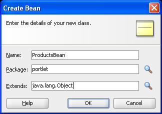

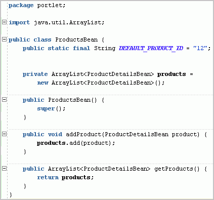

Create another JavaBean for the portlet called ProductsBean.java. This bean represents the list of products, which the portlet will display at runtime.
To create the JavaBean right-click the portlet package in the Application Navigator and choose New from the context menu.
In the New Gallery, click the Java category, then click the Bean item to display the Create Bean dialog.
In the Name field, enter ProductsBean and java.lang.Object in the Extends field, as shown in Figure 6-29, then click OK.
Replace the code of ProductsBean.java in the Source view with the code in Example 6-2.
| Note:If the formatting of the code in this text does not work, you can open the C:\TutorialContent\Portlets\ProductsBeanJava.txtfile and copy and paste the code from there. |
Example 6-2 ProductsBean.java Code
package portlet;
import java.util.ArrayList;
public class ProductsBean {
    public static final String DEFAULT_PRODUCT_ID = "12";
    private ArrayList<ProductDetailsBean> products =
        new ArrayList<ProductDetailsBean>();
    public ProductsBean() {
        super();
    public void addProduct(ProductDetailsBean product) {
        products.add(product);
    public ArrayList<ProductDetailsBean> getProducts() {
        return products;
The Source view of the bean should now look like Figure 6-30.
Save all your files.

In the Application Navigator, right-click the portlet package, then choose New from the context menu.
In the New Gallery, click Java, then choose Java Class from the Items list (Figure 6-31).
Figure 6-31 Choosing the Java Class Option in the New Gallery
Click OK.

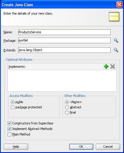

In the Create Java Class dialog, in the Name field, enter the name: ProductsService, as shown in Figure 6-32.
Leave the rest of the default values in this dialog, as we will overwrite them in the next step, then click OK.
In the ProductsService.java file that displays, replace all the automatically-generated code with the code shown in Example 6-3. The code assumes that the database where you installed the sample schema is local. In the code, modify the highlighted JDBC connection (jdbc:oracle:thin:@localhost:1521:xe)to point to your database and Tutorial (fod) schema

Now that we've updated our portlet and created the Java Class to enable the portlet to communicate with the database, let's update our portlet's view.jsp file for the portlet to use the Java class.
In the Application Navigator, under Portlets, Web Content, Products, and html, pen the view.jsp file (Figure 6-33).
Figure 6-33 View.jsp File in the Application Navigator
Click the Source tab to view the code of this page.

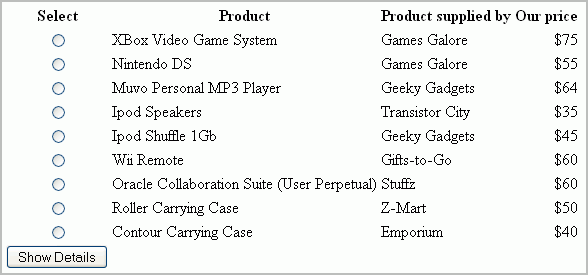

Before we deploy the portlet, let's quickly compile and test it. In the Application Navigator, under Web Content then Products, right-click view.jsp and choose Run. The portlet should compile and display in your browser, as shown in Figure 6-34.
Figure 6-34 Testing the Standards-Based Portlet

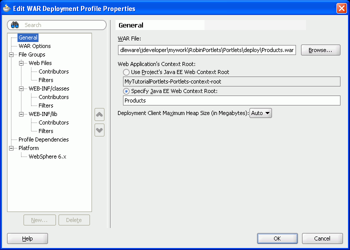

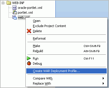

In the Application Navigator, under Portlets, Web Content, WEB-INF, right-click the web.xml file, then choose Create WAR Deployment Profile from the context menu (Figure 6-36).
Figure 6-35 Create WAR Deployment Profile Menu Option

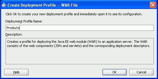

In the Create Deployment Profile dialog, name the Deployment Profile Products, then click OK (Figure 6-36).
Figure 6-36 Create Deployment Profile - WAR File Dialog
On the General tab of the WAR Deployment Profile Properties dialog, look for the Web Application's Context Root setting. Let's change this to a more logical name, so that we can easily reference it later.
Select the Specify J2EE Context Root option, then enter Products in the field, as shown in Figure 6-37.
Figure 6-37 WAR Deployment Profile Properties -- Setting the Context Root
Click OK to finish updating the properties, then click OK in the Project Properties dialog to finish creating the WAR deployment profile.

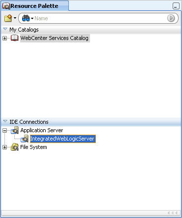

Oracle WebCenter includes its own default connection to the Integrated WLS Server. You can see the connection, called IntegratedWLSConnection, in the Resource Palette, under IDE Connections (Figure 6-38).
Figure 6-38 IntegratedWebLogicServer in the Resource Palette

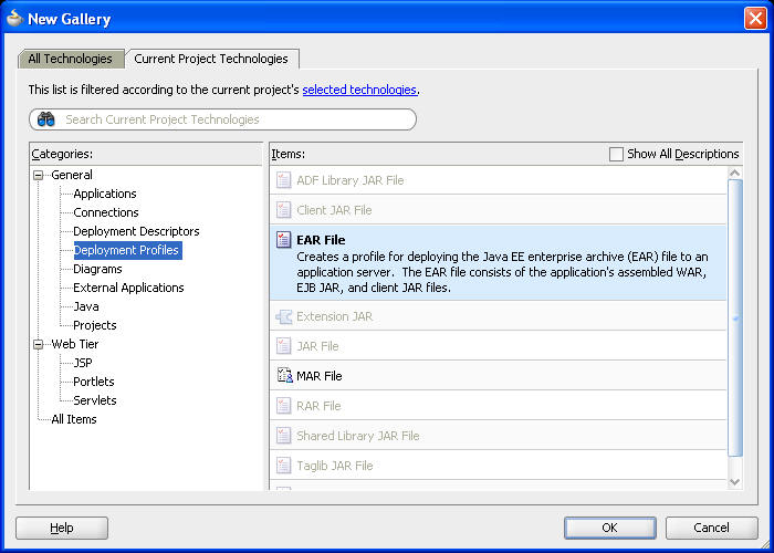

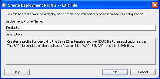

Now, create an EAR file for the Deployment Profile. From the Application menu, choose Deploy, then New Deployment Profile.
In the New Gallery, ensure Deployment Profiles is selected, then choose EAR File from the Items list (Figure 6-39).
Figure 6-39 Creating an EAR File for the Deployment Profile of the Products Portlet
In the Create Deployment Profile -- EAR File dialog, in the Deployment Profile Name field, enter Products (Figure 6-40), then click OK.
Figure 6-40 Creating a Deployment Profile
Click OK, then click OK again.

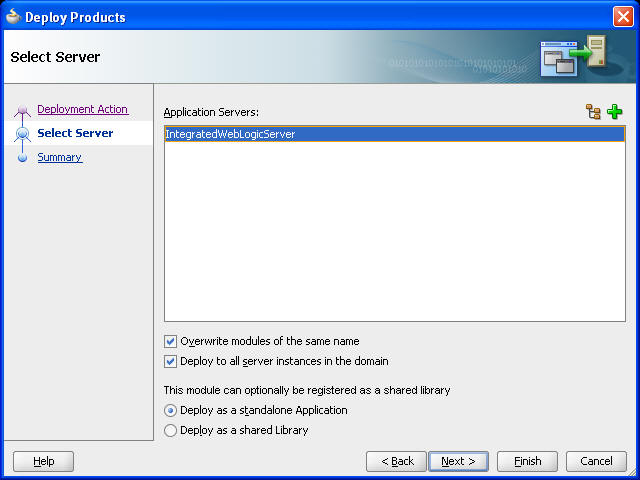

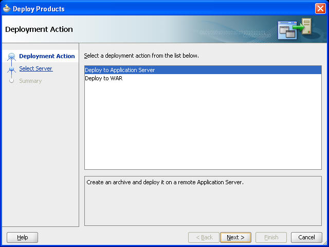

Now, we're ready to deploy our standards-based portlet. In the Application Navigator, right-click the Portlets project, and choose Deploy, then Products from the context menu.
In the Deploy Products wizard, on the Deployment Action page, select Deploy to Application Server, then click Next (Figure 6-41).
Figure 6-41 Deployment Action page of the Deploy Products Wizard
On the Select Server page of the Deploy Products wizard, select IntegratedWebLogicServer, then click Next (Figure 6-42).
Figure 6-42 Select Server Page of the Deploy Products Wizard
On the Summary page, ensure that the Application Server listed is the IntegratedWebLogicServer and that the Archive Details shows the Output file pointing to JDEV_USER_HOME\jdeveloper\mywork\MyTutorialPortlet\Portlets\deploy\Products.war.
Click Finish.

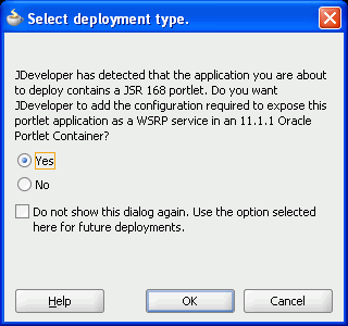

If the Select deployment type dialog displays, leave the default options and click OK (Figure 6-43).

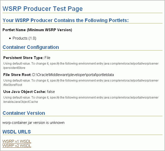

Let's to go a browser and verify whether the portlet deployment worked. In your browser, enter the URL:
http://localhost:7101/Products
The WSRP Producer Test Page displays as shown in Figure 6-44.
You can choose to use either the WSRP version 1 or version 2 WSDL In general, it's good practice to use more recent versions wherever possible. If the portlet will be consumed by WSRP 1.0 compliant consumers (such as Oracle Portal), you may want to choose WSRP 1.0.

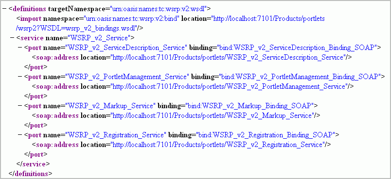

Click WSRP v2 WSDL to view the XML for this WSDL (Figure 6-45).
Figure 6-45 WSDL Describing Your Portlet as a Web Service
The portlet you just deployed has now been exposed as a web service. What appears in the browser is the Web Services Description Language (WSDL) that describes this web service. Now that the portlet is deployed and running, you can add this portlet to any application that can consume portlets. Our next step is to register the producer with our Tutorial application, then add this portlet to MyPage.

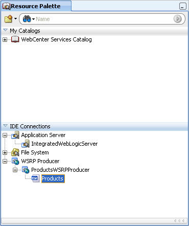

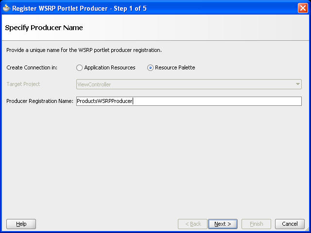

Once we have deployed our portlet, we can register the producer with our Tutorial application and add it to our page.
To register the producer with MyTutorialApplication:
In the Application Navigator, choose MyTutorialApplication from the list to return to our custom WebCenter application (Figure 6-46).
Figure 6-46 MyTutorialApplication in the Application Navigator List

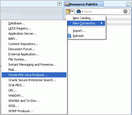

In the Resource Palette, click the folder icon, then choose New Connection and WSRP Producer from the context menu.
On the Name page, ensure Resource Palette is selected, and enter a name for the producer, for example ProductsWSRPProducer, then click Next (Figure 6-47).
Figure 6-47 Register WSRP Portlet Producer -- Name

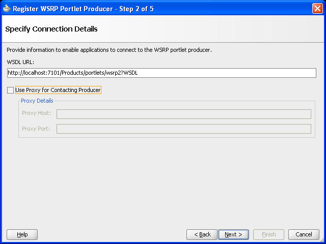

On the Connection page, in the WSDL URL field, enter the URL for the WSDL (typically, we use v.2):
http://localhost:7101/Products/portlets/wsrp2?WSDL
Figure 6-48 Register WSRP Portlet Producer -- Connection
Since our Integrated WebLogic Server is installed locally, we do not need a proxy. Click Next to create the connection to the WSRP Producer.
Let's leave the rest of the defaults and finish the wizard. On the Registration Details page, click Finish. You'll see a registration dialog letting you know the registration is being completed.
In the Resource Palette, under IDE Connections, open the WSRP Producer node, then expand the ProductsWSRPProducer node. Figure 6-49 shows the Products portlet here.
Figure 6-49 Products Portlet in the Resource Palette
Now that we've registered the producer with our application, let's add the portlet to the page and test it.

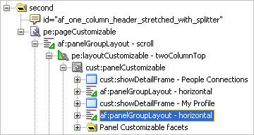

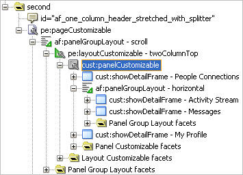

In the Structure window, navigate to the second facet, then expand Page Customizable, Panel Group Layout, Layout Customizable, and Panel Customizable, as shown in Figure 6-50. You should see the Show Detail Frame called My Profile. You will add the portlets below this component.
| Note:As previously mentioned, you can use the pushpin in the Structure window to freeze the current view. For this step, you should click MyPage in the Design view, then ensure the pushpin is in the "freeze" position (pressed). |
Figure 6-50 Panel Customizable Where You Will Add the Products Portlet
In the Component Palette, choose ADF Faces from the list.
Drag and drop a Panel Group Layout just below the Show Detail Frame called My Profile.
Set the Layout property to horizontal and the StyleClass (located below Style and Theme) to AFStretchWidth. Figure 6-51 shows the new Panel Group Layout in the Structure Window.
Drag and drop the Products portlet from the Resource Palette onto this Panel Group Layout.
Run the page to see how the portlet looks at runtime. This may take a few moments.
You will notice that selecting the different options and the Show Details button do not yet work, because we have not wired this portlet with another portlet. Let's create a second portlet, then wire it to this portlet. Figure 6-52 shows the Products portlet at runtime.
Figure 6-52 Products Portlet in a Browser Window

To find out the URL for the OmniPortlet producer running on the Integrated WebLogic Server, choose WebCenter Preconfigured Server Readme from the Help menu. This Read Me file shows all the information needed to use the portlets that are predeployed to the Integrated WebLogic Server, and the login credentials for the server.
In the Read Me file, under Preconfigured Portlet Producers, then PortalTools Portlet Producers, click OmniPortlet Producer.

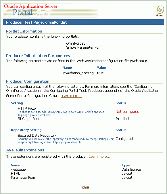

In your browser, you should see the OmniPortlet Producer Test Page. Copy the URL from the location bar. The URL should look like this:
http://127.0.0.1:7101/portalTools/omniPortlet/providers/omniPortlet
Entering this URL in your browser displays the OmniPortlet producer test page (Figure 6-53).
Figure 6-53 OmniPortlet Producer Test Page

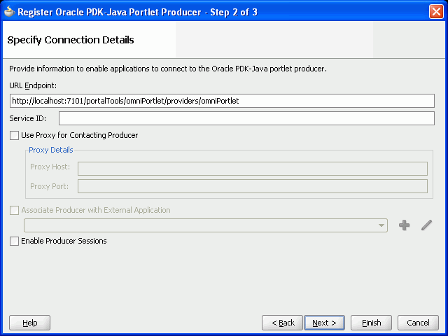

In the Resource Palette, click the New icon next to the search toolbar, then choose New Connection, and then Oracle PDK-Java Producer (Figure 6-54).
Figure 6-54 Registering an Oracle PDK-Java Producer

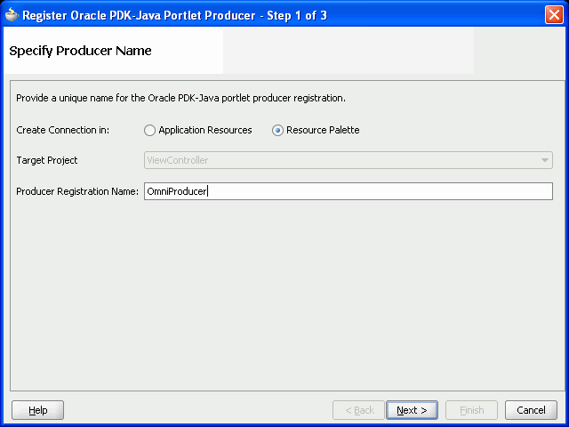

On Step 1 of the Register Oracle PDK-Java Portlet Producer wizard, let's enable this portlet producer to be used across all our applications. Select Resource Palette.
In the Name field, enter OmniProducer (Figure 6-55).
Figure 6-55 Naming the OmniPortlet Producer
Click Next.
Enter this URL for the OmniPortlet Producer Test Page, which you copied earlier in the URL Endpoint field (Figure 6-56).
Figure 6-56 Specifying the Connection Details for the OmniPortlet Producer
Click Next.
On the Registration Details page, click Finish. You should see a message indicating that Oracle JDeveloper is registering your producer.

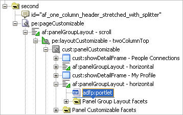

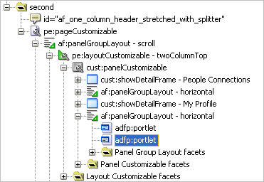

In the Structure window, locate the horizontal Panel Group Layout where you added the Products portlet.
Figure 6-59 Panel Group Layout Containing the Products Portlet

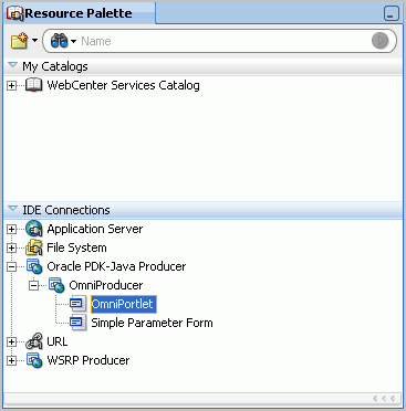

In the Resource Palette, under IDE Connections, navigate to Oracle PDK-Java Producer, OmniProducer, and OmniPortlet (Figure 6-60).
Figure 6-60 OmniPortlet in the Resource Palette
Drag and drop OmniPortlet onto your page onto the Panel Group Layout. It should display below the existing adfp:portlet in the Structure window. If you see an error message, ensure you have started the Integrated WebLogic Server, then try again.

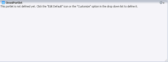

Run your page to the browser and log in as Lisa/welcome1.
Figure 6-61 shows the OmniPortlet on MyPage in your browser.
Figure 6-61 Undefined OmniPortlet at Runtime

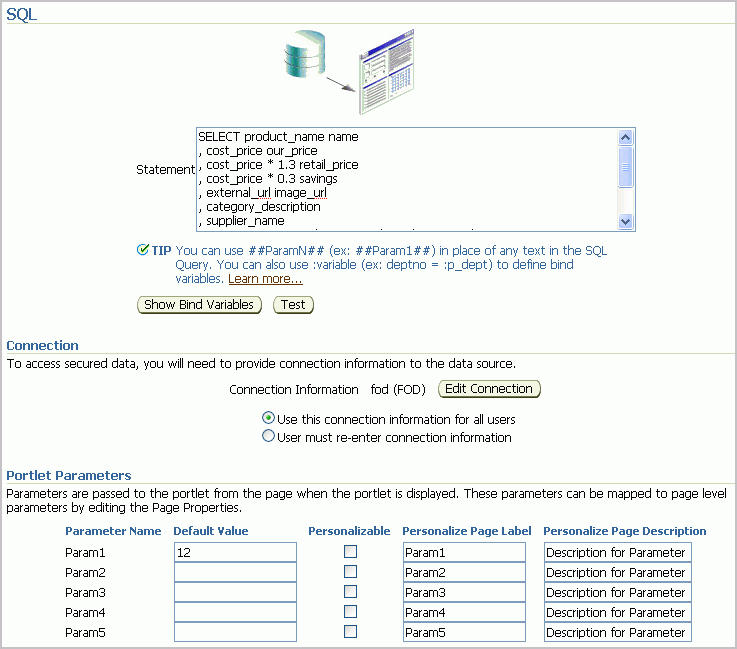

On the Data Type page, choose SQL so that we can obtain data from the schema in a database, then click Next. At this point, be sure you've added the schema to your database (as described in Chapter 2, "Preparing for the Tutorial") and the images to your application resources (as described in Chapter 3, "Creating a WebCenter Application with a Customizable Page") otherwise the portlet will not retrieve the sample Tutorial data.
If you're familiar with SQL and your database, you can always use your own sample data, but the ensuing images and steps may not necessarily be accurate for you.
On the Data Source page, we can define our SQL statement and set up the connection to the database where we installed the schema.
In the Statement box, enter the code in Example 6-7. The parameter in the statement will be used when we wire this portlet with the Products portlet we added in Step 5: Register the Standards-Based Portlet with Your Application.
| Note:If the formatting of the code in this text does not work, you can open the C:\TutorialContent\Portlets\OmniPortlet_SQL_Statement.txtfile and copy and paste the code from there. |
Example 6-7 OmniPortlet SQL Statement
SELECT distinct  product_name name
, cost_price our_price
, cost_price * 1.3 retail_price
, cost_price * 0.3 savings
, external_url image_url
, category_description
, supplier_name
FROM category_translations, products_base, suppliers
WHERE products_base.category_id = category_translations.category_id
  AND products_base.supplier_id = suppliers.supplier_id
  AND products_base.product_id = nvl('##Param1##', 0)
| Note:In the statement, you'll notice a reference to the localhost. This refers to the OmniPortlet producer you registered; localhost also points to the IP address 127.0.0.1. Notice that you can also click the Test button to see what the statement will return. |

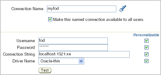

Under Connection, click Edit Connection.
Enter a name for your connection and the connection information for your database. The schema username is fod and the password is fusion. For example, if you are using an Oracle XE database locally, the page would look like Figure 6-63.
Figure 6-63 Connection Information for OmniPortlet

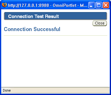

Let's make sure the connection information is correct by clicking Test. Figure 6-64 shows a successful test message.
Figure 6-64 Successful Connection Message
Click Close, then click OK to finish creating the connection.
Under Portlet Parameters, set the Default Value for Param1 to 12. Doing so provides a default value for the parameter in our SQL statement.
Figure 6-65 shows the SQL Source page.
| Note:If you do not have the imagesfolder in your ViewController project as described in Chapter 3, "Creating a WebCenter Application with a Customizable Page," the images referenced in the SQL statement will not display. You can go back and add these now by following Step 2: Add the Resource Files to the Application, but you must run the application to your browser again in order for OmniPortlet to recognize the new folder. |

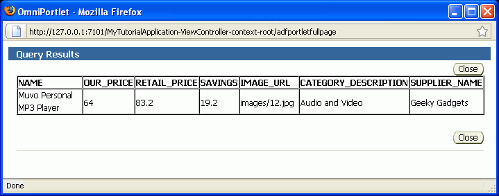

Click Test next to the Show Bind Variables button to validate the SQL statement and connection.
A pop-up window displays returning a row based on the statement. If you do not see a row returned, validate your SQL statement, connection, and portlet parameter.

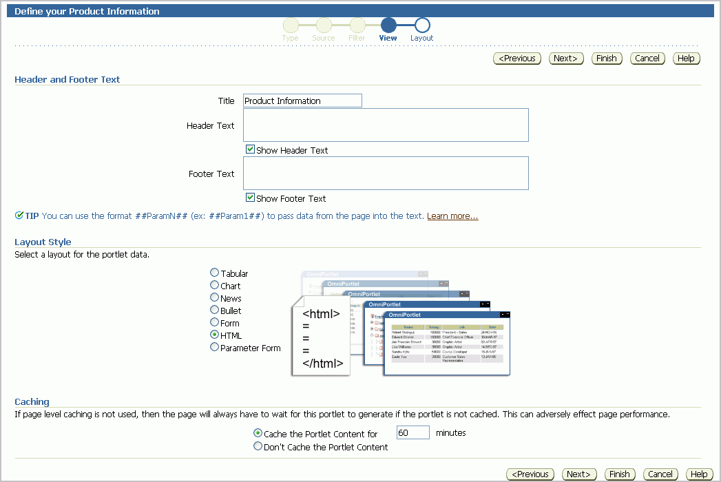

On the View page, let's name the portlet, for example Product Information, by entering the name in the Title field.

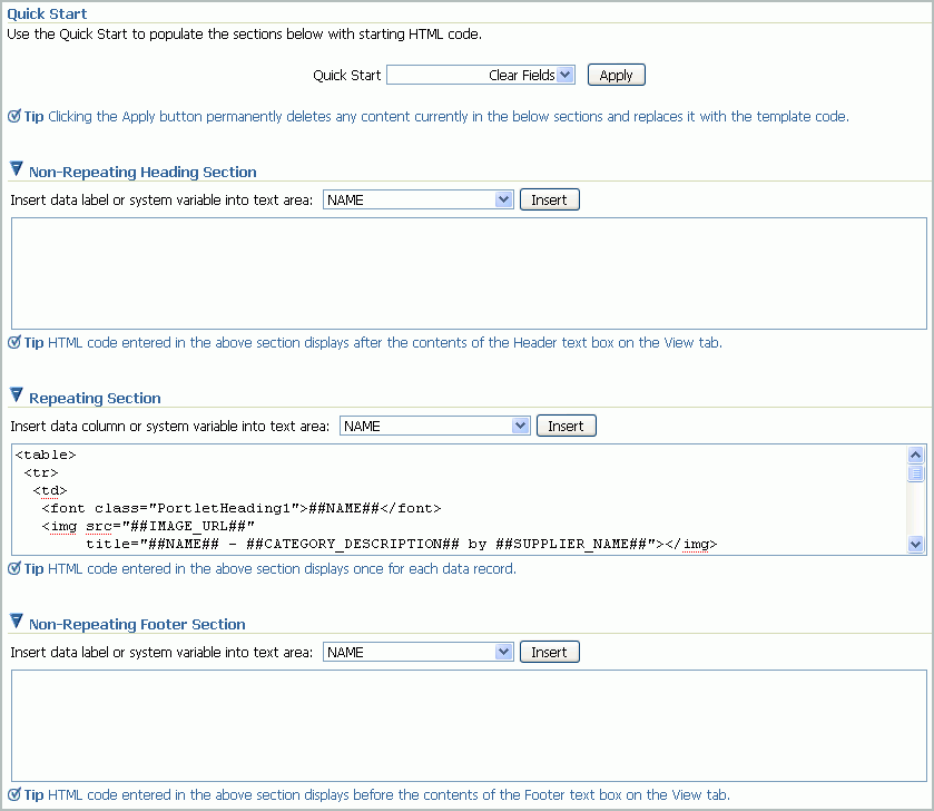

We can choose any of the default layouts for this portlet. However, let's check out the HTML layout, which you can use to fine tune the look and feel of your portlet.
Under Layout Style, select HTML, as shown in Figure 6-68, then click Next.
On the Layout page, you'll notice a form for filling in HTML for the template. Here, you can modify the layout of your portlet by updating the Header, Body, and Footer fields. You can use the default layout that OmniPortlet provides, but let's step through creating our own HTML layout.
From the Quick Start list, select Clear Fields, then click Apply. Doing so removes the existing HTML code from the layout template.
In the Repeating Section, enter the HTML in Example 6-8 to create a table that formats the data.
| Note:If the formatting of the code in this text does not work, you can open the C:\TutorialContent\Portlets\OmniPortlet_HTML_Layout.txtfile and copy and paste the code from there. |
Example 6-8 OmniPortlet HTML Layout Code
<table>
 <tr>
  <td>
   <font class="PortletHeading1">##NAME##</font>
   <img src="##IMAGE_URL##"
        title="##NAME## - ##CATEGORY_DESCRIPTION## by ##SUPPLIER_NAME##"></img>
  </td>
  <td>
   <table>
    <tr class="PortletText2">
     <td>
      Product supplied by
      <font class="PortletHeading3">
       ##SUPPLIER_NAME##
      </font>
     </td>
    </tr>
     <td>
      List price: $##RETAIL_PRICE##
     </td>
    </tr>
    <tr class="PortletHeading2">
     <td>
      Our price: $##OUR_PRICE##
     </td>
    </tr>
     <td>
      You save: $##SAVINGS##
     </td>
    </tr>
     <td>
      <font class="PortletHeading2">Availability:</font>
      In Stock. Ships from and sold by
      <font class="PortletHeading2">FusionOnline.com</font>
      . Gift-wrap available.
     </td>
    </tr>
    <tr>
     <td> </td>
    </tr>
   </table>
  </td>
 </tr>
 <tr class="PortletText1">
  <td colspan="2">Want it delivered Thursday? Order it in the next 22 hours and
                  45 minutes, and choose One-Day Shipping at checkout.</td>
 </tr>
</table>
The Layout page should now look like Figure 6-69.
Click Finish. Figure 6-70 shows the OmniPortlet in your browser.
Figure 6-70 Completed OmniPortlet at Runtime
Now that we have created our two portlets, let's wire them.
When you added the code for the standards-based portlet called Products, you also included a parameter called productId. When you select different options in the Products portlet, the application will send this parameter to OmniPortlet so that it can display the details of a particular product with that product identification number.
We now must map the two parameters to each other, so that when you choose an option in the Products portlet, the information in OmniPortlet updates accordingly.
To wire the portlets:

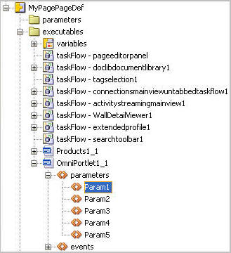

In the Application Navigator, open the page definition file for the MyPage.jspx page. You can do this by opening the page definition file itself in the Application Navigator, or by right-clicking the page and choosing Go to Page Definition. You created the page definition for MyPage in "Step 3: Add ADF Security Policies to Your Application" in Chapter 4, "Adding Security to Your Application."
In the Structure window, use the pushpin to freeze the current view. Ensure the MyPage Page Definition is selected in the Design view, then, in the Structure window, click the pushpin so that it is in the "freeze" position (pressed).
In the Structure window for the MyPagePageDef.xml (page definition) file, expand executables, expand OmniPortlet1_1 then parameters, then select the portlet variable Param1, as shown in Figure 6-71.
Figure 6-71 OmniPortlet Variable in the Structure Window
While the variable is selected, you should be able to view the properties for it in the Property Inspector.
Set the pageVariable property to Products1_1_productId, as shown in Figure 6-72.

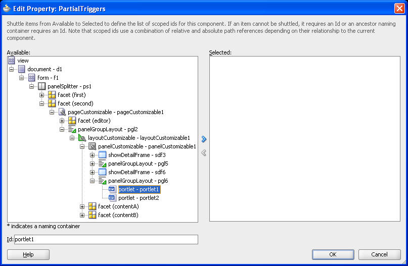

Now we want the detail portlet (OmniPortlet) to refresh whenever the value from the master portlet changes. To do so, we add a Partial Trigger to the detail portlet. Click the MyPage.jspx tab at the top of the Visual Editor to bring it into focus.

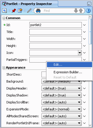

Select the OmniPortlet on the page in the Structure window. The portlet is the second instance of adfp:portlet in the Panel Group Layout, as shown in Figure 6-73.
Figure 6-73 OmniPortlet on MyPage in the Design View

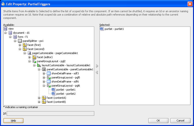

In the Property Inspector for OmniPortlet, under Common, click the arrow next to PartialTriggers, then choose Edit (Figure 6-74).
Figure 6-74 Editing the PartialTriggers Property for OmniPortlet
In the Edit Property: PartialTriggers dialog, the Portlet ID for OmniPortlet (portlet - portlet2) is automatically selected. Locate the Portlet ID for the Products portlet, which is directly above the OmniPortlet (Figure 6-75).
Figure 6-75 Locating the Portlet ID for the Products Portlet
Select the Portlet ID, in this case portlet - portlet1, and click the right arrow to move it to the Selected list, then click OK (Figure 6-76).
Figure 6-76 Selecting the Portlet ID for the Products Portlet

In the Products portlet, select an option, for example iPod Speakers, then click Show Details.
In the OmniPortlet, notice that the portlet updates to display information about the iPod speakers (Figure 6-77).
Figure 6-77 Testing the Interaction Between the Portlets
