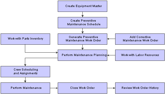

JD Edwards EnterpriseOne Capital Asset Management Business Processes
This diagram illustrates the JD Edwards EnterpriseOne CAM business process flow:
Process flow for Capital Asset Management
