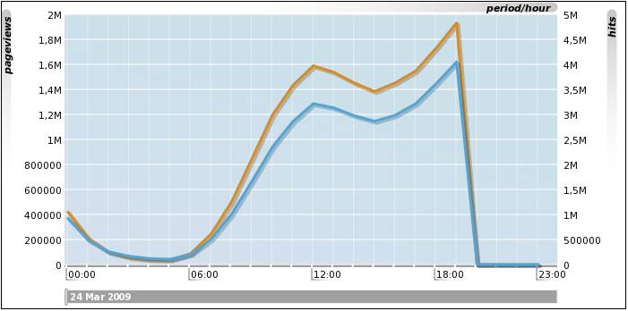

When monitoring very high levels of traffic, it can appear from the reported data that RUEI is no longer monitoring network traffic or it is delayed. An example of this is shown in Figure C-1.
Figure C-1 Drop in Reported Network Traffic
This report appears to show that network traffic stopped being monitored at 19:00. In fact, this situation is the result of an overloaded RUEI system. While traffic continues to be monitored, the generated Collector log files cannot be processed due to extremely high traffic levels and insufficient resources.
This can be confirmed by selecting System, then Maintenance, then Data processing, and then click the Performance tab. If the reported system load is approaching 100%, then the system is becoming overloaded. The use of this facility is fully described in Section 9.7, "Viewing a Traffic Summary".
As a safeguard against permanently overloaded systems, RUEI automatically stops processing all Collector log files for the previous day approximately 30 minutes after midnight. This enables any backlog to be discarded, and for RUEI to return normal processing levels.
If the situation shown in Figure C-1 persists, it is strongly recommended that you use network filters to limit the level of monitored traffic. This is fully explained in Section 8.2.2, "Limiting Overall Traffic". You might also consider assigning more resources to the RUEI system.
