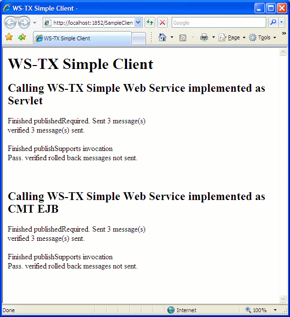

- Deploy and Run the client.
Right-click SampleClient and select Run Project. NetBeans will start domain2, deploy the servlet and EJB CMT clients to that domain, then display the results for both in a pop-up browser window, as shown in Figure 11-4.
Figure 11-4basicWSTX
Results
