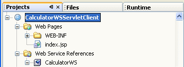

in the Package field, and click Finish. The Projects window displays the new web service client, as shown in Figure 2-3.
