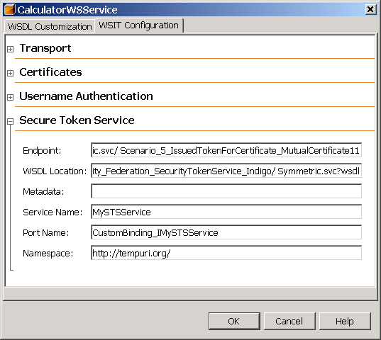

The Endpoint field is a mandatory field. Depending on how you plan to configure the STS, you can provide either Metadata information or information regarding the WSDL Location, Service Name, Port Name and Namespace. The following section contain a few example STS configurations. When the options are configured along the lines of STS Example 2: Endpoint with WSDL Location, Service Name, Port Name, and Namespace, the dialog looks like this:
Figure 6-9 WSIT Configuration Page - Secure Token Service on Client
- Endpoint:
http://131.107.72.15/Security_Federation_SecurityTokenService_Indigo/
Symmetric.svc/
Scenario_5_IssuedTokenForCertificate_MutualCertificate11- WSDL Location:
http://131.107.72.15//Security_Federation_SecurityTokenService_Indigo/
Symmetric.svc?wsdl- Service Name:
MySTSService
- Port Name:
CustomBinding_IMySTSService
- Namespace:
http://tempuri.org/
