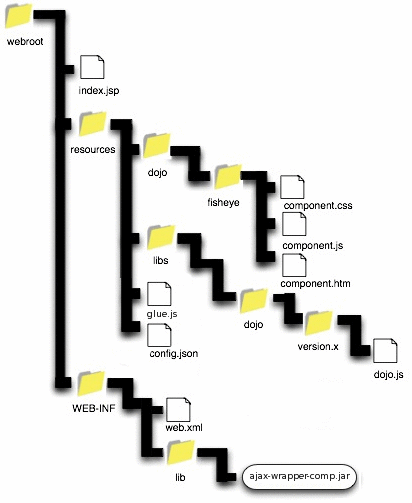

A jMaki application that includes a Dojo fisheye widget has the basic structure shown in the following figure, which illustrates where the various required resources fit into the application. As shown in Figure 3-1, the libs folder contains the third-party Dojo widget implementation code. NOT ANY MORE
Figure 3-1 Structure of a jMaki Application

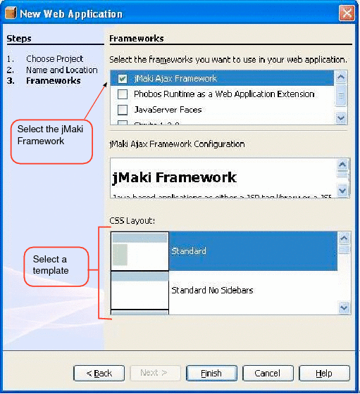

Figure 3-2 shows a screen from the New Web Application wizard, which you start by selecting New Project from the File menu and choosing Web Application from the New Project wizard.
Figure 3-2 The New Web Application Wizard
As shown in the preceding figure, to create a jMaki web application, you need to select the jMaki Ajax framework and select a template for the first page of your application.

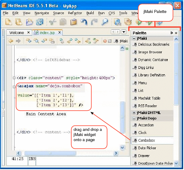

Once you've created your page, it's easy to drag a widget from the jMaki palette included with the module onto the page. Figure 3-3 shows how you can drag and drop a widget from the jMaki palette onto a JSP page.
Figure 3-3 Dragging and Dropping a Widget onto a Page
