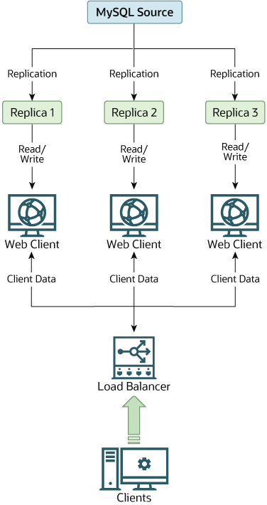

Replication in this situation enables you to distribute the reads over the replicas, while still enabling your web servers to communicate with the source when a write is required. You can see a sample replication layout for this scenario in Figure 19.1, “Using Replication to Improve Performance During Scale-Out”.
Figure 19.1 Using Replication to Improve Performance During Scale-Out
Incoming requests from clients are directed to a load balancer, which distributes client data among a number of web clients. Writes made by web clients are directed to a single MySQL source server, and reads made by web clients are directed to one of three MySQL replica servers. Replication takes place from the MySQL source server to the three MySQL replica servers.
