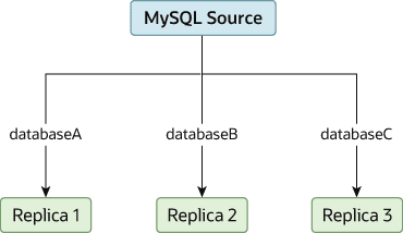

There may be situations where you have a single source server and want to replicate different databases to different replicas. For example, you may want to distribute different sales data to different departments to help spread the load during data analysis. A sample of this layout is shown in Figure 19.2, “Replicating Databases to Separate Replicas”.
You can achieve this separation by configuring the source and
replicas as normal, and then limiting the binary log statements
that each replica processes by using the
--replicate-wild-do-table
configuration option on each replica.
You should not use
--replicate-do-db
for this
purpose when using statement-based replication, since
statement-based replication causes this option's effects to
vary according to the database that is currently selected. This
applies to mixed-format replication as well, since this enables
some updates to be replicated using the statement-based format.
However, it should be safe to use
--replicate-do-db
for this
purpose if you are using row-based replication only, since in
this case the currently selected database has no effect on the
option's operation.
For example, to support the separation as shown in
Figure 19.2, “Replicating Databases to Separate Replicas”, you should
configure each replica as follows, before executing
START REPLICA
Replica 1 should use
--replicate-wild-do-table=databaseA.%
Replica 2 should use
--replicate-wild-do-table=databaseB.%
Replica 3 should use
--replicate-wild-do-table=databaseC.%
Each replica in this configuration receives the entire binary log
from the source, but executes only those events from the binary
log that apply to the databases and tables included by the
option in
effect on that replica.
