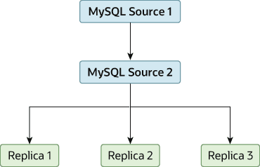

One way to improve the performance of the replication process is to create a deeper replication structure that enables the source to replicate to only one replica, and for the remaining replicas to connect to this primary replica for their individual replication requirements. A sample of this structure is shown in Figure 19.3, “Using an Additional Replication Source to Improve Performance”.

Source 1 is the primary source where all changes and updates are written to the database. Binary logging is enabled on both source servers, which is the default.
Source 2 is the replica to the server Source 1 that provides
the replication functionality to the remainder of the replicas
in the replication structure. Source 2 is the only machine
permitted to connect to Source 1. Source 2 has the
--log-replica-updates
option
enabled (the default). With this option, replication
instructions from Source 1 are also written to Source 2's
binary log so that they can then be replicated to the true
replicas.
Replica 1, Replica 2, and Replica 3 act as replicas to Source 2, and replicate the information from Source 2, which actually consists of the upgrades logged on Source 1.
The above solution reduces the client load and the network interface load on the primary source, which should improve the overall performance of the primary source when used as a direct database solution.
