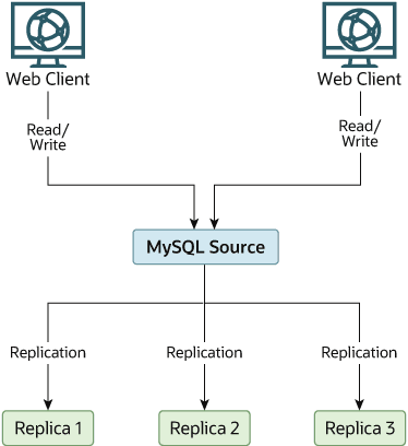

Replicas should be run with binary logging enabled (the --log-bin option), which is the default. If you are not using GTIDs for replication, then the replicas should also be run with --log-replica-updates=OFF (logging replica updates is the default). In this way, the replica is ready to become a source without restarting the replica mysqld. Assume that you have the structure shown in Figure 19.4, “Redundancy Using Replication, Initial Structure”.
Figure 19.4 Redundancy Using Replication, Initial Structure
Two web clients direct both database reads and database writes to a single MySQL source server. The MySQL source server replicates to Replica 1, Replica 2, and Replica 3.
In this diagram, the Source holds the source database, the Replica* hosts are replicas, and the Web Client machines are issuing database reads and writes. Web clients that issue only reads (and would normally be connected to the replicas) are not shown, as they do not need to switch to a new server in the event of failure. For a more detailed example of a read/write scale-out replication structure, see Section 19.4.5, “Using Replication for Scale-Out”.
Each MySQL replica (Replica 1, Replica 2, and Replica 3) is a replica running with binary logging enabled, and with --log-replica-updates=OFF. Because updates received by a replica from the source are not written to the binary log when --log-replica-updates=OFF is specified, the binary log on each replica is initially empty. If for some reason Source becomes unavailable, you can pick one of the replicas to become the new source. For example, if you pick Replica 1, all Web Clients should be redirected to Replica 1, which writes the updates to its binary log. Replica 2 and Replica 3 should then replicate from Replica 1.

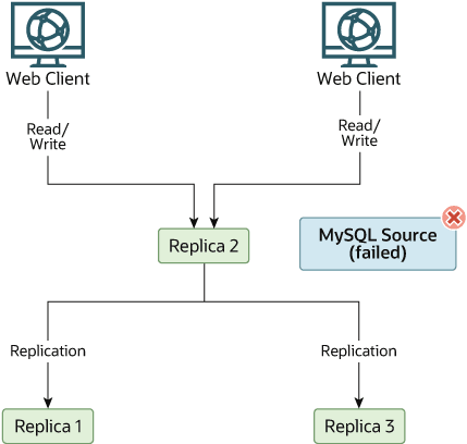

Once the new replication setup is in place, you need to tell each Web Client to direct its statements to Replica 1. From that point on, all updates sent by Web Client to Replica 1 are written to the binary log of Replica 1, which then contains every update sent to Replica 1 since Source became unavailable.
The resulting server structure is shown in Figure 19.5, “Redundancy Using Replication, After Source Failure”.
Figure 19.5 Redundancy Using Replication, After Source Failure
The MySQL source server has failed, and is no longer connected into the replication topology. The two web clients now direct both database reads and database writes to Replica 1, which is the new source. Replica 1 replicates to Replica 2 and Replica 3.
