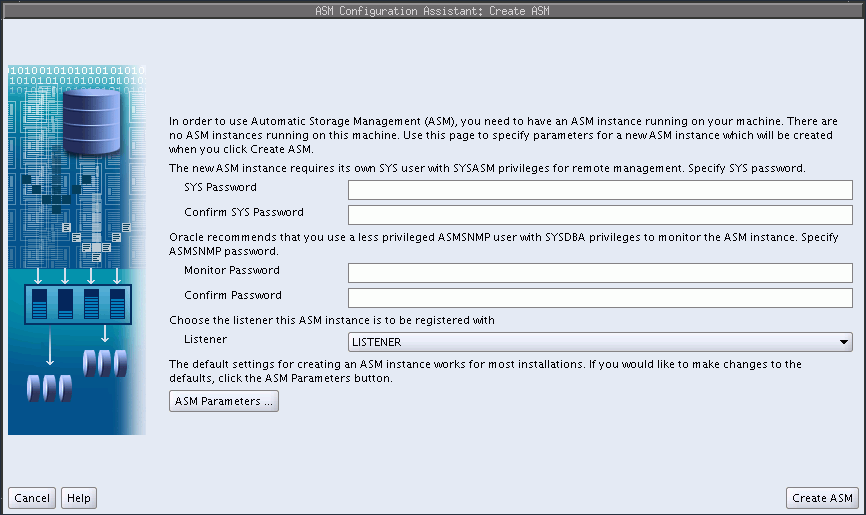

Oracle ASM Configuration Assistant enables you to create an Oracle ASM instance if an Oracle ASM instance is not found on the host, as shown in Figure 11-1.
On the Create ASM page, you enter the SYS password for the administrator of the Oracle ASM instance and the password for the ASMSNMP user that can monitor this Oracle ASM instance. Note that ASMSNMP is a less privileged user that is primarily used by Oracle Enterprise Manager to monitor Oracle ASM instances.
See Also:
Oracle Grid Infrastructure Installation Guide for information about installing Oracle ASM
Oracle Database Installation Guide for information about reviewing database accounts and passwords
You can select the listener with which you want to register this Oracle ASM instance. Click ASM Parameters to update the initialization parameters for the Oracle ASM instance.
Figure 11-1 Oracle ASM Configuration Assistant Create ASM Page

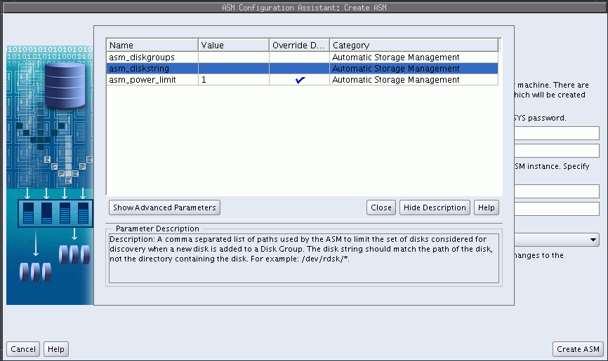

When you can click ASM Parameters in the Create ASM page, you can update initialization parameters for an Oracle ASM instance on the Oracle ASM Configuration Assistant page, as shown in Figure 11-2.
For information about Oracle ASM instance initialization parameters, see "Configuring Initialization Parameters for Oracle ASM Instances".

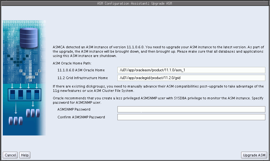

Run ASMCA from the Oracle Grid Infrastructure home to complete the upgrade.
For information about starting ASMCA, see "Starting Oracle ASM Configuration Assistant". If the Oracle ASM instance has been shut down during the Oracle Grid Infrastructure configuration, start that instance when ASMCA prompts you to start that instance.
When ASMCA detects an earlier version of Oracle ASM, the assistant automatically determines the location of that instance and the location of the Oracle Grid Infrastructure home, as shown in Figure 11-3.
Enter a password for the ASMSNMP user. Note that ASMSNMP is a less privileged user that is primarily used by Oracle Enterprise Manager to monitor Oracle ASM instances.
When you have completed the page, select Upgrade ASM to complete the upgrade. After the process has completed, you can exit from ASMCA.
When upgrading an Oracle ASM instance to the current software level, ASMCA moves the Oracle ASM instance pre-11g Release 2 (11.2) to the Oracle Grid Infrastructure home and updates the appropriate environmental variables.

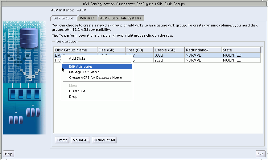

Oracle ASM Configuration Assistant enables you to configure or create Oracle ASM disk groups with the Configure ASM Disk Groups tab, as shown in Figure 11-4. The disk group tab displays selected details about the disk group, such as name, size, free space, usable space, redundancy level, and state of the disk group.
See Also:
Oracle Database Reference for descriptions of disk group information displayed in theV$ASM_DISKGROUP viewYou can right click a selected disk group in the screen to display the configuration options menu. The menu options enable you to:
Add disks to the disk group
Edit the disk group attributes
Manage templates for the disk group
Create an Oracle ACFS file system on the disk group for a database home
Dismount and mount the disk group
Drop the disk group
Figure 11-4 Oracle ASM Configuration Assistant Configure Disk Groups Page
There are additional options for creating a disk group, mounting all disk groups, and dismounting all disk groups.

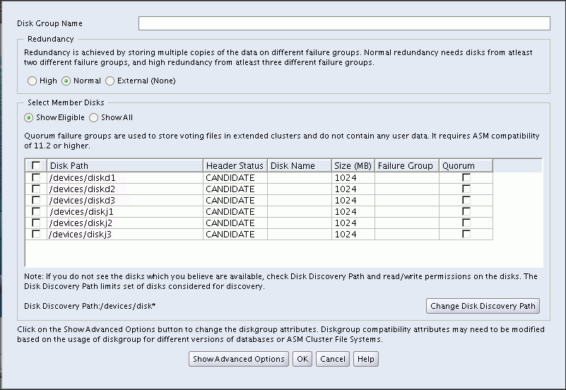

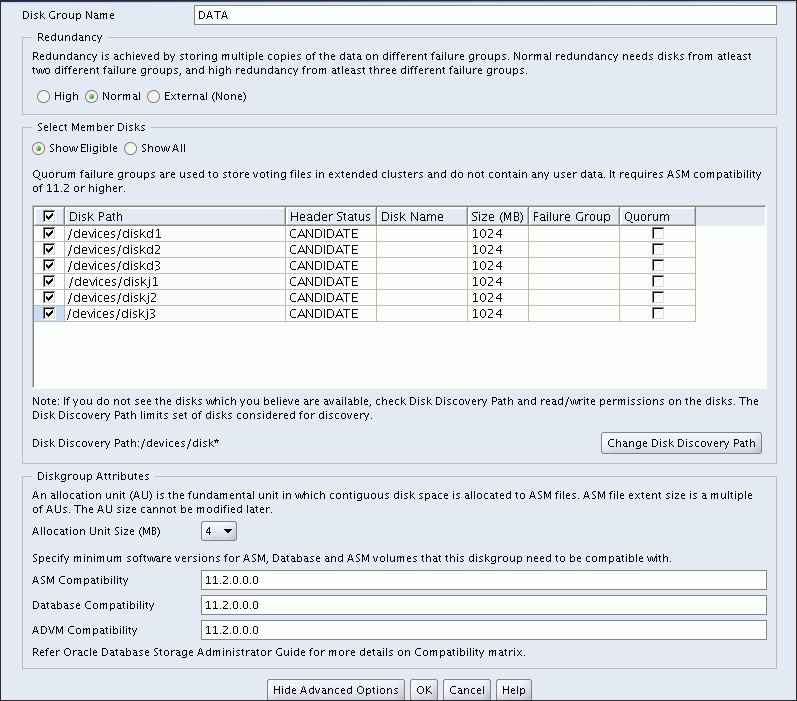

Oracle ASM Configuration Assistant enables you to create an Oracle ASM disk group by clicking Create on the Oracle ASM Configuration Assistant disk group page. The page for creating a disk group is shown in Figure 11-5.
Figure 11-5 Oracle ASM Configuration Assistant Create Disk Groups Page
On this page, you can enter a name for the disk group, select the redundancy level, change the disk discovery path to locate disks in a different directory, identify the disks that you want to be in the disk group, enter a name for a failure group, and specify if the failure group is a quorum type. A quorum failure group is a special type of failure group and disks in these failure groups do not contain user data and a quorum failure group is not considered when determining redundancy requirements with respect to user storage. However, a quorum failure group counts when mounting a disk group. For information about quorum failure groups, see "Oracle Cluster Registry and Voting Files in Oracle ASM Disk Groups".
The default disk group compatibility settings are 11.2 for Oracle ASM compatibility, 10.1 for database compatibility, and no value for Oracle ADVM compatibility. For information about disk group compatibility attributes, see "Disk Group Compatibility". For information about disk discovery, see "Oracle ASM Disk Discovery" and "ASM_DISKSTRING".
You can choose to show advanced options when creating a disk group, as shown in Figure 11-6. The advanced options page enables you to set additional options, such as disk group compatibility settings and allocation unit (AU) size. When you are finished with the create disk group specifications, click OK.
The disk group compatibility settings can only be advanced. You cannot revert to a lower compatibility setting after you advance the disk group compatibility settings. See "Overview of Disk Group Compatibility"Figure 11-6 Oracle ASM Configuration Assistant Create Disk Groups Page - Advanced Options

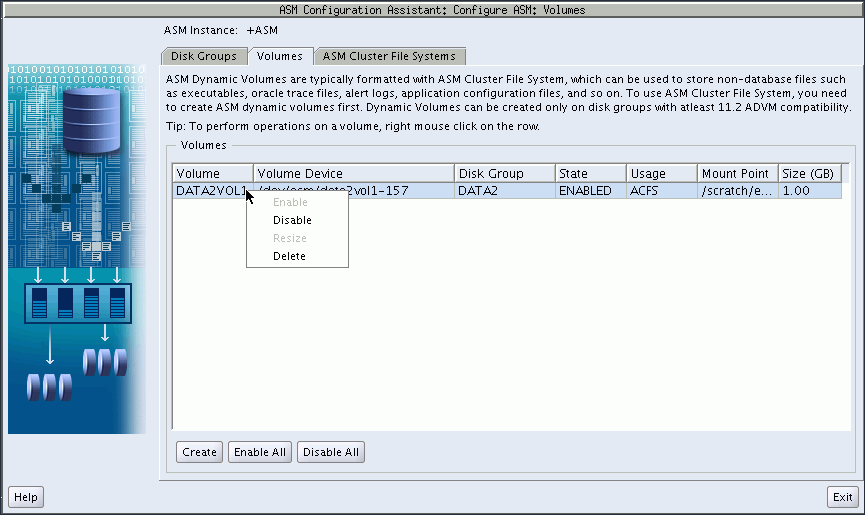

Oracle ASM Configuration Assistant enables you to create or configure an Oracle ADVM volume, as shown in Figure 11-7.
Right click a selected volume in the Oracle ASM Configuration Assistant screen to display the configuration options menu. The menu options include:
Enable a disabled volume
Disable an enabled volume
Resize a volume that has not been mounted on an Oracle ACFS file system
Delete a volume
There are options for creating a volume, enabling all volumes, and disabling all volumes.

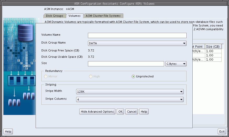

Oracle ASM Configuration Assistant enables you to create Oracle ADVM volumes, as shown in Figure 11-7.
Click Create to create a volume. You must provide a unique volume name for the existing Oracle ASM disk group that you select from the list. The volume name can be a maximum of 11 alphanumeric characters; dashes are not allowed. The first character must be alphabetic.
Specify the size for the volume. You can optionally choose to display advanced options for creating a volume which enables you to specify the redundancy level and striping characteristics.
The compatibility parameters COMPATIBLE.ASM and COMPATIBLE.ADVM must be set to 11.2 or higher for the disk group to contain an Oracle ADVM volume. To use Oracle ACFS encryption, replication, security, or tagging, the disk group on which the volume is created for the file system must have compatibility attributes for ASM and ADVM set to 11.2.0.2 . See "Disk Group Compatibility Attributes".
Before creating an Oracle ADVM volume on AIX, ensure that the necessary user authorizations have been created. For information, refer to "Oracle ACFS Command-line Tools for the AIX Environment".
Figure 11-8 Oracle ASM Configuration Assistant Create an ASM Volume Page

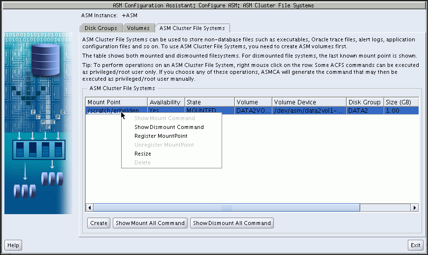

Oracle ASM Configuration Assistant enables you to create or configure an Oracle ACFS file system, as shown in Figure 11-9.
To configure an existing file system, right click a selected file system in the Oracle ASM Configuration Assistant screen to display the configuration options menu.
Show mount command for the file system
Show dismount command for the file system
Register mount point for the file system
Deregister mount point for the file system
Resize the file system
Delete the file system
Some commands require root privileges, such as mounting a file system. Oracle ASM Configuration Assistant generates the command for you to run manually as root or as a privileged user.
There are buttons for Create, Show Mount All, and Show Dismount All commands.

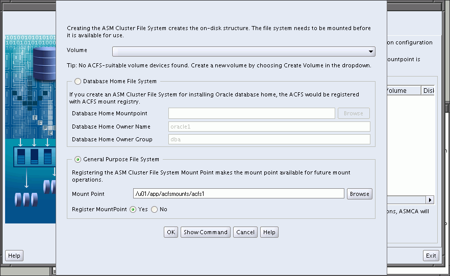

Oracle ASM Configuration Assistant enables you to create an Oracle ACFS file system, as shown in Figure 11-9.
Select Create, then select an existing Oracle ADVM volume from the list and determine the mount point field, show in Figure 11-10. The mount point must be an existing directory. The file system must be mounted to make it available. The mount command must be manually run as root or the Windows Administrator at an operating system prompt. For information about mounting an Oracle ACFS file system, see "mount" for Linux or "acfsmountvol" for Windows.
You can also choose to create an Oracle ACFS file system for an Oracle Database. For more information about creating a file system for a database home, see "Creating an Oracle ACFS File System for a Database Home".

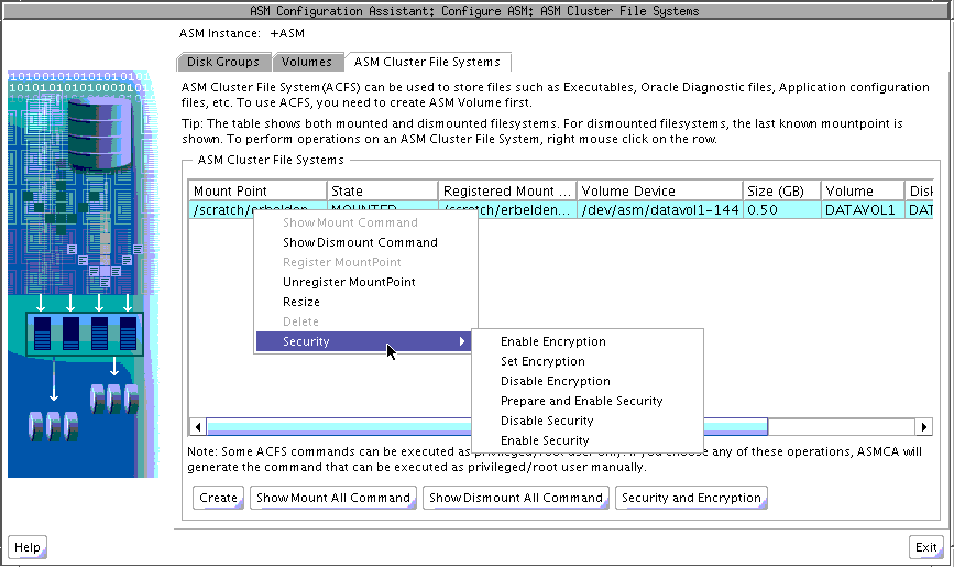

Oracle ASM Configuration Assistant enables you to configure security and encryption for an Oracle ACFS file system, as shown in Figure 11-11.
Figure 11-11 Oracle ASM Configuration Assistant Configure Oracle ACFS Security and Encryption Page

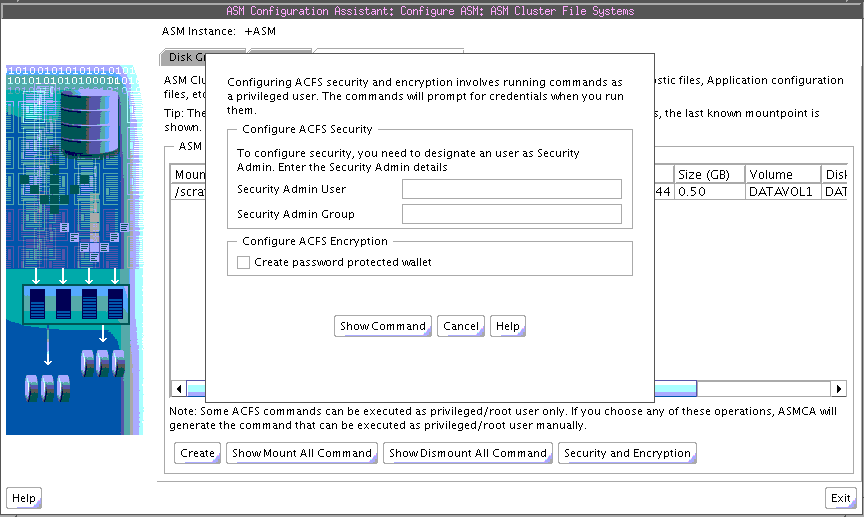

You must initialize the security system as the first step in configuring security for an Oracle ACFS file system. You must also initialize the encryption system as the first step in encrypting an Oracle ACFS file system. You do not have to use both Oracle ACFS security and encryption on the same file system. If you decide to use both security and encryption, then encryption must be initialized and set before enabling encryption on a security realm.
After you complete the entry fields in the dialog shown in Figure 11-11, click Show Command to display the commands you must run as a root or Administrator user at an operating system prompt. For example:
# /sbin/acfsutil sec init -u grid -g asmadmin # /sbin/acfsutil encr init
For information about the acfsutil sec init and acfsutil encr init commands, refer to "acfsutil sec init" and "acfsutil encr init".
After security has been initialized, you can use the menu options to manage security and encryption for an Oracle ACFS file system, as shown in Figure 11-12. These menu options include:
Enable Encryption
Set Encryption
Disable Encryption
Prepare and Enable Security
Disable Security
Enable Security
Figure 11-12 Oracle ASM Configuration Assistant Oracle ACFS Security Menu Options
For information about Oracle ACFS security, see "Oracle ACFS Security". For a summary of the basic steps for setting up security on an Oracle ACFS file system, see "Securing Oracle ACFS File Systems".
For information about Oracle ACFS encryption, see "Oracle ACFS Encryption". For a summary of the basic steps for setting up encryption on an Oracle ACFS file system, see "Encrypting Oracle ACFS File Systems".
For information about the acfsutil encr and acfsutil sec commands, see "Oracle ACFS Command-Line Utilities for Multiple Environments".

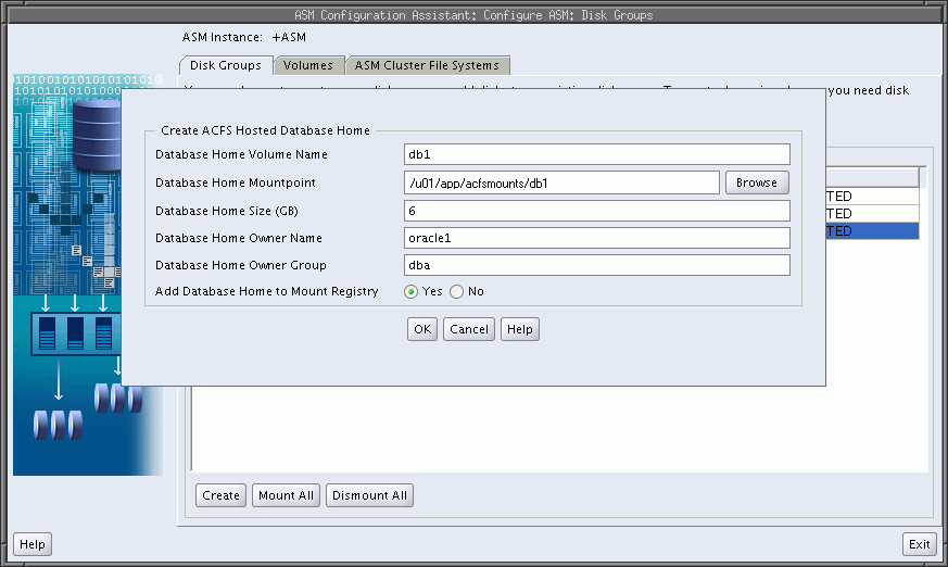

To create an Oracle ACFS file system for a database home, you can select the Create ACFS for Database Home from the disk group configuration options menu, as shown in Figure 11-4. The Create ACFS Hosted Database Home dialog displays as shown in Figure 11-13.
In this dialog, you must enter:
Database Home Volume Name
This is the name of the Oracle ADVM volume you want to create. For information about Oracle ADVM volumes, see "About Oracle ACFS".
Database Home Mount Point
This the mount point for the file system where you want to install the database home. The file system that contains the database home should not be located under the Oracle Grid Infrastructure base (ORACLE_BASE for grid) directory. For information about mount points and database homes, see "About Oracle ACFS and Oracle Database Homes".
Database Home Size in gigabytes (GB)
The default is 6 GB and the minimum size allowed.
Database Home Owner Name
This is the operating system name of the user that installs the database and owns the software in the database home.
Database Home Owner Group
This is the operating system group of the owner of the database home.
For information on the mount registry, see "About the Oracle ACFS Mount Registry".
Figure 11-13 Oracle ASM Configuration Assistant Create Oracle ACFS Hosted Database Home Page
