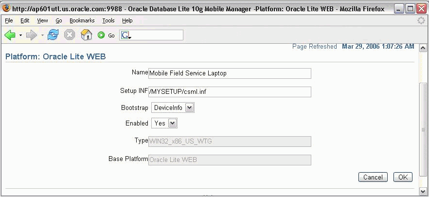

Configure the Mobile Field Service Laptop Platform:
Login to Oracle Lite Mobile Manager (http://<host name>:<port>/webtogo) using user and password: Administrator/<password>
Select Mobile Devices tab and Platforms sub tab.
Search for all platforms for Language English.
Select the platform Oracle Lite Web and click Extend button.
Enter Mobile Field Service Laptop in the Name field.
Enter /MYSETUP/csml.inf in the Setup INF field.
Click OK.

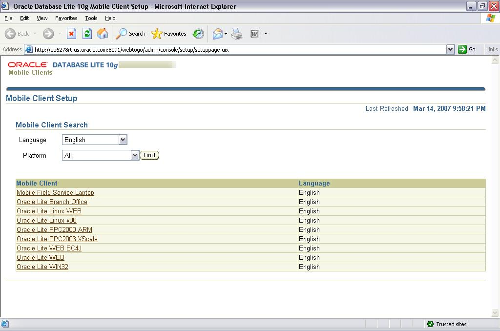

Open a new browser and go to the URL: http://<host>:<port>/webtogo/admin/console/setup/setuppage.uix
You should be able to view the Mobile Field Service Laptop link in the platforms listed.

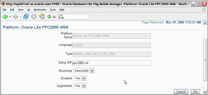

Enable Oracle Lite PPC 2000 ARM Platform:
Click on link for Oracle Lite PPC 2000 ARM Platform.
Select Yes in the Enabled field and click OK.
You should be able to view the Oracle Lite PPC 2000 ARM link in the platforms listed.
