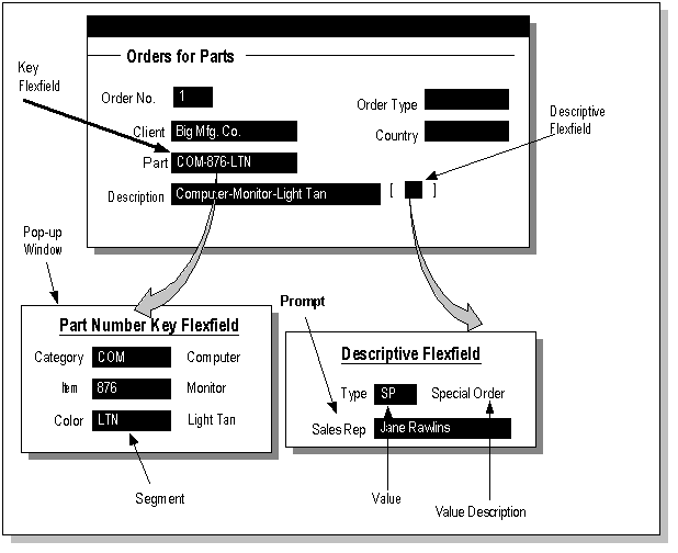

Most organizations use "codes" made up of meaningful segments (intelligent keys) to identify general ledger accounts, part numbers, and other business entities. Each segment of the code can represent a characteristic of the entity. For example, your organization might use the part number PAD-NR-YEL-8 1/2x14" to represent a notepad that is narrow-ruled, yellow, and 8 1/2" by 14". Another organization may identify the same notepad with the part number "PD-8x14-Y-NR". Both of these part numbers are codes whose segments describe a characteristic of the part. Although these codes represent the same part, they each have a different segment structure that is meaningful only to the organization using those codes.
The Oracle E-Business Suite stores these "codes" in key flexfields. Key flexfields are flexible enough to let any organization use the code scheme they want, without programming.
When your organization initially installs Oracle E-Business Suite, you and your organization's implementation team customize the key flexfields to incorporate code segments that are meaningful to your business. You decide what each segment means, what values each segment can have, and what the segment values mean. Your organization can define rules to specify which segment values can be combined to make a valid complete code (also called a combination). You can also define relationships among the segments. The result is that you and your organization can use the codes you want rather than changing your codes to meet Oracle E-Business Suite's requirements.
For example, consider the codes your organization uses to identify general ledger accounts. Oracle E-Business Suite represents these codes using a particular key flexfield called the Accounting Flexfield. One organization might choose to customize the Accounting Flexfield to include five segments: company, division, department, account, and project. Another organization, however, might structure their general ledger account segments differently, perhaps using twelve segments instead of five. The Accounting Flexfield lets your Oracle General Ledger application accommodate the needs of different organizations by allowing them to customize that key flexfield to their particular business usage. See the Oracle General Ledger documentation for more information on the Accounting Flexfield.
Important: Throughout this guide we use the "Part Number Key Flexfield" in our examples and graphics. We use this example because it helps to illustrate the uses and behaviors of key flexfields without requiring any specialized accounting, human resources, or manufacturing knowledge. However, there is no actual "Part Number Key Flexfield" in the Oracle E-Business Suite, and you should not confuse it with the System Items Flexfield (Item Flexfield) used by many Oracle E-Business Suite products such as Oracle Inventory.
Descriptive flexfields provide customizable "expansion space" on your forms. You can use descriptive flexfields to track additional information, important and unique to your business, that would not otherwise be captured by the form. Descriptive flexfields can be context sensitive, where the information your application stores depends on other values your users enter in other parts of the form.
A descriptive flexfield appears on a form as a single-character, unnamed field enclosed in brackets. Just like in a key flexfield, a pop-up window appears when you move your cursor into a customized descriptive flexfield. And like a key flexfield, the pop-up window has as many fields as your organization needs.
Each field or segment in a descriptive flexfield has a prompt, just like ordinary fields, and can have a set of valid values. Your organization can define dependencies among the segments or customize a descriptive flexfield to display context-sensitive segments, so that different segments or additional pop-up windows appear depending on the values you enter in other fields or segments.
For example, consider the Additions form you use to define an asset in your Oracle Assets application. This form contains fields to capture the "normal" information about an asset, such as the type of asset and an asset number. However, the form does not contain specific fields for each detail about a given asset, such as amount of memory in a computer or lifting capacity of a forklift. In this case, having all the potentially-needed fields actually built into the form is not only difficult, it is undesirable. Because while one organization may have computers and forklifts as assets, another organization may have only computers and luxury automobiles (and no forklifts) as assets. If the form contained built-in fields for each attribute of a forklift, for example, an organization with no forklifts would find those fields to be both unnecessary and a nuisance because a user must skip them to enter information about another type of asset. In fact, fields for forklift information would be cumbersome whenever a user in any organization tries to enter any asset that is not a forklift.
Instead of trying to contain all possible fields for assets information, the Additions form has a descriptive flexfield that you can customize to capture just the information your organization needs about your assets. The flexfield structure can depend on the value of the Asset Category field and display only those fields (segments) that apply to the particular type of asset. For example, if the asset category were "desk, wood", your descriptive flexfield could prompt for style, size and wood type. If the asset category were "computer, hardware", your flexfield could prompt for CPU chip and memory size. You can even add to the descriptive flexfield later as you acquire new categories of assets.

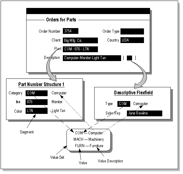

A segment is a single sub-field within a flexfield. You define the appearance and meaning of individual segments when customizing a flexfield. A segment is represented in your database as a single table column.
For a key flexfield, a segment usually describes a particular characteristic of the entity identified by the flexfield. For example, you can have a key flexfield that stores part numbers. The key flexfield can contain the part number PAD-YEL-NR-8 1/2x14, which represents a yellow, narrow ruled, 8 1/2" x 14" note pad. Each section in the part number, separated by a hyphen, describes a characteristic of the part. The first segment describes the object, a note pad, the second segment describes the color of the object, yellow, and so on.
Note that we also refer to the fields in a descriptive flexfield pop-up window as segments even though they do not necessarily make up meaningful codes like the segments in key flexfields. However, they do often describe a particular characteristic of the entity identified elsewhere on the form you are using.
Your end user enters a segment value into a segment while using an application. Generally, the flexfield validates each segment against a set of valid values (a "value set") that are usually predefined. To "validate a segment" means that the flexfield compares the value a user enters in the segment against the values in the value set for that segment.
You can set up your flexfield so that it automatically validates segment values your end user enters against a table of valid values (which may also have value descriptions). If your end user enters an invalid segment value, a list of valid values appears automatically so that the user can choose a valid value.
You can think of a value set as a "container" for your values. You choose what types of values can fit into your value set: their length, format, and so on.
A segment is usually validated, and usually each segment in a given flexfield uses a different value set. You can assign a single value set to more than one segment, and you can even share value sets among different flexfields. For most value sets, when you enter values into a flexfield segment, you can enter only values that already exist in the value set assigned to the segment.
A flexfield structure is a specific configuration of segments. If you add or remove segments, or rearrange the order of segments in a flexfield, you get a different structure.
You can define multiple segment structures for the same flexfield (if that flexfield has been built to support more than one structure). Your flexfield can display different prompts and fields for different end users based on a data condition in your form or application data. Both key and descriptive flexfields may allow more than one structure.
In some applications, different users may need a different arrangement of the segments in a flexfield (key or descriptive). Or, you might want different segments in a flexfield depending on, for example, the value of another form or database field.
Your Oracle General Ledger application, for example, provides different Accounting Flexfield (Chart of Accounts) structures for users of different sets of books. The Oracle General Ledger application determines which flexfield structure to use based on the value of the GL Set of Books Name user profile option.
