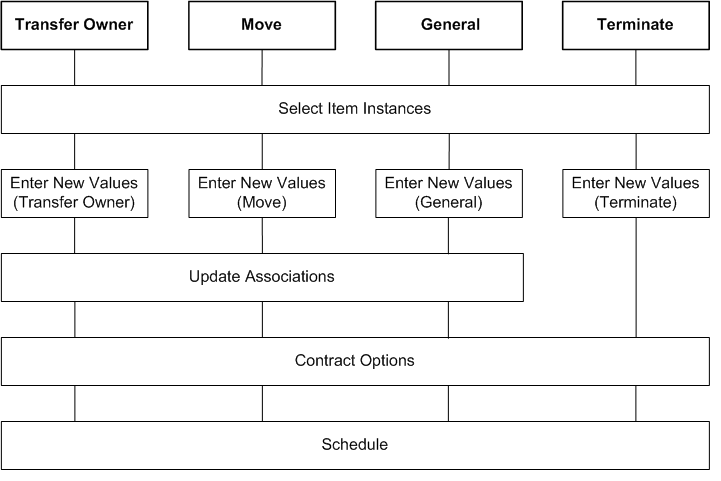

You create one or more Mass Update batches, each of which contains the parameters required to perform the mass update of a set of item instances. You then schedule the batch; this submits a concurrent request to perform the mass updates.
The creation of a batch is a process with several stages. You first select the mass update batch type, that is, Transfer Owner, Terminate, Move or General. Then for each mass update type, you follow a series of stages.
The main stages required for the creation of a mass update batch depend on, and vary with, the batch type. Only the relevant pages for that batch type are presented to the user. The diagram that follows shows these stages for each of the mass update batch types:
For more information about the mass update stages, see Overview of Mass Update Stage Operations.
The main stages of the mass update process are as follows:
When you create or update a mass update batch, the stages are represented by a left-to-right "train" of steps, which appears at the top of each page.
When you create a batch, you may perform each of the steps in sequence, or you may break out of the sequence, and complete the steps by updating the batch later. When you update a batch, you can select any step that appears as a clickable link in the train of steps.
For all batch types, you must go through the first two stages, Select Item Instances and Enter New Values, and specify the data to change in the item instances you select. The Update Associations stage and the Contract Options stage are both optional.
To submit a batch for execution, you must perform the Schedule stage.

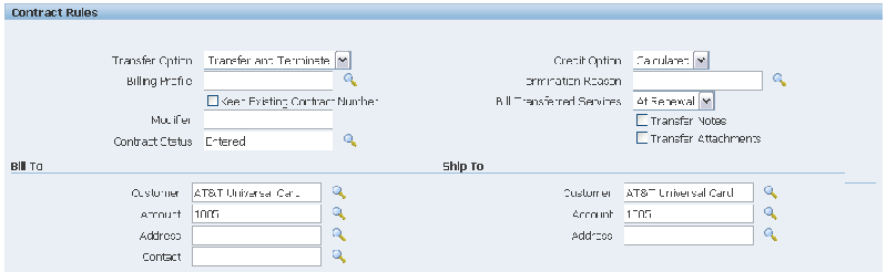

For Transfer Owner and Terminate batches, you can enter contract options for the selected item instances; for the other batch types, you can only view the existing contract options associated with item instances.
For details, see Entering and Viewing Contract Options.

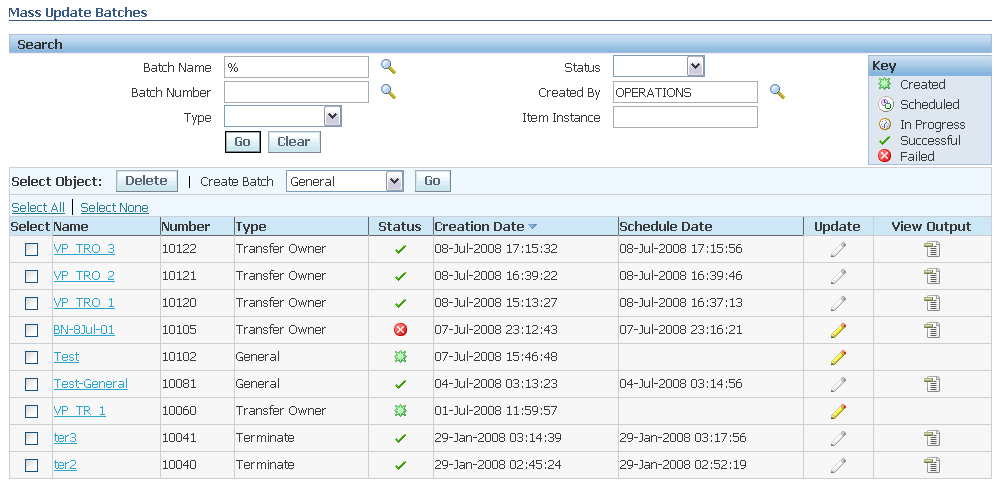

You can perform the following batch management functions from the Mass Update Batches page:
Throughout the process of creating or updating a batch, Oracle Install Base performs automatic validation of the data, particularly when you explicitly save the data or submit the batch. Validation detects situations such as when you initially select item instances to be updated by the batch, but by the time that you submit the batch, those item instances have been expired.
When it detects an error, Oracle Install Base displays a summary error message on the page, with a link that enables you to see more error details.
You can search for existing Mass Update batches using the following search parameters:
Batch Number
Batch Name
Type
Either All Types or one of the existing mass update batch types
Status
Either Any Status or one of the values Created, Scheduled, In Progress, Successful, Failed
Created By
Item Instance
Click the Mass Update tab.
In the Search area of the Mass Update Batches page, enter one of more search parameters, and click Go.
The batches that satisfy the search criteria appear in the lower part of the page.

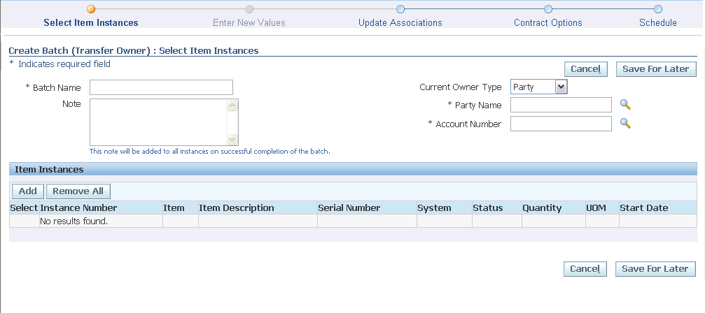

When you create a new mass update batch, you must first choose the batch type and give the batch a name.
If the batch type is Transfer Owner, you must also select the owner name and owner account.
You can also enter a Note for the batch. This note will be automatically added to all the item instances of the batch if the batch mass update completes successfully.
In the Create Batch field, select the batch type from the list of values, and click Go.
The Create Batch page for your selected batch type appears.
Enter a Batch Name for your batch.
For Transfer Owner batches only, select a Current Owner Name and an Owner Account Number.
Optionally, enter Note information.
The Note information is added to each item instance of the batch if the batch executes successfully.
You may proceed in either of the following ways:

The Contracts Options page shows contracts impacted by the selected item instances, and provides you with a number of options for indicating how the instance transfer should affect associated services.
Note: If the item instances selected in a Transfer Owner batch result in contracts from multiple operating units being selected for transfer, a warning appears on the Contracts Options page, and advises that Bill To and Ship To addresses for the new service contracts will be defaulted from customer setup.
For Transfer Owner batches, and, to a lesser extent, for Terminate batches, you must specify one or more contract rules.
For Terminate and Transfer Owner batches, you must provide some contract transfer rule information.
For Terminate batches, you must provide a termination reason; you can also select a credit option.
For Transfer Owner batches, you must first choose a Transfer Option from the following:
Transfer and Terminate
Terminate
Use Coverage Terms
No Updates to Contracts
The amount of information available for viewing and updating depends on your choice of Transfer Option.
If Transfer Option=Transfer and Terminate or Use Coverage Terms, all the fields described subsequently in this section apply and are available.
For Transfer Option=Terminate, the only fields available are Termination Reason and Credit Option.
For Transfer Option=No Updates to Contracts, no fields are available.
Note: Unless stated otherwise, all fields are optional.
Termination Reason
Mandatory field when Transfer Option=Terminate, otherwise optional.
Credit Option
There are three options for issuing a credit on the original service contract:
Calculated - Issue a calculated credit for the prorated value of services transferred.
Full - Issue a full credit for the services transferred.
None - Issue no credit for services transferred.
Billing Profile
The list of values contains all billing profiles created for the new owner as well as generic billing profiles. Selecting the billing profile sets the billing schedule, invoicing rule and accounting rule for the transferred lines. Leaving the billing profile blank results in a billing schedule with one-time billing, an invoicing rule of Advanced and an accounting rule of Immediate.
Keep Existing Contract Number
Selecting this checkbox results in new contracts retaining the same contract number as the source contracts for the transferred services.
Modifier
You can enter a modifier that will apply to all contracts created for transferred services. If no value is entered, the modifier will be the value for the profile option OKS: Transferred Contract Identifier concatenated with a datestamp.
Contract Status
Mandatory field, default value is Entered. The list of values contains all statuses that map to status types Entered and Active.
Bill Transferred Services
There are three possible values: Yes, No, and At Renewal.
If you select At Renewal, billing behavior of transferred services will be as follows:
Service transferred from Active or Signed contracts
The Bill Services flag on the new contract is set to At Renewal. The contract will not bill unless you manually override the flag in the service contracts authoring form.
Service transferred from Entered contracts
The Bill Services flag on the new contract is set to Yes.
Transfer Notes
Select the checkbox to transfer header notes; line coverage notes always transfer.
Transfer Attachments
Select the check box to transfer attachments. When selected, all attachments on the original contract are transferred to the new contract.
Bill To Customer
Defaults from the new Bill To customer entered for the item instances, provided the Bill To customer is related to the new owner account. If not related, the Bill To customer field has no default value and you can enter a customer.
You can optionally override the defaulted value with a different Bill To customer for transferred services.
If the Bill To customer is different from the new owner, the contract Bill To customer will also be added to the contract as a third party.
If no contract Bill To customer is specified in the batch, the contract Bill To customer will be derived from the new owner entered for the Transfer Owner batch.
The Bill To customer entered is used for all contracts created for the Transfer Owner batch.
Bill To Account
Follows same rules as Bill To Customer.
Bill To Address
You can only select a contract Bill To address if all of the impacted contracts map to the same operating unit. The list of values only contains addresses that are associated with that operating unit. If no value is entered, the Bill To address will be defaulted from TCA - the primary Bill To address for the Bill To account specified for the new contract.
If the impacted contracts are from multiple operating units, you will not be able to enter an address for the new Bill To customer. In such cases, the Bill To address will be derived from the primary Bill To address defined for the Bill To account for each operating unit.
Bill To Contact
Follows the same rules as Bill To Customer.
Ship To Customer
Ship To Account
Ship To Address
Follows the same rules as Bill To Address.

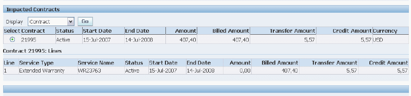

For all batch types, you can view the contracts to be impacted by the batch updates. You can select the type of display for the contracts:
Contract
Contract-level information appears in a "master" table. Service line details of the contract selected in the master table appear in the "details" table underneath.

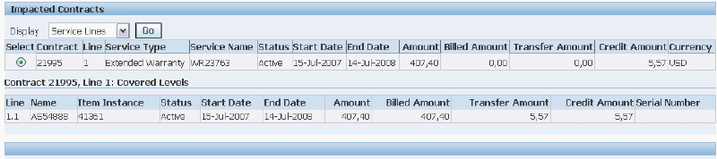

Service Line
Contract and service line information appears in a "master" table. Subline details of the service line selected in the master table appear in the "details" table underneath.

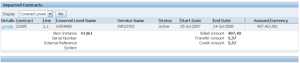

Covered Levels
Contract, subline, and covered level information appears in a table. You can optionally view item instance details for the covered products.
Key fields in the contract, service line and subline tables are Transfer Amount and Credit Amount. The latter is the amount that results from a termination.
Select and enter the contract transfer rule values that you require for the current batch.

If you save a batch with Bill To and Ship To details, then later try to change the New Owner for the batch, you will receive an error message indicating that dependent data (Bill To and Ship To details) have been entered for the existing customer in the Contract Options page. You must remove the Bill To and Ship To details in the Contracts Options page before you can change the new owner.
If you save a batch, and subsequently the results set of the Impacted Contracts has changed to include contracts from multiple operating units, the Contract Options page will display a warning message and the Bill To and Ship To addresses and contacts will be greyed out.
The consequences of executing the mass update batch are as follows:
If the services in the impacted contracts are to be terminated, then the values entered in the Contract Options page for Termination Reason and Credit Option are applied to the terminated services.
If the services in the impacted contracts are to be transferred, then all the contract transfer rules entered in the Contract Options page are applied to the new contracts created for the transferred services.
After entering all the details for the mass update batch, you can submit the batch for execution. This schedules a concurrent request to perform the mass updates.
The concurrent request executes all the mass update batches that are available for processing at the time, and generates a single output file.
Select your Submit option, either to submit as soon as possible, or to submit at a specified date and time.
Note: For Transfer Owner batches, if you specified the transfer date, the batch submission date must be after the transfer date.
Click Submit.
The status of the batch changes to Scheduled. For more information on batch statuses, and the operations that you can perform on a batch after scheduling, see Mass Update Batch Statuses and Viewing Output of a Failed Mass Update Batch.

When a mass update run finishes, it produces an output file of the results of the processing for each of the batches executed during that run.
If a batch that was executed as part of the run had any errors, the batch status is set to Failed. You can view the output of the run that included the batch execution, to see details of the item instance update failures.
Click the View Output icon of a batch to see the output of the run that included that batch.
For the error records, make corrections to the associated item instances, and resubmit the batch.
You can delete any batch that is not is progress. When you delete a batch that has not yet been executed, any contract options that you selected for the batch are backed out, that is, not implemented.
In the Item Instances area, select one or more batches, and click Delete.
