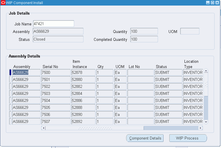

Oracle Install Base configurations are generally created using job requirement quantities. When the issued quantity does not match the job requirement quantity, excess components are left free standing and are not attached as part of an Install Base top assembly configuration. You can use the Install Base component install (WIP) windows to allocate these freestanding or non-allocated components to specific assembly configurations following WIP assembly completion.
Note: With reference to WIP and Install Base integration:
Configurations are built only for serialized top assemblies.
The functionality is relevant to multi quantity WIP jobs.
Use this procedure to allocate free-standing or non-allocated components to specific assembly configurations following WIP assembly completion.
You must have completed a job and created at least one serialized assembly.
Using the Oracle Install Base Admin responsibility, navigate to IB Component Install (WIP).
The WIP Component Install window appears.
Enter a WIP job name.
Tab to the next region.
The window displays assemblies created by your job.

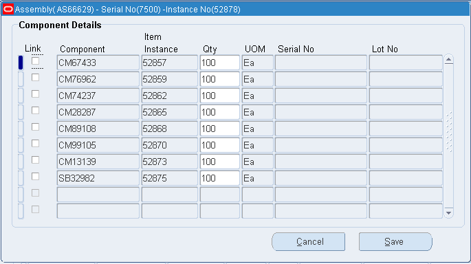

Click in a row to select a specific assembly to which you want to attach unattached components.
Click Component Details.
The Component Details region of the Assembly window displays unattached components for the job.
Select the Link check box for any component that you want to attach to the serial assembly.
Click Save to save your changes.
The WIP Component Install window reappears.
Click WIP Process to submit a concurrent job to attach components to desired assemblies.
Optionally, query the job until it displays an assembly status of Processed, which denotes successful processing.

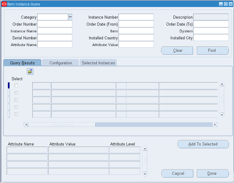

The Item Instance Query window displays existing configured item instances, including attributes and components, primarily to support the Oracle Order Management Telecommunications Service Ordering (TSO) functionality using Sales Orders or Quick Sales Orders windows. The Item Instance Query window provides integration and flexibility in entering TSO changes from multiple sources.
Here are key features of the window:
Ability to query instances based on a wide range of query parameters including extended attributes
Ability to view configurations, in a tree structure, from the Sales Order window and select those instances where you want the configuration to change
When called from the Sales Orders window, the ability to return a PL/SQL table of records for processing by Oracle Order Management
To make a query through Oracle Order Management so that you can return values to that application, perform the steps below:
Using the Order Management Super User responsibility, select Orders, Returns > Sales Orders.
The Sales Orders window appears.
Create or query an order.
Click the Line Items tab.
Enter an order line.
Click Actions.
The Actions window appears.
Select Item Instance Query, and click OK.
The Item Instance Query window appears.
In the top region, specify the criteria for your instances, and click Find.
The results of the search appear in the Query Results tab. Extended-attribute information for a selected instance appears in the bottom region of the Item Instance Query window.
To add an instance from the Query Results tab to the list on the Selected Instances tab, either select its Select box or select the instance and click Add to Selected.
In the Query Results tab, select an instance and then click the Configuration tab to see any configuration for that instance.
Select any node, either parent or child, and click Add to Selected to add the node to the list in the Selected Instances tab.
To remove an instance from Selected Instances, select an instance there and click Remove from Selected.
Click Done to close the window, pass a PL/SQL table of selected instances to the calling window if there is one, and clear the PL/SQL table.
The selected instances are not stored in any database table. After you close the window, you cannot go back and add more instances to those that you selected.
