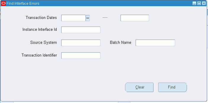

After the program has run, navigate to Open Interface Error Details.
The Find Interface Errors window appears.
Complete the desired entries, and click Find.
The Open Interface Error Details window appears.
Review and edit error transaction details. Select the Process check box for transactions that you want to reprocess.
Save your changes.
