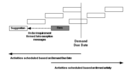

| 7: Order is firmed late | No | Yes | Yes | Yes | Yes |
| 8: Requirement is firmed late | No | Yes | Yes | Yes | Yes |
| 9: Order is firmed early | No | Yes | Yes | Yes | Yes |
| 10: Requirement is firmed early | No | Yes | Yes | Yes | Yes |
| 11: Shared supply scheduled late | No | Yes | Yes | Yes | Yes |

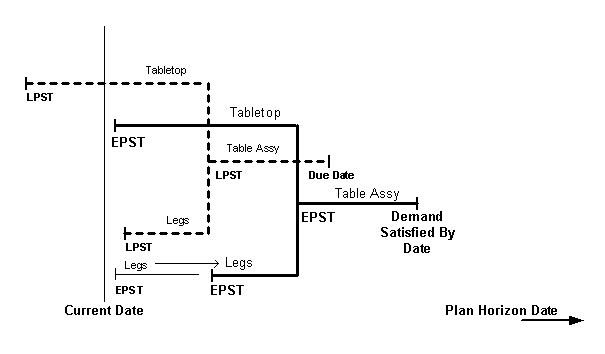

This exception appears when the planning engine is scheduling activity Unconstrained Latest Possible Completion Times (ULPCTs) for a supply order and finds a firm supply that does not fit in with the scheduling of the non-firm operations to that point.
This diagram shows an example of the situation.
Order/requirement firmed late example

The planning engine issues these exceptions against firmed resource requirements and supply orders when it thinks they are firmed with either of the following effects:
Too early: It cannot properly schedule upstream tasks--using minimum duration--to start after the plan start date.
Too late: It cannot properly schedule downstream tasks--using minimum duration--to finish before the demand due date.

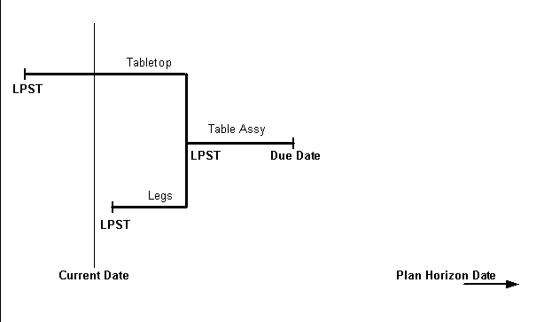

The latest possible start time (LPST) is the time that the activities need to start to meet the demand on time. If the latest possible start time is in the past, the planning engine cannot schedule to meet the demand on time.
This diagram shows the table assembly and its subassemblies backward scheduled from an independent demand due date. The schedule shows each job finishing just in time for its next use; therefore, the beginning of each job is its latest possible start time. The latest possible start time for the tabletop is in the past.
Latest Possible Start Date Example
The earliest possible start time (EPST) is the earliest time that the planning engine can schedule the operations to start.
The earliest possible completion time (EPCT) is the earliest date that the operations are complete if they start at the earliest possible start time.
This diagram shows the table assembly and its subassemblies backward scheduled from the demand due date. Since the tabletop latest possible start time is in the past, the planning engine forward schedules each subassembly from the current date (as material and resources are available). The result is the demand satisfied by date for the table assembly which is later then the demand due date. Since the legs subassembly has a shorter lead-time than the tabletop assembly, it is finished sooner than the tabletop assembly. The completed legs subassembly remains in work in process or moves to inventory until the table assembly needs it.
Earliest Demand Satisfied Date Example

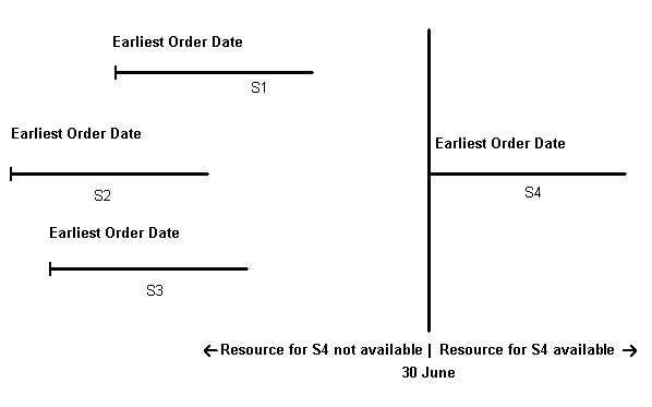

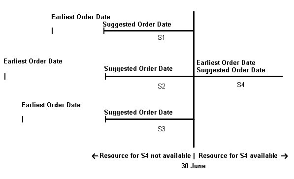

The earliest order date is the earliest possible date that you can start the order, given plan constraints. It is the earliest possible date that can appear as the suggested order date and usually corresponds to the following dates:
Make order: Suggested start date
Buy order: Suggested dock date
Transfer order: Suggested ship date

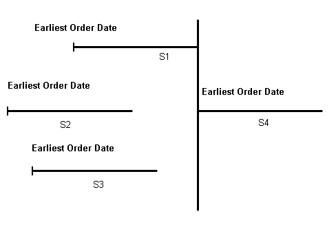

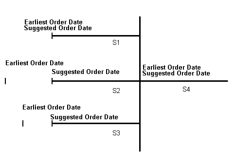

Even for supplies on the critical path, the suggested order date is usually after the earlier order date because the planning engine right-justifies it to the next order which has its own set of constraints.
If the suggested order date is later than earliest order date, it is usually because there are more constraining supplies at the same level. If this supply started on earliest order date, it would wait on the other constrained supplies (buy items or subassemblies). The planning engine sets the suggested order date later (delays the order start) to avoid work in process and inventory build-up.
This diagram shows three supplies (S1, S2, and S3) pegged to supply S4. The planning engine forward scheduled the supplies and set the suggested order date for each one to be the same as the earliest order date
Earliest Order Date Example
In this diagram, the planning engine has backward scheduled all of the supplies from the due date of S4 to minimize work in process and inventory. This aligns the due date of the subassemblies with the start date of S4. The suggested order dates for S2 and S3 are later than their earliest order dates.
Suggested Order Date Shifted Example

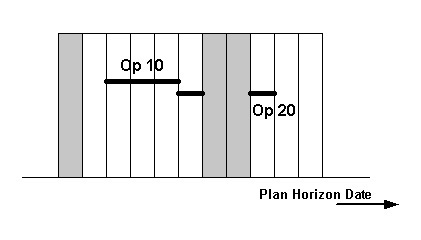

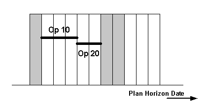

The earliest completion date is the date that the order can finish if you start it on earliest order date. It is the earliest possible date that can appear as the suggested due date.
If suggested order date is the same as earliest order date, then the field suggested due date is the same as earliest completion date.
If suggested order date is different from earliest order date, the time between earliest order date and suggested start date may not be the same as the time between earliest completion date and suggested due date. Breaks in the capacity profile (for example, holidays) may create capacity availability breaks that result in the operations stretching as they fit in around these breaks.
This diagram shows a supply that has two operations; operation 10 lasts three days and operation 20 lasts two days. The planning engine can schedule the operations with no breaks. Since there is no difference between suggested order date and earliest order date, there is no difference between suggested due date and earliest completion date.
Earliest Possible Times Example
This diagram shows the supply when the planning engine must schedule the operations with breaks. Since there is a difference between suggested order date and earliest order date, there difference between suggested due date and earliest completion date. However, the differences are not the same:
The difference between suggested order date and earliest order date is one day
The difference between suggested due date and earliest completion date is three days
Actual Times Example

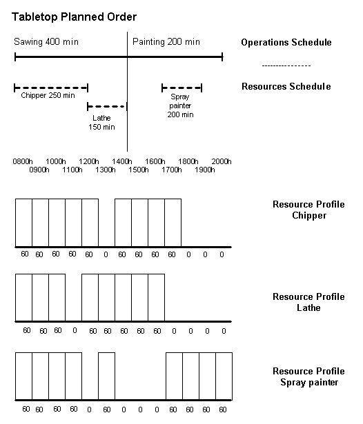

This diagram shows the operations and resource schedule for a tabletop. Operation 10 Sawing takes 400 minutes and uses resources Chipper for 250 minutes and Lathe for 150 minutes. Operation 20 Painting takes 200 minutes and uses resource Spray painter. The capacity consumption profiles for the resources show that the resources are not always available. Therefore, the:
Schedule for this supply is delayed while waiting for the resource Spray painter
Due date of the supply is later than it would be if the resource was available when the tabletop assembly was ready for it
Precedence Constraints and Resource Availability

If the critical path encounters a firm discrete job, firm planned order, or firm operation), it displays information until the last activity of the firmed supply. It does not consider the following as critical:
All operations of the firmed supply
Components pegging to the firmed supply
