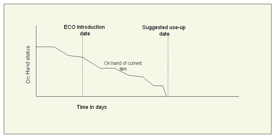

Oracle ASCP evaluates the engineering change orders as of their scheduled effective date. You can order material and plan resources that you need for new revisions ahead of time.
Note: The planning process only suggests implementing engineering change orders when the unconstrained start date of the planned order is later than the effective date. Oracle ASCP does not suggest a planned order using an ECO if the planned order needs to start before the effective date of the ECO.
For a pending ECO, you can specify whether to include the engineering changes during the planning process. Set the MRP Active Flag to Yes in the Engineering Change Order window if you want the planning process to consider the engineering changes on the ECO.
Oracle ASCP considers engineering changes when generating component requirements for planned orders and suggested repetitive schedules. The quantity specified by an engineering change order is considered if the scheduled effective date of the ECO is before the suggested start date of the order. For additional information, see Engineering Change Orders Use-Up Effectivity.

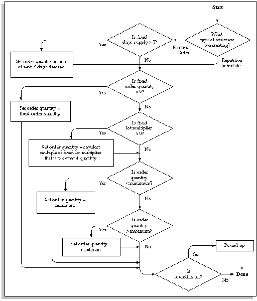

Order sizing is a set of item attributes that allow you to control the recommended order quantities for planned orders. The planning process creates planned orders using basic lot-for-lot sizing logic.
You can set order modifiers in the following forms:
Master Items and Organization Items
Supplier-Item Attributes: These values supersede values in Master Items and Organization Items
Recipe Validity Rule Details: For process manufacturing
Note: The planning process ignores order modifiers for items that have a phantom supply type.
Note: Order modifiers for supplied items may be defined by their suppliers.
For additional information, please refer to Items, General Planning Attribute Group and MPS/MRP Planning Attribute Group in the Oracle Inventory User's Guide.
The planning process places single orders for the quantity that covers the requirements for the user-defined number of days. When suggesting planned orders, the planning process looks forward this many days and accumulates all of the demand in that time period. It then suggests a planned order to satisfy the total quantity required for that time period.
If you use order modifier Fixed Days of Supply, the planning engine creates a single supply to cover multiple days of demand. During constraint-based scheduling, the planning engine may move the demand and supply dates such that you cannot reconcile the supply quantity to the demand dates and quantities. To attempt a reconciliation, Oracle recommends using the old due date on the planned order demands.
The planning process places one or more orders for the user-defined quantity or repetitive rate.
For discretely planned items, when the requirement for a given date exceeds the fixed order quantity, place multiple orders.
For repetitively planned items, either recommend a rate equal to the fixed order quantity or a rate of zero.
The planning process places single orders in quantities that are multiples of the user-defined quantity or rate.
For example, when the fixed lot multiple quantity is 100 and the requirement equals 110 units, place a single order for 200 units.
Minimum and Maximum Order Quantity
The planning process places one or more orders for at least the minimum quantity, but no greater than the maximum quantity.
For discretely planned items, when the requirement for a given date exceeds the maximum order quantity, the planning process places multiple orders.
You can define, for each inventory item, whether the planning process should round order quantities when the actual order quantity is calculated as a fraction. If you choose to round, order quantities are rounded to the next highest whole number.
Note: By rounding up, the planning process may suggest a planned order for more than what is actually needed. This extra quantity is carried over into the next period as supply.
This diagram shows the order in which the planning engine applies order modifiers to planned orders (precedence of order modifiers).

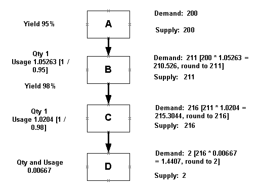

You specify process yields in the routings. The planning engine inflates material requirements and calculates resource requirements based on the amount of expected material at each operation sequence. The following process yield information is available in the standard, flow, and network routing types:
Yield
Cumulative yield
Reverse cumulative yield
Process yield

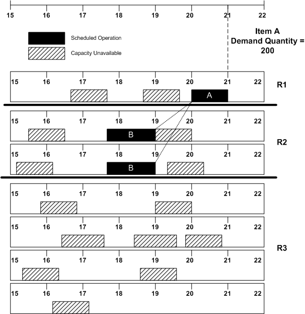

Consider an example that illustrates the use of the profile option MSO: Use of Assigned Units in Scheduling and the related impact on backward and forward scheduling. Three items (A, B and C) are being manufactured.
Make A
Operation Sequence 10
Resource R1
Assigned Units = 1
200 units/day
Maximum Availability of Resource = 2
Make B
Resource R2
Assigned Units = 2
80 units/day
Make C
Resource R3
Assigned Units = 4
100 units/day
Maximum Availability of Resource = 4

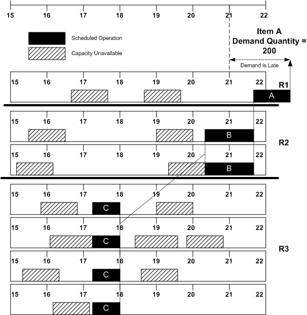

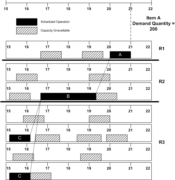

If you set the profile option MSO: Use of Assigned Units in Scheduling to Variable, backward scheduling succeeds as depicted by the illustration. In the illustration, A, B and C represent three items. R1, R2 and R3 represent the three resources who have specific units assigned. The demand is due on the 21st day.
Impact on Backward Scheduling With Value Variable
Backward schedule succeeds as the item C is scheduled in the available planning horizon.
The following illustration depicts the case when the profile option is set to Fixed at Routing Value.
Impact on Backward Scheduling With Value Fixed at Routing Value
Backward scheduling fails when the profile option MSO: Use of Assigned Units in Scheduling is set to Fixed at Routing Value. There is no date available in the planning horizon to schedule 4 units for resource 3.

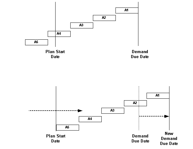

Using the same example, consider the following illustration that depicts the late demand scenario when you perform forward scheduling with the profile option MSO: Use of Assigned Units in Scheduling to Fixed at Routing Value.
Impact on Forward Scheduling With Value Fixed at Routing Value

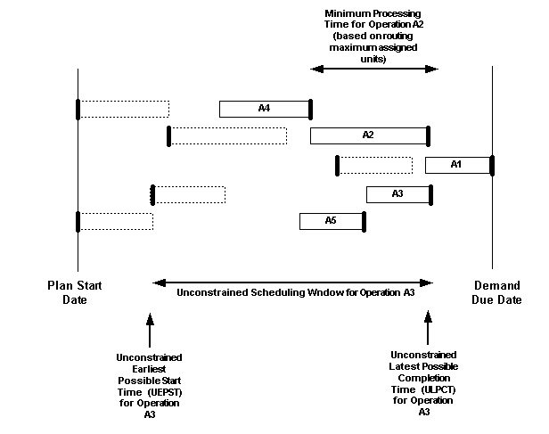

Using the look-ahead heuristic, the planning engine:
Schedules supplies so that, as much as possible, you work on supplies pegged to higher priority demands ahead of supplies pegged to lower priority demands.

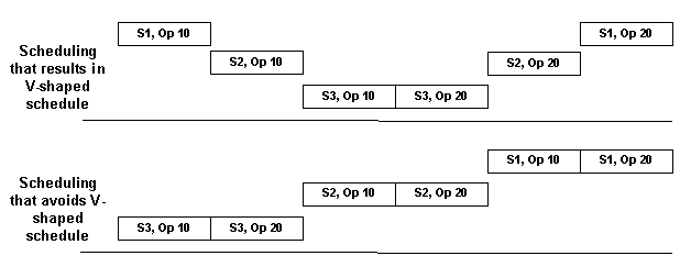

The planning engine tries to avoid V-shaped schedules by scheduling all of the operations of a supply before scheduling any other supplies. This reduces the chance of scheduled gaps between operations of any supply.
A V-shaped schedule is a schedule with a consistent pattern of gaps between operations in the same routings. For example, a routing has operation sequences 10 and 20 which use the same resource. The planning engine needs to schedule three supplies (S1, S2, and S3) for that item that are pegged to different demands. This diagram shows the resource scheduling which results in and with avoiding V-shaped schedules.
Resource Scheduling
The planning engine may not always avoid gaps and V-shaped schedules, especially in cases of:
Resource constraints in Constrained - Enforce due dates plans
Components assigned to operations in the middle of the routing
Co-products assigned to operations in the middle of the routing

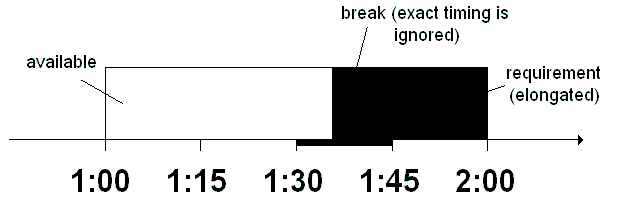

This feature enables planners to plan resource shift start and end times at any minute within the hour. This feature enables ASCP to handle aggregate planning and detailed scheduling concurrently and to accurately schedule resources down to the minute time level.
For the portion of the planning horizon that is planned at greater than minute-level granularity (the portion that is planned at the hour, day, week or period levels), ASCP factors in break periods by extending operation times to reflect the proportion of breaks within each planning time bucket. For example, a 2-hour operation that occurs during a day-level planning bucket that has breaks at 4:00-5:00, 12:00-13:00 and 20:00-21:00 would be stretched into a 2 / (21/24) = 2.29-hour operation. The exact timing of breaks within this day-level planning bucket is ignored. This solution maintains as much scheduling accuracy as possible when more aggregate (time-bucketed) planning is being done.
Consider a one-hour portion of the planning horizon (1:00 - 2:00). Within this period there is a resource break of 15 minutes (1:30-1:45). The size of the planning time bucket is 1 hour.
ASCP calculates an elongation factor for this period that is equal to the ratio of working time within the period to the total duration of the period.
Elongation factor = (60 - 15) / 60 = 0.75
If there is a resource requirement of 18 minutes, due at 2:00, by using the elongation factor, the requirement duration is calculated to be:
Requirement duration = 18 / 0.75 = 24 minutes
The requirement start time is therefore set to requirement end time (2:00) minus 24 minutes:
Requirement start time = 1:36
The following figure is an example of how a resource break is scheduled for when the planning time bucket size is one hour:
One Hour Planning Time Bucket Size
Note that the requirement is scheduled to start in the middle of the resource break; the exact timing of the resource break is ignored. This is an approximation that ASCP makes in any time bucket of size 1 hour or more. It allows for as much scheduling accuracy as possible while planning at more aggregate time levels.

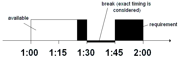

Consider the same one-hour portion of the planning horizon (1:00 - 2:00), with the same resource break of 15 minutes (1:30-1:45). In this example, the size of the planning time bucket is 1 minute (the smallest permitted by ASCP).
Once again there is a resource requirement of 18 minutes, due at 2:00.
Since this is the minute-by-minute detailed scheduling portion of the plan horizon, break start and end times are accounted for down to the nearest minute. An elongation factor is not used.
The requirement start time is calculated to be:
Requirement start time = 1:27
The following figure is an example of how a resource break is scheduled for when the planning time bucket size is one minute:
One Minute Planning Time Bucket Size
This allows for 3 of the 18 minutes of work to be done before the break (1:27 to 1:30), then the remaining 15 minutes of work to be done after the break (1:45 to 2:00). No work is scheduled during the break.
The above two examples demonstrate the contrast in the level of detail of scheduling that occurs in aggregate (greater than one minute duration) time buckets versus detailed (one minute duration) time buckets.

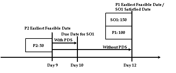

In this example, there is a sales order SO1 for 150 with a due date on day 10. There are two planned orders P1 and P2 satisfying this sales order demand. This is shown in the following diagram:
Partial Demand Satisfaction
The planned order P2 can be completed on time; however, the planned order S1 can be completed only by day 12.
Without the Partial Demand Satisfaction enhancement, ASCP would have scheduled both P and P2 to complete on day 12.
Using the Partial Demand Satisfaction feature, P2 is scheduled to complete on time (on day 10), while P1 remains scheduled for day 12. This permits P2 to be released, executed and shipped in time to partially satisfy customer demand on time.
In the Exception Details form (Supply Chain Plan > Workbench > Actions tab > drill down on an Action Type), the column named Quantity Satisfied By Due Date is used to present the portion of a demand that can be satisfied by the due date.

Smaller planned orders typically give the planning engine more flexibility and result in a schedule in which supplies are more likely to be made just in time to meet their demands. This feature instructs the planning engine to split planned orders to more closely match the quantities of the demands to which they are pegged. Use it if:
You do not typically use order modifiers
Your plan results in planned orders which peg to demands with widely separated due dates
Your plan results in product made near-term when most of it is needed to satisfy demands that are due farther out
Split planned orders defaults such that if a planned order with quantity more than 10% higher than the quantity of the demand to which it is pegged, the planning engine splits it. To change the default percentage or disable the feature, set profile option MSO: Demands Size Tolerance PCT Before Splitting Planned Orders with the percentage in decimal format (for example, for 10%, enter 0.1, not 10).
During pegging, the planning engine:
Pegs a planned order to a demand.
Checks to see if the planned order item has order modifiers. If so, it does not split the planned order.
Checks to see if the planned order quantity is significantly larger than the demand quantity. The check is (Planned order quantity - Demand quantity) / Demand quantity > MSO: Demands Size Tolerance PCT before Splitting Planned Orders.
If the calculation shows not significantly larger, the planning engine does not split the planned order.
If the calculation shows significantly larger, the planning engine splits the planned order, assigns the demand quantity to the new planned order, and pegs the new planned order to the demand.
For example, MSO: Demands Size Tolerance PCT before Splitting Planned Orders is 0.1. The planning engine:
Pegs planned order 1 for item S with quantity 100 to demand A with quantity 20.
Verifies that item S has no order modifiers set.
Calculates ((100 - 20) / 20 = 4.
Verifies 4 > 0.1.
Splits planned order 1. Planned order 1 has quantity 80 and new planned order 1-a has quantity 20.
Removes the peg of planned order 1 to demand A and pegs planned order 1a to demand A.

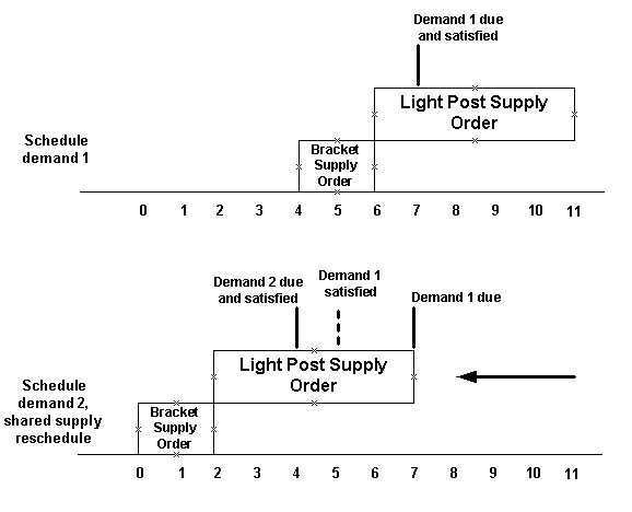

For example, the last process to produce light posts is to have a welder attach a purchased bracket to a light post subassembly. The welder can attach 100 brackets a day.
Two demands peg to a shared supply for attaching the brackets. Both demands are in the same demand slice:
Demand 1: End Item: Light post, Quantity: 100, Demand Due Date: Day 7, Priority: 1
Demand 2: End Item: Light post, Quantity: 200, Demand Due Date: Day 4, Priority: 200
Processes demand 1, the higher priority demand which is due on day 7.
Schedules the brackets to arrive on day 6. The welder is to produce 100 light posts on day 6 and meet demand 1 on time.
Processes demand 2, the lower priority demand which is due on day 4, earlier than demand 1.
Reschedules the brackets to arrive on day 2. The welder is to produce 200 light posts on days 2 and 3 and meet demand 2 on time, then is to produce 100 brackets on day 4 and meet demand 1 early.
Figure Title

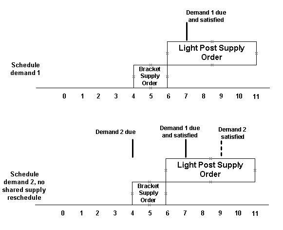

If multiple demands that are pegged to one shared supply are in different demand slices, the planning engine does not typically reschedule the shared supply.
Two demands peg to a shared supply for attaching the brackets. Each demand is in a different demand slice:
Processes demand 2, the lower priority demand which is due on day 4, earlier than demand 1 and is in a different slice than demand 1.
The welder is to produce 100 light posts on day 6 and meet demand 1 on time, then is to produce 200 brackets on days 7 and 8 and meet demand 2 late.
Figure Title

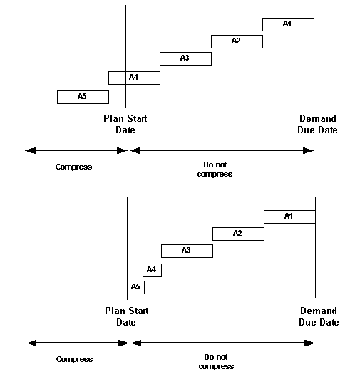

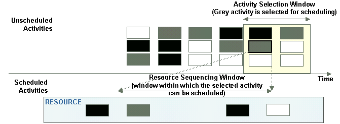

Enforce demand due date plans require the planning engine to meet demand due dates. If it cannot meet the demand on time using existing capacity, it must overload resources and suppliers.
The planning engine backward schedules the activities from the demand due date. If there is not enough time to complete the supply order by the demand due date, the planning engine reaches the plan start date before it is finished scheduling the order. It then follows a certain process to reschedule the operations, see Identifying Root Causes of Late Demand.
The planning engine manage the slacks (overloads) as it schedules, so that it can overload the activities that are constraining the schedule the most and reasonably schedule the other activities. As planners can easily identify the actual constraining activities, they can work to improve the overall schedule.
To manage the slacks, it assigns each activity of a supply order a time window and only schedules the activity within that window. This allocates to each activity in a supply order its proportion of the slack. Otherwise, the full scheduling of beginning or ending activities in the routing can use up most of the time. Then, other activities appear compressed against the plan start date or demand due date with high slack even thought they are not necessarily the most constraining activities.
When faced with a need to overload, the planning engine:
Does not compress operations beyond their minimum durations unless the demand is due very close to the plan start date
Tends to overload resources at times when they are unavailable rather then compressing operations into small gaps of available time
Attempts to create resource overloads evenly distributed in time rather than creating higher resource overloads closer to the plan start date
This diagram shows an example of scheduling a four operation (operation numbers 10, 20, 30, 40) supply order without using scheduling windows and with using scheduling windows. The filled in boxes represent times when a resource is unavailable.
When not using scheduling windows, the planning engine schedules operations 40 and 30 for their complete times and during times when their resources are available and then severely compresses operations 20 and 10 to avoid their being past due.

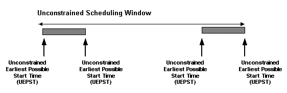

The unconstrained scheduling window of an operation occurs between these points:
Unconstrained Earliest Possible Start Time (UEPST): The planning engine never schedules an operation to start earlier than this time. If it did so, it would compress upstream operations beyond their minimum durations.
The Unconstrained Earliest Possible Completion Time (UEPCT) = UEPST + Minimum duration of operation
Unconstrained Latest Possible Completion Time (ULPCT) : The planning engine never schedules an operation to end later than this time. If it did so, it would compress downstream operations beyond their minimum durations.
Unconstrained Latest Possible Start Time (ULPST) = ULPCT - Minimum duration of operation
This diagram shows the unconstrained scheduling window for an operation.
Unconstrained Operation Scheduling Window

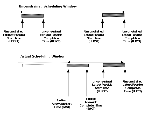

The actual scheduling window of an operation occurs between these points:
Earliest Allowable Completion Time (EACT): The planning engine never schedules an operation to end earlier than this time. An earlier completion would take time from other activities and possibly cause them to have less slack than is proportional for them.
The planning engine calculates it from information gathered while performing unconstrained scheduling. It is the ratio of the minimum processing time needed by the operation to the total minimum processing time along the path of minimum slack upstream from the operation. This ratio indicates how much of the slack we can allow the operation to use. You can influence the calculation of EACT and the length of the actual scheduling window by setting profile option MSO: EDD Scheduling Window Control.
Earliest Allowable Start Time (EAST) = EACT - (UEPCT - UEPST)
Unconstrained Latest Possible Completion Time (ULPCT) of the unconstrained scheduling window.
This diagram shows the unconstrained scheduling window and the actual scheduling window for an operation.
Unconstrained and Actual Operation Scheduling Windows

You can control some functions of the planning engine operation scheduling in enforce demand due date plans.
To instruct the planning engine how to proceed when it finds an operation would start or end in the past, set profile operation MSO: Lead Time Control. With either setting, there may be supplier and resource overloads.
If you select Violate minimum processing times to meet demand due date (the default), the planning engine compresses operations into less time than the maximum assigned units processing time to meet the demand due date. In addition, it issues an Order with insufficient lead time exception message and a Requirement with insufficient lead time exception message. It retains the schedules of the future operations within their actual scheduling windows.
This diagram shows a series of operations to be scheduled. Operations A4 and A5 are wholly or partially in the past. With option Violate minimum processing times to meet demand due date set, the planning engine compresses operations A4 and A5 to retain the demand due date.
Violate Minimum Processing Times Example
If you select Do not violate minimum processing times, the planning engine does not compress operations, calculates a new demand due date (the demand satisfied date), and reschedules the operations according to the new demand due date. The time between the original demand due date and the new demand due date is the minimum possible days late.
This diagram shows a series of operations to be scheduled. Operations A4 and A5 are wholly or partially in the past. With option Do not violate minimum processing times set, the planning engine calculates new demand due date and reschedules the operations for that date.
Do Not Violate Minimum Processing Times Example
To instruct the planning engine to make use of capacity breaks (non-work times), set profile option MSO: Use Breaks in Calculation of Unconstrained Scheduling Windows.
If you select Yes (the default), the planning engine calculates UEPST, UEPCT, ULPST and ULPCT taking capacity breaks into account. It does not include resource or supplier non-work time when laying out activity time and never sets any of these time points to a non-work time.
If you select No, the planning engine calculates UEPST, UEPCT, ULPST and ULPCT ignoring capacity breaks. It does include resource or supplier non-work time when laying out activity time and may set any of these time points to a non-work time.
Select No to encourage the planning engine to schedule work during resource breaks to meet demand due dates; select Yes to discourage it from this effort.
If set to Yes, the planning engine may schedule a downstream operation during a resource's non-working time. This results in more available time available for upstream operation scheduling; the planning engine could schedule upstream operations beyond their ULPCT.

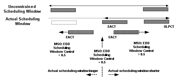

To control the planning engine calculation of Earliest Allowable Completion Time (EACT), set profile option MSO: EDD Scheduling Window Control. The planning engine calculates the optimal size for each operation's actual scheduling window as proportional to its minimum duration and whether or not it is in the critical path. You control the actual size of the actual scheduling window by entering a number between 0 and 1.
If you enter 0.5 (the default), the planning engine sets the actual scheduling window duration to the optimal size.
If you enter an number lower than 0.5, the actual scheduling window becomes larger than the optimal size. This could cause more resource overloads on upstream resources as compared to downstream resources.
If you enter an number higher than 0.5, the actual scheduling window becomes smaller than the optimal size. This could cause more resource overloads on downstream resources as compared to upstream resources.
This diagram shows the effect of different actual scheduling window sizes.
Actual Scheduling Window Sizes

Engineering changes to an item or modifications to bills of material are implemented through Engineering Change Orders (ECO). These planned changes affect the dependent demand calculations and the orders rescheduled or created by the planning process. The use-up date is the date when the on-hand quantity for an item will be exhausted based on projected gross requirements and receipts. You can plan to use up your current item before introducing engineering changes by accepting the use-up effectivity date recommended by ASCP.
When you define a revised item using an ECO, you can specify whether the planning process should recommend a suggested effective date for the revised item. If you do so, Oracle ASCP recommends a use-up date for the current item. The use-up date is calculated by applying on-hand quantity in inventory (supply) against gross requirements (demand). It is the date on which all supplies for the current item will be used up (on hand will be zero).
The ECO use-up effectivity date is calculated by adding one working day to this, as shown in the following figure.
ECO Use-up Effectivity Date

This diagram illustrates that when Oracle Advanced Supply Planning schedules sequence dependent activities, the planning engine first chooses an unscheduled activity from the activity window. From this group of activities, the planning engine chooses an activity that best fits with the activities that are already scheduled so that a new changeover can be avoided.
Selecting Activities
After choosing the activity, the planning engine looks for another activity with the same setup type in the resource sequencing window. The window ends at the latest possible time for running the activity and filling the demand. The activity is then scheduled at a time that best balances the objectives of minimizing changeovers and minimizing demand lateness.
The length of the resource sequencing window affects the length of the cycle for each setup type. The larger the resource sequencing window, the longer the time spent by the resource on each setup type before changing to another setup type. Making the resource sequencing window too large might result in demand priorities not being fully respected while scheduling,
While this example refers to "backward" scheduling, the same principle applies when forward scheduling when demands are late.

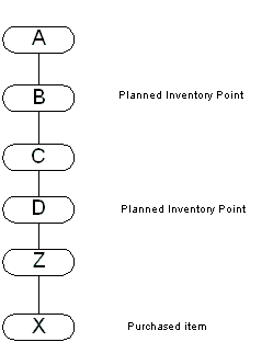

You can specify if the item can be stocked by specifying it as an Inventory Point. You choose the PIP Attribute for an item at Item-Organization level.
If you designate the item as an Inventory Point item, it suggests that the material can be stored at this item level without the fear of loosing the materials or loosing quality characteristics of the materials. PIPs generally point to major stocking phases in manufacturing cycle.
If you have an existing job and it does not have any demands to peg to, you can move the job to the next PIP level. For example, the figure below shows a BOM, where item Z is a purchased item that gets processed to become item A. It goes through several stages of manufacturing, changing the item number several items as mentioned on the BOM.
Assume that you have demand for item A, you have purchased item Z, and are working on creating item D using a discrete job. If for some reason, the end demand for A disappears, you can continue scheduling the discrete job for D instead of recommending a cancellation. You can allocate the discrete job to other valid demands (sales orders, forecasts, order modifiers) if they exist. Please note that allocating unconsumed supplies to other valid demands is the standard Oracle APS behavior.
Once you start a job, your goal is to reach the next Inventory Point, that is (referring to the previous figure), you need to generate and schedule orders for items C and B. If you fail to do so, you run the risk of scrapping or reworking the discrete job for item D. This means that you would have to introduce fictitious demand at a PIP so that the system would generate and schedule planned orders for item C and B.
If the item at the PIP has an order modifier, you can add demand at the PIP that honors the order modifiers. In the previous example, you have a Discrete Job for 15 units at item D, you do not have a committed end demand for it, and item B has an the following order modifier: the Minimum Order Quantity is set to 30 units. For this example, Oracle APS will add a fictitious demand of 30 units for Item B, which is a PIP. If you have order modifiers for an item, you will have excess supplies, and therefore, you can expect excess supplies at lower levels in the Bills of Material.
Oracle APS adds the necessary amount of fictitious demand so that the jobs and planned orders are scheduled with their normal lead-times (cumulative lead-time). If orders need to be created at different levels (items), the cumulative lead-times are added for all such items. If the lead-times for item Z and D are 4 and 3 days respectively, the fictitious demand is added 7 days from the due date of the job assuming that the job is for item D.
You may have jobs opened at two or more levels that peg to each other. In such cases, the amount of fictitious demand added is equal to the maximum quantity of the jobs that needs to be moved to PIPs. The fictitious demand is not just a sum total of all the open unpegged jobs. For example, using Figure Bill with Inventory Point as a template, you could have two jobs pegged to each other: a job for item D for 10 units and a job for item C for 5 units. If there is a cancellation of end item demand from item A, the fictitious demand would be for 10 units. This means there would be extra supplies (planned orders) created at item C for 5 units. You can analyze item excess exceptions to figure out any excess.
On-hand quantities for items below a PIP may affect the logic of moving unpegged jobs to a PIP. Assume that you have 10 units on hand for Item C and you have an unpegged job for Item D for 5 units. The normal logic for PIP is to add 5 units of fictitious demand at Item B, which is the next PIP. Because 5 units of fictitious demand is smaller than the 10 units that are on-hand at Item C, you will not be able to pass the demand to the job at Item D. This affects the movement of the job to the next PIP.
Oracle APS assumes that you will issue any on- hand material present at levels below a PIP to jobs at higher levels. This is logical as you do not want to have any inventories sitting below a PIP.
It is possible to have multiple Inventory Points in a BOM as shown in the next diagram:
Bill with Multiple Inventory Points
If you have a job started at item Z and loose the demand, Oracle APS generates and schedules orders to reach Item D including item D. If you have started a discrete job for item C and loose the end demand, Oracle APS generates and schedules orders to reach item B including item B.
PIP logic schedules jobs to the next PIP even without a valid demand for it instead of canceling it. The idea is to reach a point in the bill of materials where materials could be stored without the fear of loosing them. Firm jobs are also scheduled similar to non-firm jobs in order to aid the process of scheduling materials to reach a PIP.
Firm jobs by nature are not open to rescheduling; hence, any scheduling of higher level items to reach the next PIP need to work around the scheduling that is done for firm jobs. For example, you might have a firm job for item Z due on day 25 and the demand that the firm job was pegged to does not materialize. This leaves you with the task of moving materials being processed by the firm job to the next PIP. Because you cannot change the scheduling already done for firm job, you must work around the firm job schedule. The planned order generated for item D to help the process of moving materials from firm job to the next PIP is scheduled such that it starts on D25. If item D has a lead-time of 5 days, the planned order start for item C is scheduled on D30.
Oracle ASCP treats jobs with statuses of Released and Unreleased in the same manner. Jobs with both these statuses are subject to rescheduling to aid the process of scheduling materials to reach the next PIP.
Scheduling of jobs even after cancellation of committed demand is an exception condition. In the application, you can see scheduling of such orders as exceptions. The exception Orders Moved to Next PIP Level is generated for each order moved to the next PIP. Please note that this exception is created only for orders that are completely pegged to the fictitious demand.
