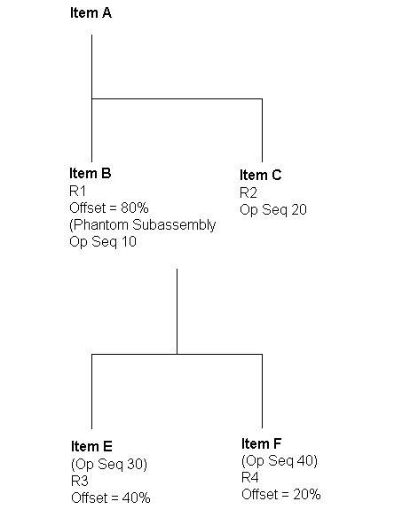

Phantoms are non-stocked assemblies that let you group together material needed to produce a subassembly. Oracle ASCP explodes requirements through a phantom subassembly to the components as if the components were directly tied to the parent assembly. No planned orders are generated for phantom assemblies. Routings for phantom items are used to generate resource requirements. However, the planning engine does not support phantom routings for constrained plans.
Phantom Routings are included for all phantom items in an organization based on the settings of the Organization level parameter use phantom routings in Oracle Bills of Material. An additional parameter inherit phantom operation sequence set at the inventory organization level in Oracle Bills of Material determines whether components of phantom items will retain their operation sequence or inherit them from the parent
Note: The combination of use phantom routings = Y and inherit phantom operation sequence = N is not supported.
The following figure and table summarize the different behavior of a phantom item and its components associated with settings of the two parameters, according to the example that follows.
Bill of Material Structure for Assembly A
For more details, seeDefining Bills of Material Parameters, Oracle Bills of Material User's Guide and Phantoms, Oracle Bills of Material User's Guide.
Oracle Shopfloor Manufacturing (OSFM) does not use the phantom routing's operation sequence for the exploded phantom component requirements. The planning engine uses value No for organization parameter Inherit phantom op seq when it creates planned orders for Oracle Shopfloor Manufacturing (OSFM) lot based jobs.

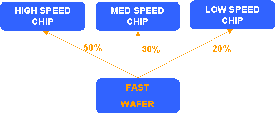

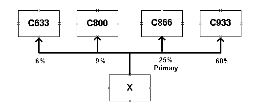

In some production environments, an item may turn into one or more parent items depending on factors such as process control, test results, and raw material quality. The parent items are called co-products.
Both Oracle Shop Floor Manufacturing (OSFM) and Oracle Process Manufacturing use co-products
Identifying Co-products
You identify co-products as a bill of material structure. In this diagram, assembles A, B, and C are co-products produced from raw material X. The percentage figures represent the expected mix of production of the co-products.
Co-products
Co-products and Order Promising
Order promising considers co-product supplies for order promising as long as the demand is later than the co-product supply date. Using this product structure:
On day 25, you have scheduled receipts for 10 item A, 6 item B, and 4 item C
On day 10, you take a sales order against item B that is due on day 35. Order promising considers the scheduled receipt for quantity 6 as available to satisfy the sales order.
On day 10, you take a sales order against item C that is due on day 20. Order promising does not consider the scheduled receipt for quantity 4 on day 25 as available to satisfy the sales order.
On day 10, you take a sales order against item A for quantity 15 due on day 25. Order promising considers the scheduled receipt for quantity 10 as available to satisfy the sales order; however, there is a shortage of quantity 5
Capable-to-promise calculates that you need 10 item X to result in 5 item A (production of quantity 1 of item X results in production of quantity 0.5 of item A, 5 / 0.5 = 10)
If there is enough item X available to result in 5 item A by day 25, order promising creates supply against item A for quantity 5 due on day 25, supply against item B for quantity 3 due on day 25, and supply against item C for quantity 2 due on day 25.

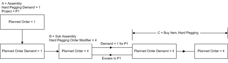

Oracle Project Manufacturing is integrated with Oracle ASCP. Oracle ASCP supports constraint-based supply chain planning and optimization with online simulations for Engineer-to-Order (ETO) manufacturing typical in the Aerospace and Defense Industry. It features the following:

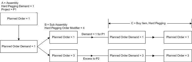

The hard and soft pegging feature is fully supported by Oracle ASCP. An item's attribute can be set to any of the following pegging levels which are elaborated below:
The planning process allocates supply at the project or project-task level (or Seiban) to demand at the project or project-task level (or Seiban) according to the reservation level set in the plan level options.
All reservations of supply to demand records is for a single item. Common, nonproject supply is used to satisfy project demand. For a soft pegged demand, excess project supply (or common supply) is always available for another project's demand.

Example
Consider an assembly item A with sub assembly item B, which uses component item C.
The quantity per assembly for components B and C is 1.
An order quantity of 1 is placed for item A against project P1.
The planning system generates a planned order demand of 1 for item B. The order multiplier for item B has been set to 4. This results in a planned order of 4 for item B.
The planning system generates a planned order demand of 4 as well as a planned order of 4 for item C. The system splits the planned order based on the project codes:
1 - Planned order quantity of 1 pegged to project P1.
2 - Planned order quantity of 3 pegged to excess (no project code).
If the planned order for excess is released without a project code it will be rejected in purchasing (release fails, no purchase order will be created).
Project with demand = P1
Default project code = P2
Scenario 1
The planned orders are split into two parts:
The planned order quantity of 1 is pegged to the project with demand, which is P1.
The planned order quantity of 3 is pegged to excess with the default project code, which is P2.
Explanation:
The total supply order is 4 based on the order modifier. The supply is split into two planned orders because of the fact that some part of the supply is pegged to the project demand and some part of the supply is pegged to excess.
In case of soft pegging, a planned order is not referenced to a project.
Default Project = P1
Scenario 2
The planned orders are not split because the default project is the same as the project with demand.

The planning engine plans for the situation in which you produce the same product at multiple operations.
Consider these co-product issues when you select plan type. All plan types simultaneously plan all items to utilize co-product supplies created on the same day:
Unconstrained plans use the process (formula, routing) with the highest priority and lowest preference that is effective for the date and quantity range
Constrained plans with decision rules respect effective date and maximum quantity ranges. They use the process with the highest priority and lowest preference that has adequate capacity.
Optimized plans respect effective date and maximum quantity ranges. However, they select the best process (formula and recipe) that both respects capacity constraints and minimizes inventory and costs. You must specify costs for the alternate bill of material/routing pairs.
While constrained plans with decision rules and optimized plans consider minimum quantity ranges, the results may not be minimized. The optimization process may select a process that violates the minimum quantity condition but that the planning engine later corrects. In this case, the results honor the process quantities but may not have chosen the best process.

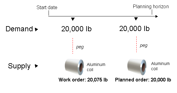

Supply Excess Tolerance
If there is a supply with quantity slightly larger than a demand, the planning engine pegs the entire supply quantity, including the excess quantity to the demand. It does not peg the excess to another demand. Use this tolerance if you typically accept overages within a percentage of the demand quantity, for example, because of yield fluctuations.
For example:
You have an item that you make in lots of 20,000
There is a demand for quantity 20,000
The item has tolerance percentage of 10. Therefore, any supply for the same item that has quantity 21,999 or less is eligible to satisfy the demand [20,000 + (20,000 * 0.1) – 1]
There is a work order for the item with quantity 20,075
The planning engine records that the supply of quantity 20,075 satisfies the demand of quantity 20,000
It pegs the entire quantity of 20,075 to the demand for 20,000. It does not peg the excess supply quantity of 75 to any other demand. It recommends a planned order for the full quantity of the next demand of 20,000.
To instruct the planning engine to use supply excess tolerance for an item, either:
Enter a percent value in profile option MSC: Minimum Supply/Demand Percent for Pegging.
Enter values for it in the Item Attributes Mass Maintenance form as item-organization attribute Excess Tolerance Percent.
If you want the planning engine to exclude planned orders from supply shortage tolerance and supply excess tolerance, set profile option MSC: Apply shortage and excess tolerance percentages to planned orders to No.
A value in this item attribute overrides the setting of profile option MSC: Minimum Supply/Demand Percent for Pegging. You can control whether this tolerance applies to planned orders by setting a value for profile option MSC: Apply shortage and excess tolerance percentages to planned orders.

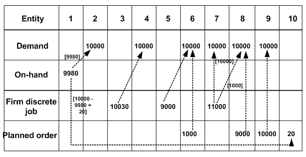

Example 1: Shortage and Excess Tolerance Percents
In this example:
Shortage Tolerance Percent = 0.6
Excess Tolerance Percent = 0.4
For a demand quantity of 10000:
Shortage Tolerance Quantity = 10000 * 0.6 / 100 = 60
Excess Tolerance Quantity = 10000 * 0.4 / 100 = 40
The on-hand quantity 9980 is short by quantity 20 to satisfy the demand on day 2 for quantity 10,000.
The shortage is within the supply shortage tolerance [20 < 60].
The planning engine:
Pegs the on-hand quantity 9800 to the demand on day 2 for quantity 10,000
Places the shortage quantity 20 as a planned order at the end of the planning horizon on day 10
The discrete job due on day 3 for quantity 10,300 can satisfy the demand on day 4 for quantity 10,000 but is over by quantity 30.
The excess is within the supply excess tolerance [30 < 40].
Pegs the discrete job due on day 3 for its entire quantity 10,300 to the demand on day 4 for quantity 10,000
Does not peg the excess quantity 30 to any other demand
The discrete job on day 2 for quantity 9000 is short by quantity 1000 to satisfy the demand on day 6 for quantity 10,000.
The shortage is outside the supply shortage tolerance [1000 > 60].
Pegs the discrete job on day 2 for quantity 9000 to the demand on day 6 for quantity 10,000
To make up the shortage, recommends a planned order due on day 6 for quantity 1000
The discrete job on day 7 for quantity 11,000 can satisfy the demand on day 7 for quantity 10,000 but is over by quantity 1000.
The excess is outside the supply excess tolerance [1000 > 40].
Pegs the discrete job on day 7 for 10,000 of its quantity 11,000 to the demand on day 7 for quantity 10,000
Pegs the discrete job on day 7 for 1000 of its quantity 11,000 to the demand on day 8 for quantity 10,000

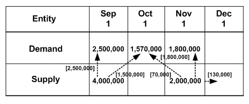

Example 2: Small Demands Delay Fulfillment
In this example:
Fixed Days Supply = 40
Fixed Lot Multiplier = 1,000,000
Unsatisfied Demand Factor = 0.1
The first fixed days supply period includes the demands on September 1 for quantity 2,500,000 and on October 1 for quantity 1,570,000. The total demand for this period is 4,070,000 [2,500,000 + 1,570,000].
The planning engine calculates a planned order of 5,000,000 to:
Completely satisfy the demand in the period
Honor the fixed lot multiplier
However, the planning engine detects that this item is subject to small demands delay fulfillment. Recommending production of quantity 5,000,000 due on September 1 would leave excess on-hand of quantity 70,000 from September 1 until November 1.
The unsatisfied demand factor against quantity 1,000,000 is 100,000 [1,000,000 * 0.1] This quantity 70,000 is within the unsatisfied demand factor [70,000 < 100,000 or 70,000 / 1,000,000 = 0.07 and 0.07 < 0.1].
Considers the quantity 70,000 as a small demand
Recommends a planned order due in September 1 for quantity 4,000,000
The demand due on September 1 should be completely satisfied on September 1.
The demand due on October 1 should be partially satisfied on September 1 with a shortage of quantity 70,000.
There is a cumulative unsatisfied demand of quantity 70,000 carried forward to period 2.
The second fixed days supply period includes the demand on November 1 for quantity 1,800,000 and the cumulative unsatisfied demand of quantity 70,000. The total demand for this period is 1,870,000.
The planning engine calculates a planned order of 2,000,000 to:
However, the planning engine detects that this item is subject to small demands delay fulfillment. Recommending production of quantity 2,000,000 due on September 1 would leave excess on-hand of quantity 130,000 from November 1 until January 1.
The unsatisfied demand factor against quantity 1,000,000 is 100,000 [1,000,000 * 0.1] This quantity 130,000 is outside the unsatisfied demand factor [130,000 > 100,000 or (70,000 + 1,800,000) / 1,000,000 = 1.87 and 1.87 > 0.1].
Does not consider the quantity 130,000 as a small demand
Recommends a planned order due in November 1 for quantity 2,000,000
The demand due on October 1 should be completely satisfied late on November 1.
The demand due on November 1 should be completely satisfied on November 1.
There is excess on-hand for quantity 130,000 on November 1 carried until the next period.

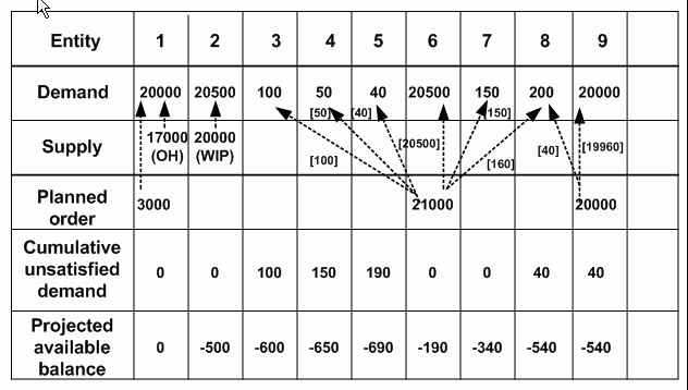

Example 3: Combination of Shortage Tolerance Percent and Unsatisfied Demand Factor
In this example:
Fixed Lot Multiplier = 1000
Unsatisfied Demand Factor = 0.25
Shortage Tolerance Percent = 10% = 0.1
Profile option MSC: Apply shortage tolerance percent to planned orders = No
Day 1:
Shortage = 3000 [Demand on day 1 – Supply available on day 1 = 20,000 – 17,000]
Shortage tolerance quantity = 2000 [Demand on day 1 * Shortage Tolerance Percent = 20,000 * 0.1]
The shortage is more than the shortage tolerance quantity [3000 > 2000]
Consider the shortage not satisfied and create a planned order for quantity 3000 due in day 1
Day 2:
Shortage = 500 [Demand on day 2 – Supply available on day 2 = 20,500 – 20,000]
Shortage tolerance quantity = 2050 [Demand on day 1 * Shortage Tolerance Percent = 20,500 * 0.1]
The shortage is lower than the shortage tolerance quantity [500 < 2050]
Consider the shortage satisfied and do not create a planned order
Day 3:
Shortage = 100 [Demand on day 3 – Supply available on day 3 = 100 – 0]
Cumulative unsatisfied demand = 100 [Previous cumulative unsatisfied demand + Shortage on day 3 = 0 + 100]
Unsatisfied demand quantity = 250 [Fixed lot multiplier * Unsatisfied demand factor = 1000 * 0.25]
The cumulative unsatisfied demand is lower then the fixed lot multiplier [100 < 1000]

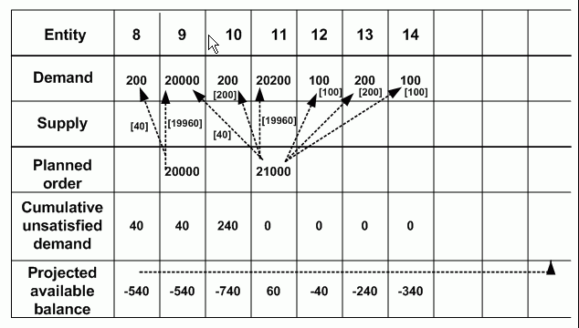

The cumulative unsatisfied demand is lower than the unsatisfied demand quantity [100 < 250]
Consider the cumulative unsatisfied demand subject to small demands delay fulfillment and do not create a planned order
Day 4:
Shortage = 50 [Demand on day 4 – Supply available on day 4 = 50 – 0]
Cumulative unsatisfied demand = 150 [Previous cumulative unsatisfied demand + Shortage on day 3 = 100 + 50]
The cumulative unsatisfied demand is lower then the fixed lot multiplier [150 < 1000]
The cumulative unsatisfied demand is lower than the unsatisfied demand quantity [150 < 250]
Day 5:
Shortage = 40 [Demand on day 5 – Supply available on day 5 = 40 – 0]
Cumulative unsatisfied demand = 190 [Previous cumulative unsatisfied demand + Shortage on day 3 = 150 + 40]
The cumulative unsatisfied demand is lower then the fixed lot multiplier [190 < 1000]
The cumulative unsatisfied demand is lower than the unsatisfied demand quantity [190 < 250]
Day 6:
Shortage = 20,500 [Demand on day 6 – Supply available on day 6 = 20,500 – 0]
Cumulative unsatisfied demand = 20,690 [Previous cumulative unsatisfied demand + Shortage on day 3 = 190 + 20,500]
The cumulative unsatisfied demand is higher than the unsatisfied demand quantity [20,690 > 250]
Consider the cumulative unsatisfied demand not subject to small demands delay fulfillment and create a planned order for quantity 21,000 [Cumulative unsatisfied demand rounded to closest multiple of fixed lot multiplier = 20.690 rounded to closest multiple of 1000] due on day 6 There is a planned order excess of quantity 310 available for future days
Day 7:
Shortage = -160 [Demand on day 7 – Supply available on day 7 = 150 – 310]
Cumulative unsatisfied demand = -160 [Previous cumulative unsatisfied demand – Planned order excess + Shortage on day 7 = [-310 + 150]
There is no cumulative unsatisfied demand so do not create a planned order
There is a planned order excess of quantity 160 [310 - 150] available for future days
Day 8:
Shortage = 40 [Demand on day 8 – Supply available on day 8 = 200 – 160]
Cumulative unsatisfied demand = 40 [Previous cumulative unsatisfied demand – Planned order excess + Shortage on day 8 = [-160 + 200]
The cumulative unsatisfied demand is lower then the fixed lot multiplier [40 < 1000]
The cumulative unsatisfied demand is lower than the unsatisfied demand quantity [40 < 250]
Day 9:
Shortage = 20,000 [Demand on day 9 – Supply available on day 9 = 20,000 – 0]
Cumulative unsatisfied demand = 20,040 [Previous cumulative unsatisfied demand + Shortage on day 3 = 40 + 20,000]
The cumulative unsatisfied demand is higher than the unsatisfied demand quantity [20,040 > 250]
Consider the cumulative unsatisfied demand not subject to small demands delay fulfillment and create a planned order for quantity 20,000 [Cumulative unsatisfied demand rounded to closest multiple of fixed lot multiplier = 20,040 rounded to closest multiple of 1000] due on day 6
Of the planned order for quantity 20,000: Of the planned order for quantity 20,000:
Quantity 40 satisfies the cumulative unsatisfied demand from day 8
Quantity 19,660 [20,000 – 40] satisfies the shortage for day 9
There is a now a cumulative unsatisfied demand of quantity 40 remaining against day 9
Day 10:
Shortage = 200 [Demand on day 10 – Supply available on day 10 = 200 – 0]
Cumulative unsatisfied demand = 240 [Previous cumulative unsatisfied demand – Planned order excess + Shortage on day 9 = [40 + 200]
The cumulative unsatisfied demand is lower then the fixed lot multiplier [240 < 1000]
The cumulative unsatisfied demand is lower than the unsatisfied demand quantity [240 < 250]
Day 11:
Shortage = 20,200 [Demand on day 9 – Supply available on day 9 = 20,000 – 0]
Cumulative unsatisfied demand = 20,440 [Previous cumulative unsatisfied demand + Shortage on day 3 = 240 + 20,200]
The cumulative unsatisfied demand is higher than the unsatisfied demand quantity [20,440 > 250]
Consider the cumulative unsatisfied demand not subject to small demands delay fulfillment and create a planned order for quantity 20,000 [Cumulative unsatisfied demand rounded to closest multiple of fixed lot multiplier = 20,440 rounded to closest multiple of 1000] due on day 11
Quantity 40 satisfies the planned order shortage from day 9
Quantity 200 satisfies the cumulative unsatisfied demand from day 10
Quantity 19,760 [20,000 - 40 - 200] satisfies the shortage for day 11
There is a now a cumulative unsatisfied demand of quantity 440 [20,200 – 19,760] remaining against day 11

MSC: Minimum Supply/Demand Percent for Pegging: 0.0018
Excess Tolerance Quantity: 1836 [10200 * 0.0018]
Profile option MSC: Apply shortage and excess tolerance percentages to planned orders is No:
Create six planned orders each quantity 2000
Ignore shortage tolerance quantity
Use them to satisfy Demand 1
Excess is 1800 [12000 - 10200]
Apply excess to satisfy Demand 2
Profile option MSC: Apply shortage and excess tolerance percentages to planned orders is Yes:
Use shortage tolerance quantity
Use five of them to satisfy Demand 1. Demand 1 supply is 10000. The shortage 200 is within the shortage tolerance quantity 204.
Excess is 2000 [12000 - 10000]

In the semiconductor, electronics and metals industries, the focus is the primary component that is processed to become individual products. For example, A Fast Wafer may become a Low Speed Chip, Medium Speed Chip, or High Speed Chip.
Wafer-chi: Primary bill of material
Use the Define Co-products form to specify co-products made from the primary component. Then, click Split Percentages and enter the percentage distribution for each co-product on the Define Time Phased Split Percentages form. You can specify effectivity date ranges for percentage distributions; the planning engine uses the percentage distributions effective on the plan launch date throughout the planning horizon.
You can build the same products from different components by using alternate bills of material/routing pairs during co-products setup. For example:
Primary: Fast wafer component > Low Speed Chip 20%, Medium Speed Chip 30%, High Speed Chip 50%
Alternate 1: Fast wafer component > Low Speed Chip 5%, Medium Speed Chip 15%, High Speed Chip 80%
Alternate 2: Medium wafer component > Low Speed Chip 30%, Medium Speed Chip 60%, High Speed Chip 10%
This diagram shows alternate bill of material 1. The process uses the same Fast Wafer as the primary bill of material. However, the process is tuned to produce different percentages of co-products from those the primary bill of material.
Wafer-chip: Alternate bill of material 1
This diagram shows alternate bill of material 2. The process uses a different wafer--Med Wafer--from the one in the primary bill of material. It produces different percentages of co-products from those the primary bill of material.
Wafer-chip: Alternate bill of material 2

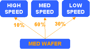

The planning engine can use alternate bill of material/routing pairs to resolve resource and material constraints. It may partially satisfy a later demand with a co-product produced from supply from an earlier demand, and then satisfy the remaining quantity with a later supply against that co-product. For example:
Medium Speed Chip has demand due for quantity 60 on day 1
High Speed Chip has demand due for quantity 100 on day 2
The planning engine creates a planned order against Medium Speed Chip, the first demand, for quantity 60 on day 1 using bill of material/routing pair ALT2. This production should create a co-product supply against High Speed Chip for quantity 10 on day 1. The planning engine then creates a planned order against High Speed Chip for quantity 90 on day 2.
| Item | Percent/Quantity | Day 1 | Day 2 | Day 3 |
| High Speed Chip | 10% | - | -100 | - |
| Medium Speed Chip | 60% | -60 | - | - |
| Low Speed Chip | 30% | - | - | -40 |
| High Speed Chip | - | 10 (co-product supply) | 90 (planned order) | - |
| Medium Speed Chip | - | 60 (planned order) | 540 (co-product supply) | - |
| Low Speed Chip | - | 30 (co-product supply) | 270 (planned order) | - |
| Demand for Medium Wafer | 0.01 | -1 | -9 | - |

This diagram shows a co-product bill of material.
Co-product Bills of Material
All co-products are marked Enforce Integer Req either Up or Down.
The planning engine receives demand for 25 C933.
It calculates requirements for X as 42 [25 * 0.6 = 41.666, round to 42].
It calculates requirements for the co-products:
C633: 2.49 [41.666 * 0.06]
C800: 3.74 [41.666 * 0.09]
C866: 10.41 [41.666 * 0.25]
C933: 25
It rounds down requirements for the co-products:
C633: 2
C800: 3
C866: 10
C933: 25
It calculates the difference between demand and supply as 2 less demand than supply [42 - (25 + 10 + 3 + 2)].
It increases the primary component by 2 to make the co-product requirements equal the supply of 42:
C633: 2
C800: 3
C866: 12
C933: 25
If the demand is for the primary co-product, the planning engine rounds down all of the other co-products and randomly selects one of them to increase to balance supply and demand. It does not increase the primary co-product.

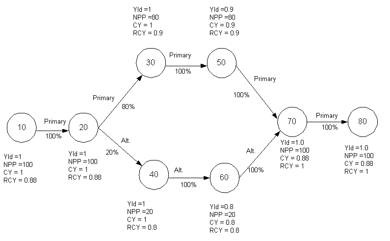

Alternate ways of producing an item often demands flexible definition of Routings. Network Routings give you the flexibility of defining multiple manufacturing paths. Network Routings are defined using Oracle OSFM at the source. When you set up Network Routings, you can specify the estimated percentage of the orders that need to be processed on a specific path. This is called the planning percent.
You can collect the Network Routings into the planning server using the APS Collection program. You can snapshot the Network Routings and use them to calculate and schedule resource requirements for existing Lot-Based Jobs and planned orders when you run a plan. You can choose to schedule orders using Network Routings in three ways:
Primary Path (default)
Planned Percent
Optimize
To make your selection, navigate to Setup and use Parameters form at ASCP. You can choose the scheduling method at the organization level by setting OSFM Network Scheduling Method parameter for your organization.
If you select Planned Percent or Optimize, run concurrent process Calculate operation yields on the source against the Oracle Shop Floor Management (OSFM) routings on the source.
This diagram shows Network Routings.
Network Routing
As the name suggests, you can schedule orders on primary path. In this case, Oracle ASCP calculates the Reverse cumulative yields and Net Planning Percent based on the Primary path.
This method takes advantage of accumulated percentages derived from user-specified planning percentage on the Network Routing. Referring to the figure, the resource requirements at operation sequence 20 is calculated for 100* Net Planning Percent at operation sequence 20. Considering an order of 100 units, the resource requirements at operation sequence 40 is calculated for 8 units, and so on.
With this method, you can analyze the current conditions on the shop floor, intelligently choose alternate paths, and determine the quantity that needs to be processed on various paths. Given a specific order, you should be able schedule the order on the primary path. If you run into capacity constraints on the primary path, you should be able to schedule as much of the order as possible using the primary path and schedule the rest of the order on alternate paths. If you happen to go to an alternate path, the objective still is to get back to the primary path as soon as possible. For example, if you schedule resources at 40, you should seek the path 50, 60, 80 instead of 70, 80 or 50, 70, 80. Do not use this method with unconstrained plans.
You can influence the decision of using alternate paths as opposed to primary path or vice versa using system level profile options. Oracle ASCP provides profile options to influence scheduling decision. Oracle ASCP schedules the orders based on the availability of resources in a window defined by the following profile options:
MSO: Network Routing Cycle Time coefficient, is a multiple of the longest path of the network; the longest path is based on theoretical durations.
