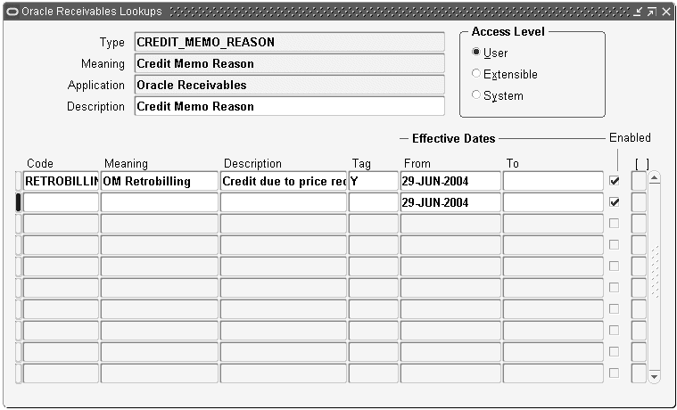

Create an unique reason code for credits. This is optional, but recommended because it allows you to query the credit lines and credits in Receivables using the reason code. Navigate to the Oracle Receivables Lookups window. Order Management > Setup > QuickCodes > Receivables.
Create a new Credit Memo Reason Code to use for retrobilling.
Oracle Receivables Lookups Retrobilling
