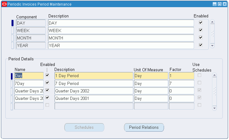

Use periodic periods to create different types of periods for billing periods or charge periods on entering standing charge agreements. If periods with different components are used as billing periods and charge periods on a given standing charge agreement, they must be set up as related periods on the Period Relation window.
To set up billing and charging periods:
Navigate to the Periodic Invoices Period Maintenance window.
Select the required component.
Enter a name and description for the period.
Select the unit of measure.
Enter the multiplication factor required.

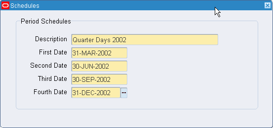

To define quarter days, click Schedules.
Note: The factor must be set to zero to access the Schedules window.
In the Schedules window, enter the quarter dates.
Note: All date fields must be entered and be in the same year.

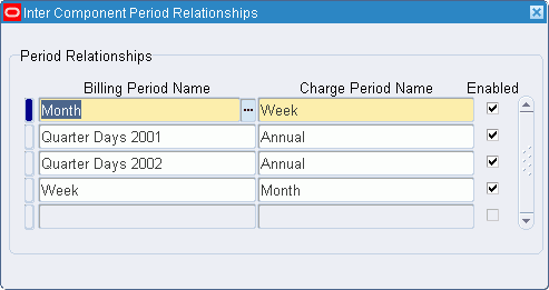

Close the Schedules window and click Period Relations.
Note: Set up period relations if periods using different components are used together.
Enter the billing period name and charge period name.
