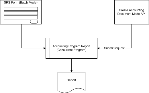

The Create Accounting program executes the accounting program API for a single document or for a batch of documents. The program has input parameters that determine the execution mode and the selection criteria for events. Some of the parameters are specific to batch mode and some are specific to document mode.
The Create Accounting program is registered as a concurrent program. It can be submitted as a request from the standard request submission form for batch mode accounting. The figure below shows the create accounting submission process submitted by the concurrent program and the Create Accounting Document Mode API.
Create Accounting Program Submission

The Financial Services Accounting Hub has defined two APIs to submit the Create Accounting program for a single document. These APIs can be called to execute the Create Accounting program synchronously or asynchronously as a concurrent request.
PROCEDURE accounting_program_document
(p_event_source_info IN xla_events_pub_pkg.t_event_source_info
,p_application ID IN NUMBER DEFAULT NULL
,p_entity_id IN NUMBER
,p_accounting_flag IN VARCHAR2 DEFAULT 'Y'
,p_accounting_mode IN VARCHAR2
,p_transfer_flag IN VARCHAR2
,p_gl_posting_flag IN VARCHAR2
,p_offline_flag IN VARCHAR2
,p_accounting_batch_id OUT NOCOPY NUMBER
,p_errbuf OUT NOCOPY VARCHAR2
,p_retcode OUT NOCOPY NUMBER
,p_request_id OUT NOCOPY NUMBER)IS
,p_application_id IN NUMBER DEFAULT NULL
,p_valuation_method IN VARCHAR2
