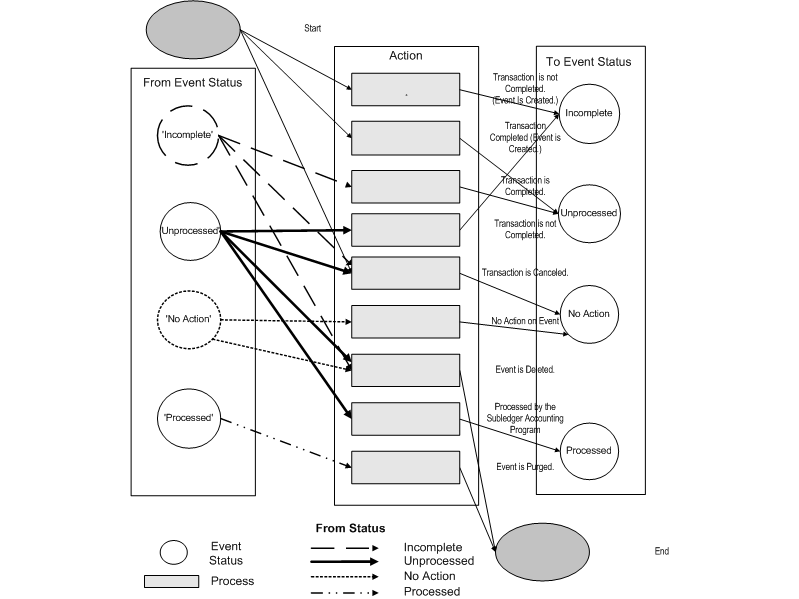

The event status is an indicator of what actions have been completed on the transaction and what operations are yet to be done. It is a snapshot of where the transaction is in its accounting event life cycle.
See: Event Status and the Accounting Event Life Cycle
Each event has an event status. The accounting program can make updates to this status. As an example, consider an accounting event that has a status of Unprocessed. Once the accounting program successfully processes the accounting event in final mode, the status of the event is updated to Processed.
See: Draft and Final Accounting
The table below lists the event statuses along with their corresponding details. At any point of time, an event can have only one of these statuses.
| Status | Details |
| Incomplete | The accounting event data is in the process of being created. Some of the accounting event data cannot be created at this point. There can be validations that have not yet been performed. No subledger journal entry exists for the accounting event. If the accounting program is run, it does not process accounting events with a status of Incomplete. The subledger application updates this event status. Example: A user enters a Payables invoice, but does not validate it. If an event is captured, it has a status of Incomplete. |
| Unprocessed | All of the transaction data for this accounting event has been created and all validations have been performed. At this point of time, the subledger journal entry can be created. When the accounting program is run, it processes accounting events with a status of unprocessed. This event status is updated by the subledger application based on the transaction status. Example: A user successfully validates a Payables invoice. An accounting event is captured and has a status of Unprocessed. |
| No action | No subledger journal entry is needed for this accounting event. The subledger application updates this event status. Example: Assume an Invoice accounting event is created with the status Unprocessed. If the invoice is canceled on the same GL date, the Invoice accounting event should not be accounted. The event status is set to a status of No Action, since the invoice has no financial accounting impact. |
| Processed | All of the transaction data for this accounting event is created, all validations are performed and, if appropriate, the final subledger journal entry is created. The transaction data associated with the accounting event cannot be changed. For those transactions where multiple accounting events are allowed, any changes to the transaction data at this point of time results in a new accounting event. The changed transaction data is tracked under the new accounting event. After successfully creating subledger journal entries, the accounting program updates the event status. Example: Consider an Invoice accounting event which has a status Processed. Users cannot change the invoice currency at this point because it affects data potentially associated with an event that has already been accounted. However, you can enter new lines provided the subledger functionality allows such a change. New lines entered are recorded with new accounting events. See: Transactions with Multiple Events |
| Related Event in Error | If an event ends in status Invalid or Error, other events for the same document which are processed and accounted successfully in the same run of the Create Accounting program must be set to status Related Event in Error. |
Every event has a life cycle. The event status indicates what actions have been completed on a transaction and where the event is in its life cycle. The life cycle is shown in the diagram below.
The above diagram illustrates all the status changes for an accounting event. The diagram has three blocks. The left block, From Event Status, shows the possible initial statuses of an event. These statuses are Incomplete, Unprocessed, No Action, and Processed.
The center block, Action, represents actions that users complete in subledger application, such as Oracle Projects, Oracle Assets, or Oracle Receivables. These actions result in events being created, processed, or deleted.
The right block, To Event Status, shows the possible final status based on the action in the central block. The status values include Incomplete, Unprocessed, No Action, and Processed Program.
Note that these are all the possible status changes. Not all accounting event types can support all of these status changes. For example, some accounting events, once they have a status of Unprocessed, cannot be updated to an Incomplete status. Implementers are responsible for determining the supported status changes for an event.
There may also be conditions that determine whether the accounting event can move from one status to another. These conditions can vary by accounting event.

Some business events have the potential to invalidate the accounting created by a previous accounting event. These business events should not be supported. Each event and its accounting should be auditable and reportable at a later point in time. As an example, it should not be possible to delete an invoice after the Invoice Validated accounting event is processed in final mode.
Users can change the transaction data if its associated event is unprocessed, but no changes should be allowed after the event is processed. As a general guideline, transactions should not support business events that call for a delete or update of accounting created by other accounting events. The business events should be changed to achieve the same results by reversing accounting created by the previous accounting events.
Subledger journal entries can be created in draft or final mode. Both kinds of entries are created using the same accounting definitions, with the difference that it is possible to modify or delete transaction information associated with draft entries. Any changes to the transaction data after accounting in draft mode invalidates the draft journal entries.
In both draft and final mode, if errors are raised in processing of events for a transaction, the accounting program does not endeavor to fully account that transaction. Instead those events are flagged and the program proceeds to the next transaction.
Draft journal entries are purged once the final accounting is created. Also, if there is any change in event status, event date, or event type of an event, then draft journal entries associated with this event are deleted. Draft entries are not transferred to General Ledger.
If you have already created accounting in Final Mode but have not transferred them to GL, and then you run the Create Accounting program again with Transfer to GL option set to Yes, then the application does not pick up events already created in the Final mode. In this case, run the Transfer Journal Entries to General Ledger program.

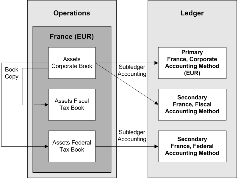

The difference between valuation and nonvaluation method applications is that valuation method applications link their representations directly to their respective primary and secondary ledgers. In nonvaluation method applications, the representations are only linked to the primary ledger.
Consider the following example, illustrated in the figure below, to demonstrate the differences between the two approaches.
In the diagram above, the Operations box for a French company shows a valuation method application Assets, which includes Assets Corporate Book, Assets Fiscal Tax Book, and Assets Federal Tax Book. The Ledger box shows the corporate fiscal, local fiscal, and federal accounting representations, ledgers for a French subsidiary of a multinational corporation.
Applications that opt to enable the use of multiple valuation methods also have the flexibility to choose whether to use the valuation method of the primary accounting representation for a secondary accounting representation or an alternate valuation method. For example Assets can choose to create accounting for the fiscal accounting representation based on the corporate book transactions rather than the fiscal tax book transactions. Similarly, Assets can choose to create accounting for the federal accounting representation based on the federal tax book transactions rather than the corporate book transactions.
The diagram above shows that the accounting events for the corporate book create accounting for both the primary (Corporate Accounting Method) and secondary ledger (Fiscal Accounting Method) simultaneously. The accounting events for the Assets Federal Tax Book only create accounting for the secondary ledger (Federal Accounting Method). Note that transactions must not be created for the Assets Fiscal Tax Book because its associated secondary ledger (Fiscal Accounting Method) already receives its accounting from the accounting books of the corporate book.
The Financial Services Accounting Hub creates accounting for the ledger associated with the accounting event. For applications that support multiple valuation methods, the accounting events should be associated with the appropriate primary or secondary ledger. For applications that do not support multiple valuation methods, the associated ledger is always the primary ledger. Accounting is simultaneously created for all the secondary ledgers.
