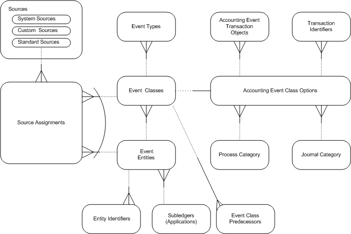

For each accounting event, the Load Transaction Objects program provides the accounting program with source values which, in conjunction with the application accounting definitions, are used to create subledger journal entries.
As this chapter is restricted to the seeding of event information in the AMB, the following steps are a subset of the procedures shown in the Event Setup Overview diagram. Each of these steps corresponds to a particular window in the AMB and is described in detail in a subsequent section of this chapter.
The above diagram illustrates the component definitions in the following order:
Step 1: Event Entities
Step 2: Event Classes
Step 3: Event Types
Step 4: Process Categories
Step 5: Event Class Options

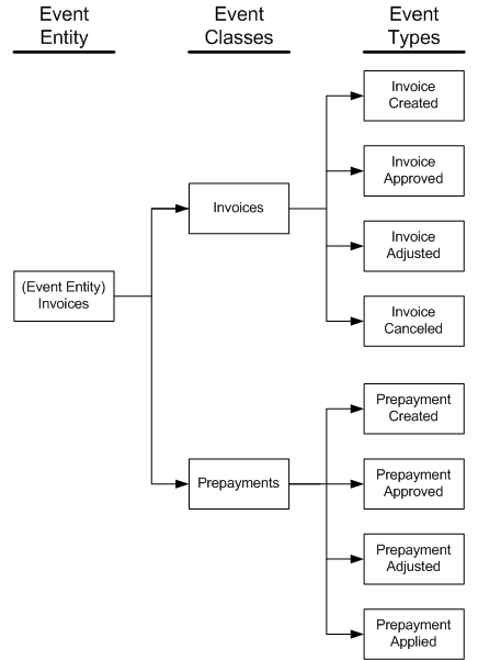

The diagram below provides an example of the relationship between event entities, event classes, and event types.
As shown in the above diagram, a single event entity can be associated with multiple event classes. The event entity Invoices is associated with the Invoices and Prepayments event classes.
Each of these event classes in turn, can be related to several event types. The Invoices event class is associated with the following event types:
Invoice Created
Invoice Validated
Invoice Adjusted
Invoice Canceled
The Prepayment event class is associated with the following event types:
Prepayment Created
Prepayment Approved
Prepayment Adjusted
Prepayment Applied
The entity relationship diagram below describes the entities related to the setup of accounting events and is described in the subsequent sections.

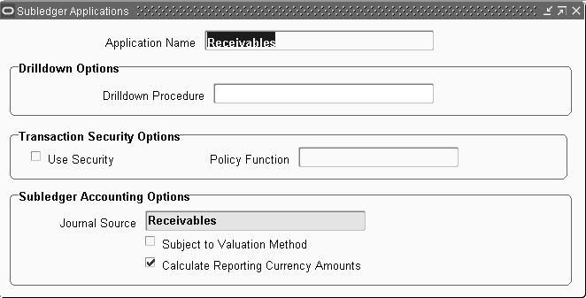

To use the AMB, register your application with the Financial Services Accounting Hub. Specify options related to event security, General Ledger, and subledger accounting options along with the names of event processing procedures.
| Field | Description |
| Application Name | List of values includes all existing Oracle E-Business suite applications. To display external applications, register them using the application's developer responsibility. If an application is registered, query the application. |
| Drilldown Procedure | Stored procedure that the Financial Services Accounting Hub uses to drill down from a journal entry to the corresponding subledger transaction See: Drill-down API Details |
| Use Security | If not selected, then there is no event security for this application and a session has access to all events in the application regardless of the transaction's security. |
| Policy Function | If Use Security is selected, enter a stored function that establishes security access for a session. Because this field has no validation, ensure that the value entered corresponds to a valid database function. See: Financial Services Accounting Hub Security Introduction |
| Journal Source | Identifies the origin of the subledger journal entries |
| Subject to Valuation Method | Select if the application supports multiple valuations for a single transaction. See: Valuation Methods and the Financial Services Accounting Hub |
| Calculate Reporting Currency Amounts | Select to calculate accounted amount for any reporting currency. If selected, the Create Accounting program calculates accounted amounts and creates journals for all enabled subledger level reporting currencies associated with the primary ledgers. If not selected, the Create Accounting program does not calculate accounted amount for any reporting currencies, but it does create journals for the subledger level reporting currencies if reporting currency information is provided in the transaction objects. If the Create Accounting program fails to create journal entries for any of the subledger level reporting currencies, no journal entries are created for the primary and secondary ledgers and for other subledger level reporting currencies. This option does not apply to secondary ledgers. The Financial Services Accounting Hub calculates accounted amount for secondary ledgers regardless of the value of the Calculate Reporting Currency Amounts option. Note: Select this check box for products that support Multi-reporting Currencies in release 11.5 except for Oracle Assets and Oracle Projects. Note: This option does not correlate to the Calculate Accounted Amounts option in the Accounting Event Class Options window. The Calculate Accounted Amounts option applies to currency conversions from transaction currency to the functional currency of the ledger that the event is associated with. The Calculate Reporting Currency Amounts option applies to currency conversions to subledger level reporting currency. |
| Third Party Type | Select Supplier, Customer, Any, or None. |

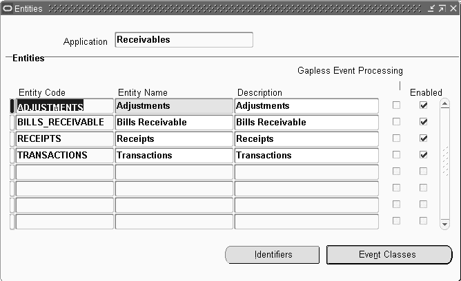

Use accounting event entities to treat events for a single transaction model in a similar manner. Event classes within an event entity usually share the same entity table in the transaction data model and can be uniquely identified by the same primary or surrogate key.
Use event entities to tie subledger transaction entities with their accounting representation. The Financial Services Accounting Hub uses event entities to maintain the system transaction identifiers that uniquely identify the subledger transactions associated with the accounting events.
Example: Oracle Payables invoices and prepayments are stored in the same entity table in the data model and are identified by the same primary key. Therefore, they can be grouped under the same event entity.
Event entities have the following characteristics:
They usually correspond to a database object.
They can also logically correspond to a single transaction, which is used as a basis for several related accounting events. Examples of such transactions include Payables or Receivables invoices.
Event entities differ by application; implementers create their event entities for a particular application.
Consider the following issues:
Whether different types of transaction data are maintained in the same table
Such transactions should typically be part of the same event entity. For example, in Payables, invoices, prepayments, and credit memos are stored in the same table. Therefore, it is logical to have an event entity to cover these accounting event classes. The table below lists examples of event entities for Payables and their associated entity tables.
| Event Entity | Entity Table Name |
| Invoices | AP_INVOICES_ALL |
| Payments | AP_CHECKS_ALL |
Whether there is a requirement to provide separate sequences for the different kinds of subledger journal entries used to account for events
Use the Entities window to set up event entities and system transaction identifiers for the application. This window is only available to implementers. Users cannot create or update event entities.
| Field or Button | Description |
| Entity Code | Implementer's key used by programs and routines to refer to the entity. Codes are used because event entity names are translated. |
| Description | If the event entity represents a specific transaction, then include the transaction name. Otherwise, include a description of the types of transactions represented by the event entity. |
| Gapless Event Processing | Enables gapless event processing. If selected, all the events associated with the entity are flagged as On Hold if there is a gap in the event numbers. |
| Enabled | If selected, makes this definition available for use |
| Identifiers | Opens the System Transaction Identifiers window |
| Event Classes | Opens the Event Classes and Types window |

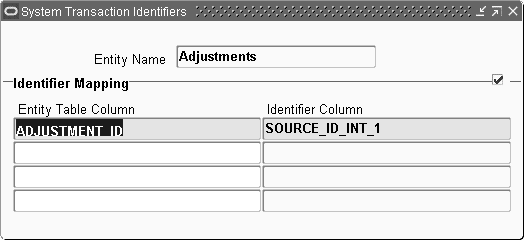

You can assign up to five attributes to uniquely identify instances of an event entity. These attributes constitute the primary or surrogate key for the entity tables in the transaction data model where the subledger transaction associated with the event entity are stored. These identifiers link accounting events with their underlying transactions in the transaction data model. Define the link by mapping columns from the entity table to system transaction identifiers for the event entity in the System Transaction Identifiers window.
Note: The System Transaction Identifiers window provides only the definition of the link and not the actual link. The latter is stored in the XLA_TRANSACTION_ENTITIES table.
As part of registering event entities in the AMB, system transaction identifiers are assigned to entity table columns in the transaction data model.
See: System Transaction Identifiers
In the System Transaction Identifiers window, enter the columns that constitute the transaction header table's primary or surrogate key and assign them to system transaction identifiers.
| Field | Descriptions |
| Entity Table Column | Stores the column names that constitute the primary or surrogate key of an accounting event's underlying subledger transaction |
| Identifier Column | Corresponding identifier column name; stores the column names from the transaction entities table that the Entity Table column is mapped to List of values for this field includes 15 identifiers; five of these columns are numeric, five are alphanumeric, and five are dates. When events are captured, the event identifiers must be passed to the event capture APIs in the corresponding parameters. For example, if TRANSACTION_ID is mapped to SOURCE_ID_INT_1 on this window, then the value of TRANSACTION_ID must be passed to the accounting event APIs in the SOURCE ID_INT_1 parameter. See: Introduction to Capturing Events |

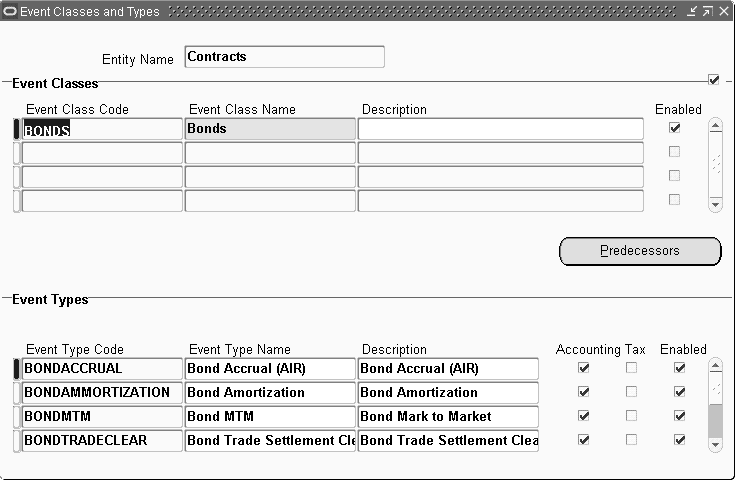

Use the Event Class and Types window to define event classes for the application after creating event entities. This window is accessed from the Entities window. All event classes created relate to the same associated event entity. Users cannot create or update event classes.
Define an event class for:
Each set of accounting events that pertain to the same kind of transaction
Sources to be shared
See: To Define Event Classes and Types
| Event Class Code | Developer key used by programs and routines to refer to this event class. Codes are used because event class names are translated. |
| Event Class Name | Create user-oriented names because they appear in several AMB windows. |
| Event Type Code | Developer key used by programs and routines to refer to this event type. Codes are used because event class names are translated. |
| Event Type Name | Application accounting definitions are based on event types. It is critical that all event type names have a user orientation and are consistent with the user's experience in the subledger applications. As an example of the kind of naming to be employed, event types for invoices should not be called Invoice Inserted, Invoice Updated, and Invoice Deleted. Use names like Invoices Created, Invoice Adjusted, and Invoice Canceled. Define an event type in the system before events can be captured for that event type. Define event type names and descriptions in the past tense because the event is captured only if the transaction has completed successfully. |
| Accounting | Indicates whether the event type is used by the Financial Services Accounting Hub |
| Tax | Indicates whether the event type is used for tax and sequencing |
| Enabled | If selected, makes definition available for use |
| Predecessors | Opens the Event Class Predecessors window |

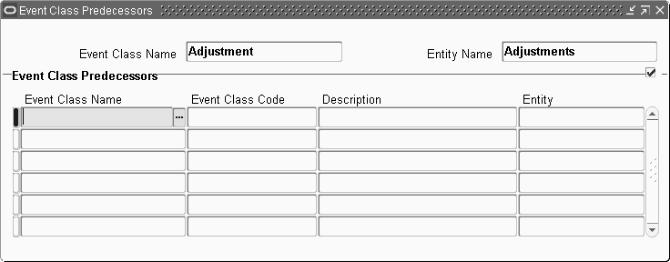

Event class predecessors ensure that if there is an accounting event that is dependent upon the accounting of a prior event, the accounting of the dependent event is not delayed if the prior event is not yet accounted. For example, without event class predecessors, an AR Receipt that is dependent on an AR Invoice cannot be accounted if the invoice is not accounted. With event class predecessors, the Create Accounting program processes the AR Invoice before processing the AR Receipt thereby minimizing delays in accounting due to the dependencies inherent in business flow processing.
Predecessors can exist across entities and are defined at the application level. They must be in the same application because the Create Accounting program runs for only one application at a time. If an event is dependent on the accounting of another event that is in a different application, accounting must still be run separately for that application before the dependent event can be accounted.
The Event Class Predecessors window establishes an order in which the Create Accounting program processes events selected for accounting. This order of events ensures that the accounting of a dependent event is not delayed because it depends on an unaccounted prior event. This window is accessed from the Event Classes and Types window.
| Event Class Name Entity Name | Default from the Event Class and Types window |
| Event Class Name | Event class that the Create Accounting program must process before accounting the event class that is displayed in the header region of this window List of values has the following attributes:
The Event Class Code, Description, and Entity fields are automatically populated with related information. |

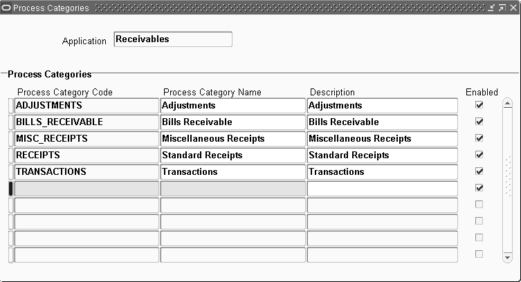

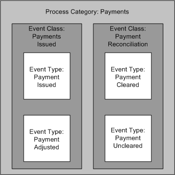

Process categories are collections of one or more logically related event classes. They restrict the events selected for accounting when users submit the Accounting Program. Events can be restricted from separate processing because of possible dependencies between transactions of different event classes. Such dependencies mean that accounting events of one class should not be accounted independently from accounting events of another class.
By grouping event classes so that they can be processed in a single submission of the Accounting Program, process categories enable users to create and transfer accounting for all the accounting events in a business flow.
For example, in many situations, accounting events for the Payment Issue event class should not be accounted independently from accounting events for the Payment Clear event class. These should be processed by a single submission of the Accounting Program. To accomplish this, group these two event classes into a single process category.
Seed a process category for each set of event classes that composes a business flow and that you want to create accounting for in a single run of the Accounting Program.
When submitting the Accounting Program, users can choose the process category that they want to create accounting for. If no process category is specified, the selection of accounting events to be processed is not restricted by event class.
Note: Assign event classes to process categories in the Accounting Event Class Options window.

Selecting a process category indicates that all associated event classes and their assigned event types are selected for processing.
Consider the example of a cash manager who wants to reconcile General Ledger cash account balances to bank statements received.
To undertake this reconciliation, the first step is to process all transactions pertaining to cash to obtain an accurate report of the organization's cash account balances. The manager must ensure that all entries affecting the cash balance in General Ledger are selected for processing. This includes entries related to payments, their clearing, and unclearing.
A sample process category setup is shown in the figure below and is described in the Process Category: Payments table.
| Event Class: Payments Issued | Event Class: Payment Reconciliation |
| Event Type: Payment Issued | Event Type: Payment Cleared |
| Event Type: Payment Adjusted | Event Type: Payment Uncleared |
In this example, the cash manager can select the process category Payments when the Accounting Program is submitted. As a result, all events associated with these event types are selected for processing by the Accounting Program.
The table below describes selected fields from the Process Categories window.
| Process Category Code | Developer's key used by programs and routines to refer to this category |
| Process Category Name | Selected by users when submitting the Accounting Program |
