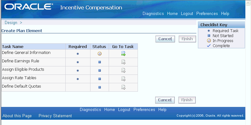

A plan element is part of a compensation plan. It specifies the conditions a resource must meet to be eligible for compensation, and it determines how the compensation is calculated. You can assign multiple plan elements to a compensation plan and you can assign a plan element to multiple compensation plans.
Creating a plan element is made simpler by the plan element creation task list. As you proceed through this list, you must perform one procedure at a time before the next one is accessible. The screenshot below shows the task list when it first appears. After the General Information step is completed, the Go to Task icon is activated for Earnings Rules setup.
The Earnings Rule subtab lists the high-level configurations for the Plan Element. This includes:
Formula Name
Interval Types
Process Transactions (Individually or Grouped)
Split Options
Payment Options (Group Code, Credit Type)
Integration with A/P (Expense and Liability Accounts)
These items are grouped under Earnings Rule because they affect the frequency and nature (whether or not to aggregate) of transaction collection, and consequently how earnings are defined and calculated.
The Plan Element Creation Task List

Navigation
Plan Administrator > Create Plan Element > Define Default Quotas
Notes
You can click the Plan Element name link to return to the Plan Element Details page.

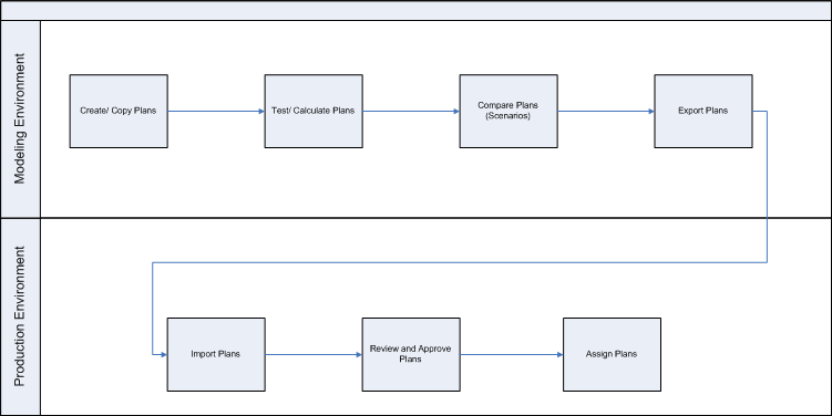

As a Plan Administrator, you must modify or update existing compensation plans to conform to new sales directives. Oracle Incentive Compensation allows you to download details of a compensation plan you have modeled in a test environment, and upload it to the production environment. This approach allows you copy plans and plan components across different environments You can copy a compensation plan, and the following components: plan elements, formulas, expressions, rate tables, and rate dimensions.
The Export Setup Data function allows you to download the compensation plan and its components into your local system, as an XML document. After you have downloaded the file use the Import Setup Data function, to upload the XML file into a different environment. This allows you to migrate plans from one environment to another environment.
To accomplish copying plans from one environment to the other, you generally follow these steps:
Create a new plan or create copy of an existing plan.
Test the plans for correctness.
Compare the plans using Scenarios.
Create an Export request for the plan.
Import the plan to applicable environment.
Review and approve the plan.
Assign the plan.
