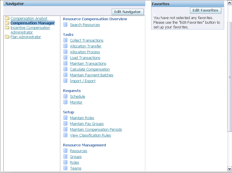

In Oracle Incentive Compensation, compensation plans are not assigned directly to resources. A role is assigned to one or more individual resources, and then compensation plans are assigned to roles. The Compensation Manager can assign a compensation plan to a role using the Setup menu. The Compensation Manager or Compensation Analyst can create and assign roles to a resource by using the Resource tab of the 360 degree view of the resource. The correct profiles must be enabled for the responsibility (System Administrator > Security > Profiles) to make the 360 degree view of the resource tab updateable.
Compensation Manager and Analyst Navigator
The Compensation Manager or Compensation Analyst also can create, update, or add members of a team or group by using the Compensation Overview, 360 Degree View menu if the correct profiles are enabled for the responsibility (System Administrator > Security > Profiles).

Navigation
Compensation Manager > Search Resources
