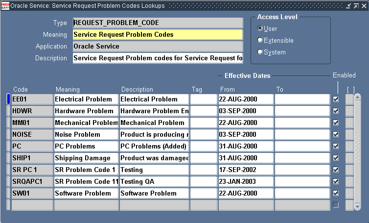

To set up service request problem codes
Under the Service responsibility, navigate to Setup, Definitions, Problem Codes.
The Oracle Service: Service Request Problem Codes Lookups window appears. displaying all problem codes.
Enter a problem code in the Code field.
Enter a meaning. A meaning is a brief description of the code.
Optionally, enter a full description of the code in the Description field.
Optionally, enter Start and End dates to control the use of problem codes. By specifying a future start date you can delay the use of a new problem code. You can inactivate a problem code by setting an end date.
The Tag field is not used for problem codes.
Select the Enabled check box to make the code is available for use.
Optionally, enter the descriptive flexfield, if defined.
Save your problem code.

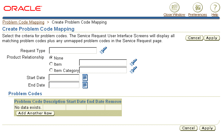

To create a new problem code mapping
On the Problem Code mapping page, click Create Problem Code Mapping.
Note: To view unmapped codes first, click Unmapped Problem Codes.
The Create Problem Mapping page appears.
Select the object or combination of objects you wish to map. You can map problem codes to a Service Request Type alone or in combination with either an item or an item category:
To map problem codes to a Service Request Type, select the type using the Request Type list of values (the flashlight icon).
To map to an inventory item or an item category, select either the Item or the Item Category radio button and use the list of values to make your selection.
Select any problem codes you wish to map using Add Another Row.
Note: The drop-down list lists all problem codes, including those already mapped. If you select a mapped code by accident, you will receive an error when saving this mapping.
You can remove mapped codes by clicking Remove only before you save the mapping.
Click Apply when you are done.
