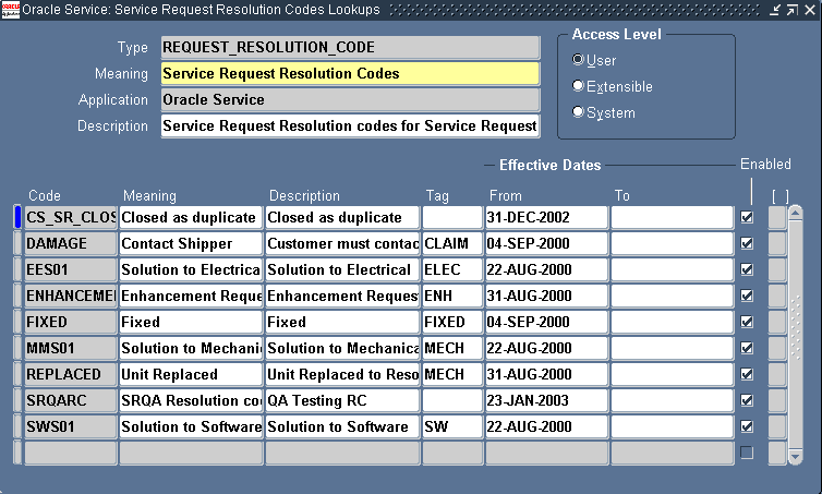

To set up service request resolution codes
Under the Service responsibility, navigate to Setup, Mapping, Resolution Code Mapping.
The Service Request Resolution Codes window appears displaying any existing resolution codes.
Enter the resolution codes:
Click New in the toolbar.
Enter a single word as the code in the Code field. This is for internal use by the application.
Enter the wording you wish agents to see in the list of values in the Meaning field.
Optionally, enter a description in the Description field.
You can restrict the availability of the code using the start or end dates.
The Tag field is not used for resolution codes.
Select the Enabled check box to make the code available for use.
Optionally, you can enter a descriptive flexfield if one has been set up for this purpose.
Save your resolution codes by clicking Save in the toolbar.

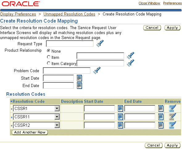

To create a new resolution code mapping
You can create a mapping in one of two ways:
By selecting problem codes from a list of unmapped codes by clicking Unmapped Problem Codes.
Provided you know which codes you wish to map, by clicking Create Problem Code Mapping.
The Create Resolution Code Mapping page appears.
Select the object or combination of objects you wish to map:
To map resolution codes to a service request type, select the type using the Request Type list of values (the flashlight icon).
To map an inventory item or an item category, select either the Item or the Item Category radio button and use the list of values to make your selection.
To map a problem code, select it.
To limit the availability of this mapping, enter dates in the Start Date and End Date fields.
Enter any additional resolution codes you wish to map. For each code:
Click Add Another Row.
Select the code using the Resolution Code drop-down list.
Note: The drop-down list lists all resolution codes, including those already mapped. If you select a mapped code by accident, you will receive an error when saving this mapping.
To remove any mapped code, click Remove. You can remove codes only before you save the mapping.
Click Apply when you are done.
