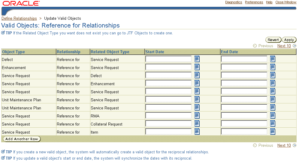

To permit linking of service requests to objects other than service requests using the “Reference for” and “Refers to” link pair, click Update Valid Objects (the pencil icon) in the Reference for row and follow the procedure outlined in Adding Reference Links to Objects Other Than Service Requests.
Use this procedure to make it possible for users to link service requests to objects using the “Refers to” relationship link. The system automatically creates the reciprocal “Reference for” relationship. By default, this relationship type is already set up for service requests.
Prerequisites:
You must set up the objects you wish to link to service requests using the Task Setup: Object Types window which is available by navigating to Task and Escalation Manager, Setup, Objects Metadata under the CRM Administrator Responsibility.
See Setting Up Metadata Objects in Oracle Common Application Calendar Implementation Guide for details.
To set up reference links to objects other than service requests
From the Navigator, navigate to Setup, Definitions, Relationships and Valid Objects.
The Relationships and Valid Objects page appears in your browser window.
Click Update Valid Objects (the pencil icon) in the “Reference for” row.
The Valid Objects page appears.
Click Add Another Row.
From Relationship Type drop-down list, select Refers to.
Click Search for Related Object Type (the searchlight icon in the Related Object Type column.)
Search and Select: Related Object Type page appears.
Click Go to display all of the objects you have defined.
Select the radio button next to the name of the object.
Click Select.
The object you selected appears in the Valid Objects: Reference for and Refers to Relationships page.
Click Apply to save your work.

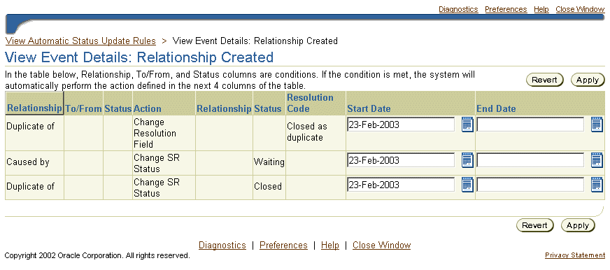

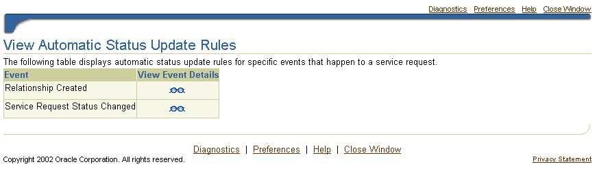

Use this procedure to turn off any of the seeded automatic service request status update rules. You cannot add rules or modify them.
To turn off automatic service request status update rules
To turn off automatic service request status update rules: Under the Service responsibility, navigate to Setup, Rules, Status Update Rules.
The View Automatic Status Update Rules page appears in a browser window.
Click View Event Details (the glasses icon) to the right of the rule type you wish to disable.
The View Event Details page appears. The page displays different details depending on the rule type you have chosen.
Enter an end date for any rule you wish to disable.
Click Apply.
Note: You can modify the resolution code and the service request status for the Duplicate Of relationship. For the Caused By relationship you can change the service request status. For more information, see Setting Up Service Request Statuses.
