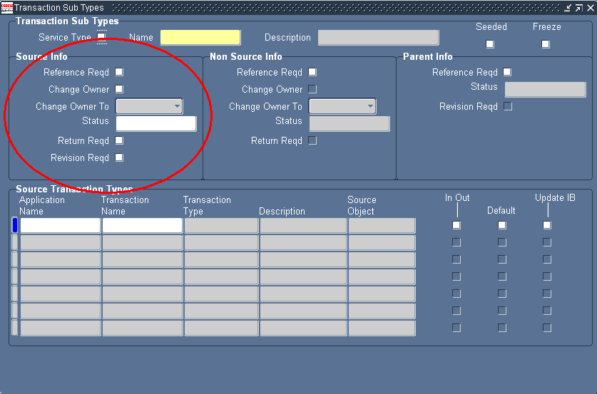

Source Info region (for orders and returns)

For returns, the Source Info region of the Transaction Subtypes window is where you specify information about the item received from the customer. The Reference Reqd check box determines if agents must enter the item instance reference when creating a charge line for a return.
You may want to leave entry as optional for returns for a number of reasons:
You may be shipping a replacement part for a customer with a number of units, and don't know which damaged unit is going to be shipped back.
A customer may not know the serial number because it is hidden inside the unit or illegible.
For orders, you use the Source Info region to specify what updates are to be performed for item instances that get shipped via Order Management / Shipping. For example, in loaner shipment transactions, the Source Info region typically specifies that no ownership change is to take place. For transactions used to ship parts to customers, however, the Source Info region specifies that ownership needs to be updated to the receiving customer.
Note that for orders, the Source Info region refers not to the instance that can be identified on the charge line, but to the instance that will be shipped by Order Management / Shipping.

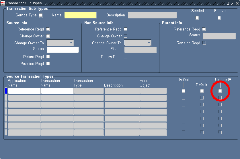

The Update IB check box to the right of each line determines if that application is permitted to update Oracle Installed Base. For Oracle TeleService, you must choose the Update IB check box for only one of the applications involved.
To have Charges make the updates, select the Update IB check box next to the Order Management line.
To have Charges bill only, leave this check box deselected. You must select it for a different application, such as Oracle Field Service, for example.

If the activity you are setting up is of type return, used by agents to record return of parts from customers, then set up the Source Info region:
Select the Reference Rqd check box.
To change ownership of the part, select the Change Owner check box and select "Internal" from the Change Owner To drop-down box. This indicates the part is now owned by your organization. For loaners you must leave this check box unselected.
To update the status of the item in the customer's installed base, select a new status using the Status LOV.
To require agents to enter a date in the Return By date field in Charges, select the Return Reqd check box. The return by date is the date the return must be received.

Use the Application Name LOV to enter Oracle Order Management. This permits Oracle TeleService and Oracle Depot Repair users to use this subtype.
Select a valid source transaction type from the Transaction Name LOV. Source transactions types are used by Oracle Installed Base and are set up according to procedures described in the Oracle Installed Base Implementation Guide.
Select the Update IB check box to have Charges be the application to update the installed base when an item is shipped or received.
If you leave this check box unselected, Charges bills only. In this case you must enter a different application such as Oracle Field Service as a line in this region and select its Update IB check box to indicate that it will update installed base instead.
Select the Default check box to have this subtype be the default for Oracle Order Management.
Note: The Source Object field and the In Out check boxes are reserved for future use.
Enter any other applications that you wish to permit to use this subtype.
Note: You cannot have more than one application update the installed base at the same time. This means that you should create separate service activities and subtypes for Oracle Field Service and Charges. If you do want to use the same subtype for both, however, then you can permit only one application to make the update by selecting the Update IB check box for only one application.
