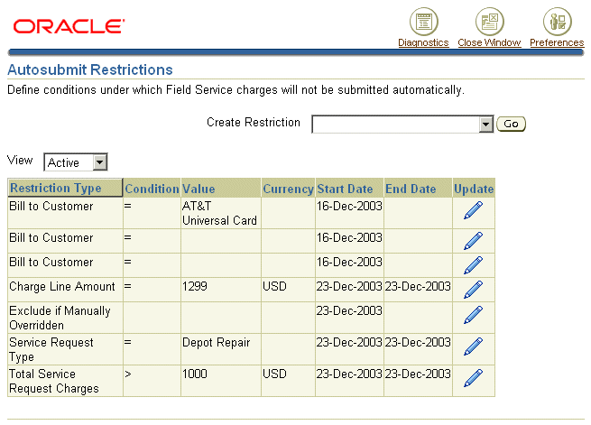

This topic describes the different rules you can use to restrict the automatic submission of charges.
By default, the application includes one rule: the application does not submit charge lines if an agent has modified their pricing. (You can turn this rule off by entering an end date.)
The following table lists and describes the available restriction rules:
| Rule | Description |
| Actuals Exceed Estimates | Limits automatic submission if the total service request charges fall within a percentage above the total estimated charges. You can specify only one rule of this type. The rule calculates the percentage based on the following formula: (Total Actuals + Total In Progress - Total Estimates)/Total Estimates * 100 If the service request contains charges in multiple currencies, each currency is evaluated separately. |
| Bill to Customer | Does not submit the charge line if the customer you specify is to be billed for the service. This restriction is based on the Bill To party. You can create multiple rules of this type to exclude specific customers from automatic billing. |
| Charge Line Amount | Each charge line must be below (or above depending on the operator you select) the amount you specify. The rule considers only the charge lines for the currency you specify as it does not perform any currency conversions. You can create multiple rules of this type, one for each currency. |
| Exclude Manually Overridden Charges | By default, the application does not submit charge lines modified by agents. You have the option of turning this rule off by entering an end date. |
| Service Request Type | Prevents charges belonging to service requests of a particular type from being automatically submitted. You can create multiple rules of this type. |
| Total Service Request Charges | Total charges for the service request must be below (or above depending on the operator you select) the currency amount you specify. You can create only one rule of this type per currency. |
You can view and update restriction rules on the Autosubmit Restrictions page available by navigating under the Service responsibility to Setup, Charges, Autosubmit Restrictions.
To add a rule, select the rule type from the Create Restriction drop-down list and click Go. For details see Adding a Restriction Rule.
To update a rule, click Update to the right of the rule. For details, see Updating a Restriction Rule.
