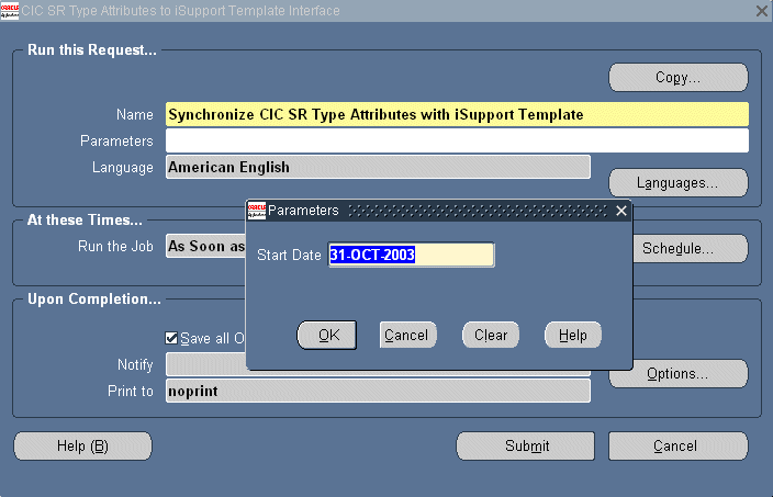

Navigate to Setup, Synchronize TeleService with iSupport, Sync SR Type to iSupport Template.
The Parameters and the CIC SR Type Attributes to iSupport Template Interface windows appear.
Enter the start date. All attribute setups created on or since this date will be mapped to Oracle iSupport templates.
Click Submit and follow the standard procedures for running concurrent programs.

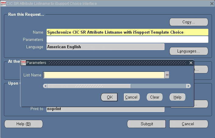

You must run a separate concurrent program to map each of the lookups (lists of values) that are used by your attribute setups. For each lookup:
Navigate to Sync SR Attribute Listname to iSupport.
The Parameters and the CIC SR Attribute Listname to iSupport Choice Interface windows appear.
Enter the name of the lookup in the List Name field.
Click OK.
Submit the concurrent program following the standard procedure for running concurrent programs.
