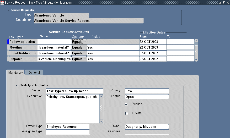

  2. Navigate to Setup: Mapping, Task Type Attribute Mapping.
  3. Choose the service request type you wish to map in the Service Request Types search window.
    The Service Request Task Type Configuration window appears.
    the picture is described in the document text
  4. Set up the rules for creating tasks based on attribute values in the Service Request Attributes region. For each rule:
    1. If required, create a new entry line by clicking New.
    2. Use the Task Type list of values (LOV) to select the task type for the task to be generated.
    3. Using the Name LOV, select the attribute.
    4. Select the = operator. This is the only operator supported in this release.
    5. In the Value field enter the value to trigger the task generation. If you have set up the attribute with a list of values, then you must select the value. If you have not, then you must enter the value as text.
    6. On the Mandatory tab, enter the details of the task, such a description, its default status, priority, publish flag, private flag. The application uses the information for creating tasks.
      Note: You must enter a task owner, the individual responsible for the completion of the task. This means that you cannot automatically assign tasks created in this way via automatic assignment.
      Select the Publish flag to have the task display in Oracle iSupport where it can be viewed by customers.
  5. To trigger a workflow when the task is created, you must associate the workflow with the task type in the Task Types window. (See Defining Task Types).
  6. If you have set up a workflow for this task and wish to pass it additional task attributes, then select the Optional tab and select the values for the attributes there. See Modifying and Extending Task Generation.

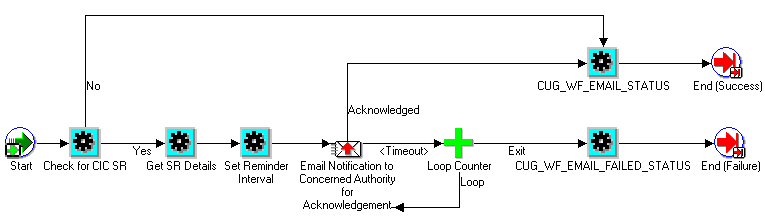

You can also set up a task to automatically launch an Oracle Workflow process, for example, to notify assignees by e-mail that tasks have been created. Oracle supplies a sample process with your application. (See Sample E-mail Notification Workflow Customization.)
To launch a Workflow process, you associate it with a task type. (This is done in the same Task Type window where you set up task types. See Defining Task Types.)
Suppose, for example, that a government department handling hazardous material spills needs to notify different individuals via e-mail depending on the type of the material involved in a spill.
To do this, the department creates an Oracle Workflow process which automatically sends the e-mail notification and maps it to the task type. The department sets up additional task attributes to pass the text of the e-mail, the e-mail address of the individual to be notified, and other information.
This way the workflow can send different e-mails to different individuals depending on whether the spill involves acid or radioactive material, for example.
Extending Task Generation with a Workflow Process
This topic outlines how you can extend task generation to launch a workflow.
To extend task generation to launch an Oracle Workflow process
  1. Create an Oracle Workflow process with the attributes you wish to capture and upload it into the Service Request item type.
  2. Create a task type and associate it with the workflow. For details, see Defining Task Types.
  3. Create the additional attributes you wish to pass to the Workflow process according to the procedure described in Defining Additional Attributes for Tasks.
  4. Map the attributes to the Task Type and enter the values to be passed into the task attributes. See Mapping Additional Attributes to a Task Type.

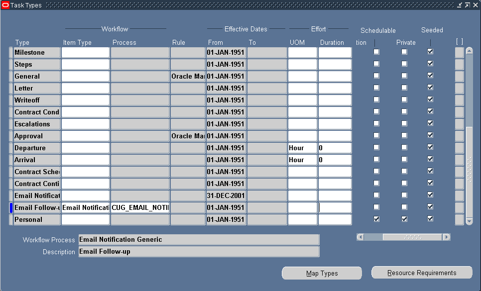

Defining Task Types
Use this procedure to set up and modify task types. While the primary function of task types is to classify tasks, you can use task types to specify the types of resources that can be assigned, determine whether the tasks are schedulable for Oracle Field Service, and to automatically launch workflows when tasks of this type are created. For further information see the tasks section of the Oracle Common Application Calendar Implementation Guide.
To define task types
  1. Navigate to Setup, Task Management, Task Types.
    The Task Types window appears.
  2. If you are creating a new task type, click New in the toolbar to insert a new row for entering task type.
  3. In the Type field, enter a name for the task type. This is the name of the task type agents see in the list of values.
  4. To launch a workflow each time for this task type:
    1. For Item Type, select Worklfow type.
    2. Use the Process LOV to select the name. The Task Workflow and Description fields towards the bottom of the window display information about the workflow.
  5. If you are planning to use this type for Oracle Field Service, then select Field Service using the Rule field LOV.
  6. Make entries in the Effective Dates From and Effective Dates To fields to limit the availability of this type.
  7. To specify the amount of time this task should take:
    1. In the UOM field, select the unit of measure for quantifying the effort for the task type.
    2. In the Duration field, enter the default amount of time this task type would take to complete.
  8. Select the Notification check box to notify the task owner that a task has been created through the Oracle Workflow notifications page.
  9. Select the Schedulable check box to have the task scheduled through Oracle Advanced Scheduler.
    Note: The Private check box is reserved for future use.
  10. The seeded check box indicates seeded task types.
  11. To specify the type of resources that can be assigned to complete the task:
    1. Click Resource Requirements.
      The Resource Requirements window appears.
    2. Using the Name LOV, select the resource type to be used with this task type.
    3. In the Required Units field, enter the estimated number of units of the selected resource type that would be required to perform this task type.
    4. Select the Enabled Flag check box to activate the resource type assignment for the task type.
    5. Select OK to save your assignments and return to the Task Types window.
  12. Save your work.

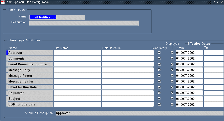

Use this procedure to map additional task attributes to a task type. Doing so makes it possible for you to pass values of these attributes to an Oracle Workflow process you have created.
Prerequisites:
To map additional attributes to a task type
  1. Navigate to Setup, Task Management, Task Type Attributes.
    The Task Type Attribute Configuration window appears.
  2. Use the Name list of values (LOV) to select the task type you wish to set up.
  3. In the Task Type Attributes region, enter the attributes you wish to map:
    1. Using the Name LOV, select the attribute from those you have defined in the CUG_TASK_TYPE_ATTRIBUTES lookup.
    2. If you are going to be using a list of values to select values for the attributes, then use the List Name LOV to select the lookup where you defined the valid values.
      If you do not select a lookup here, you can enter text instead.
    3. If you have not selected a lookup in the previous step, then, optionally, enter a default value for this field.
    4. Enter an integer in the Sequence field corresponding to the order you wish to present the prompt. The prompts are displayed in descending order.
    5. To make entry optional, deselect the Mandatory check box. This check box is selected by default.
    6. The Displayed check box must be selected to display the attribute. This check box is selected by default.
  4. Save your work.

The following table lists the sample Email Follow-up task type attributes which pass information to the Email Generic Notification workflow process. The second column of the table explains what entries you can make for each attribute.
Attribute What You Enter
Approver A user name of a user with an e-mail address. The approver is the message recipient.
Subject Text that appears as the subject of the e-mail message.
Message Body Text of the message.
Requester A user name of a user with an e-mail address. The requester is the person who is listed as the sender
Message Header Text which appears as the header of the message.
Message Footer Text which appears as the footer of the message.
Email Reminder Counter The number of reminders you wish to send to the requester.
UOM for Due Date Unit of measure for the due date: DAY, WEEK, MONTH
Offset for Due Date The number of days, weeks, or months.
Note: For the Approver and Requester task type attribute you must enter an Oracle Application user name. This is defined in the Users window under the System Administrator Responsibility. The Email Notification workflow uses the e-mail address entered for the user in the same window.
E-mail Notification Generic Process
The following diagram illustrates the sample workflow process Oracle Workflow Process Email Notification Generic (CUG_EMAIL_NOTIFICATION)
  1. The process initiates when a task of type Email Follow-up is created.
    Note: You must make sure that the workflow is mapped to the task type in the Task Type window.
  2. The process gets the task attribute details (requester, approver, subject, etc.) from the values you enter on the Optional tab of the Task Type: Attribute Configuration window.
  3. The process sets a due date for the approver to acknowledge the e-mail notification. The due date is set based on the service request creation date and the number of days you enter in the Offset for Due Date attribute.
  4. The process sends an e-mail to the Approver with the text you entered in the Subject, Message Header, Message Body, and Message Footer attribute.
  5. If the approver does not acknowledge the message by the end of the due date, the process sends a reminder notification. The process sends the number of reminders you specify in the Email Remainder Counter attribute. If the approver acknowledges any of the notifications (the original or a reminder), the workflow terminates.
  6. If the approver does not respond, the workflow sends the maximum number of reminders. The work flow then fails and terminates.
  7. When the process completes successfully, the workflow updates the task status to Completed. If the processing fails, the process sets the task status to Cancelled. You can modify these statuses by setting the following system profiles:
Enabling the Sample E-mail Workflow Process
Use this procedure to enable the sample e-mail workflow process.
To enable the sample e-mail Workflow process
  1. Navigate to Setup, Task Management, Task Type.
  2. For the Email Follow-up task type:
    1. Enter “Email Notification Workflow for CIC Task” in the Item Type field.
    2. In the process field, enter CUG_EMAIL_NOTIFICATION.
  3. Save.
  4. Make sure that the notification mailer is set up. See “Setting Up Notification Mailers” in the Oracle Workflow Administrator's Guide.
