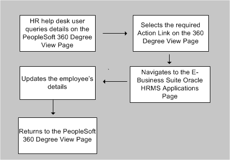

To resolve issues raised by requestors such as employees, HR help desk users require to navigate between multiple HR application functions. The HR Help Desk functionality uses Oracle HRMS applications and Oracle's PeopleSoft CRM HelpDesk for Human Resources to enable HR help desk users to access Oracle HRMS and resolve any employee queries. HR help desk users can resolve queries related to the workers' (employees and contingent workers) assignment, benefits, and payroll.
The following diagram summarizes the typical data flow when you implement the HR Help Desk functionality:
Processing Person Requests Using the HR Help Desk Functionality
This example explains the process of resolving help desk requests when your enterprise implements the HR Help Desk functionality:
Mary, an employee realizes that her address details are incorrect on the Employee Self-Service page. She browses through the Solution Repository for any pointers to the resolution of the issue and then contacts the HR help desk user. Mary raises a request for correction.
The HR help desk user accepts the call and verifies that the details on the PeopleSoft 360-Degree View page are incorrect.
The HR help desk user creates a request to update the address details.
Note: Employees can raise requests for updates to their records and the HR help desk user can review the requests and create cases. Employees can also create cases using the PeopleSoft Employee Self Service page and the HR help desk user can query the cases and resolve them.
The HR help desk user clicks the appropriate Action link on the PeopleSoft 360-Degree View page.
The relevant Oracle HRMS self-service page launches in a separate browser. This page displays the employee details automatically.
The HR help desk user changes Mary's address details on the Oracle HRMS page, saves the record and closes the page.
The 360-Degree View page displays the changed address.

Oracle HRMS provides the HR Help Desk responsibility that you can assign to HR help desk users to access Oracle HRMS functions. This responsibility includes the HR Help Desk menu, which contains the following functions:
| User Name | Function Name |
| Enter Person Details | PERWSEPI |
| HR Help Desk Proxy Page | HR_HELPDESK_SS |

When a HR help desk user logs in to Oracle HRMS, the application uses the HR HelpDesk Proxy page (HR_HELPDESK_SS) to navigate to the function that the help desk user works with. You can use the predefined responsibility as a sample to create your own responsibilities. Ensure that you include the HR_HELPDESK_SS function in your custom responsibility.
The HR Help Desk functionality uses Oracle HRMS applications and Oracle's PeopleSoft CRM HelpDesk for Human Resources to enable HR help desk users to access Oracle HRMS and resolve any worker (employee and contingent worker) queries. See: An Overview of the HR Help Desk Functionality
