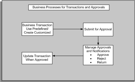

The purpose of Oracle Approvals Management (AME) is to define approval rules that determine the approval processes for Oracle applications. The following graphic illustrates the typical approval process used in an organization.
