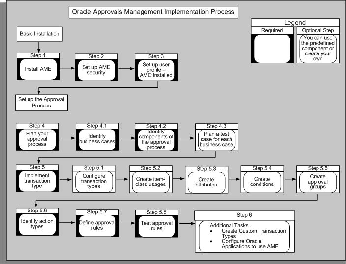

The following graphic illustrates the AME implementation process. Depending on your organization's requirements, you may be able to skip some of the implementation steps. Please ensure you understand them all, even if you expect to skip some of them.
Before you begin using an AME transaction type, you should document the approvals processes that the transaction type must implement. A transaction type's requirements document should specify the following:
A set of business cases
How to represent the business cases in AME by defining a set of configuration-variable values, item class use, mandatory-attribute values, approver groups, and rule use sufficient to express each business case.
A representative test case for each business case.
A transaction type's requirements document should account for four types of business cases:

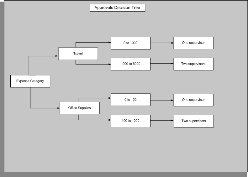

Rules and Rule Use
If your organization has more than a few approvals rules, it can be useful to represent the rules in an approvals matrix or a decision tree. An approvals matrix is just a table that had one row per rule. The right-most column contains one or more actions; the other columns contain sets of allowed values for a given attribute. Here's a fragment of an approvals matrix for expense reports, where the rules only depend on the expense category and the expense-report total:
| Expense Category | Total | Action |
| Travel | up to $1,000 | one supervisor |
| Travel | over $1,000 and not over $5,000 | two supervisors |
| Office supplies | up to $1,000 | one supervisor |
| Office supplies | over $1,000 and not over $5,000 | two supervisors |
(This table is a fragment because it does not account for important business cases. For example, it does not account for expense reports for travel totaling over $5,000. A real approvals matrix should generally be enumerating the business cases exhaustively, even when some of them require no approval, or merely require requestor approval.)
A decision tree typically has one column of nodes for each attribute, with each branch leaving a node representing a set of allowed values for the attribute represented by the node. The final (leaf) nodes represent actions, and a path from the root node to a leaf node represents a rule. The following decision tree is equivalent to the above approvals-matrix fragment:
Decision trees are more flexible than approvals matrixes because they do not have to have the same attributes in the same order along all of the paths from the root node to the leaf nodes. This makes decision trees appropriate where your approval rules' conditions will not all be defined on the same set of attributes. It also complicates verifying that the decision tree represents all of your business cases. When you use a decision tree to represent your set of rules, make sure there is a one-to-one correspondence between your business cases and the tree's paths from the root node to the leaf nodes.

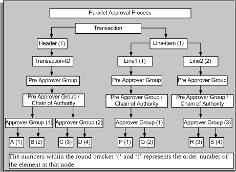

Approval process parallelization shortens a transaction’s approval process time. The parallel approval process imposes a hierarchical (tree) structure on the transaction’s approver list and enables each part of the tree at a given level to progress through its notification-approval cycle asynchronous. This enables the approval process of each item in the transaction to continue irrespective of the progress of approval process of other items in the transaction and reduces the transaction's approval process time.
The detailed behavior of parallelization is as follows:
AME engine constructs an approver tree based on the parallelization configuration at each level.
The AME engine calculates the order numbers for each level and the approvers at each leaf of approver tree.
The approval process of nodes which are in parallel with respect to each other start at the same time.
There after, the approval process of each node proceeds independently.
Approver List
The approver list for a single transaction has a hierarchical (inverted tree) structure with six subordinate levels. Proceeding from the root downward, the levels are:
Item class
Item
Sub-list
Action type
Group or chain
Group or chain member
There can be many objects at a given level for a single object at the next higher level.
The following graphic illustrates an example of the parallel approval process:
From the example given in the graphic, the approver-list tree requires the following eight approvals:
A
B
C
D
P
Q
R
S
For example, as seen in the graphic, the sub-tree under 'header' item class progresses independently irrespective of approval process of the sub-tree under ‘line-item’ item class because they have the same order number. The progress of approvers A, B, C, and D is independent from the progress of approvers P, Q, R, and S, as the item-classes are in parallel. The parallel approval process progresses as follows:
A and P are notified
A approves
B notified
B approves
C notified
P approves
Q notified
Q and C approve
D and R notified
D approves
At this stage, AME does not return any approvers as there are no approvers after D to approve.
R approves
S notified
S approves
AME completes the approval process.
If you decided to start the approval processes for each item class and again for each item at the same time, then there would be three sub-processes running in parallel. The process for the header would start with A. The line item 1 will start with P and line item 2 would start with R.
To shorten the transaction's approval process further, you could notify all of the approvers in a group or chain at once. Then the process for the header would begin by notifying A, B, C, and D. When all these approvers approve, the approval process for header is complete. Now the longest sub-process of the transaction's overall approval process would require just two notification-approval cycles. In terms of approver order numbers, the list would be:
1 - A
1 - B
1 - C
1 - D
1 - P
2 - Q
1 - R
2 - S
Returning to the example, the decision to parallelize approvals at the item class and item levels amounts to assigning order number 1 to all the item classes, and setting each item class' parallelization mode to parallel. Likewise, the decision to parallelize the transaction's approver groups and chains of authority amount to choosing consensus voting regimes for the approver groups 1 and 2. The example's final approver list, which is consistent with the order number and ordering mode decisions explained above is as follows:
1 - A
1 - B
1 - C
1 - D
1 - P
2 - Q
1 - R
2 - S
If the approver list has repeated approvers, then AME suppresses them in a dynamic manner and based on the option selected for the configuration variable repeatedApprovers. See: Configuration Variables
It notifies repeated approvers in the first occurrence during the approval process. For example, let us take the case of two items whose approval is progressing in parallel. Item 1 has three approvers, M, N, and O; Item 2 has three approvers, T, W, and O. The approvers are in serial for each item. With the repeated approver functionality, the occurrence of O in item 2 is set to repeated. However, during the approval process, based on the progress of approvals for item 2, the occurrence of O in item 1 becomes repeated.

To implement AME, you need to carry out the following steps:
Install the application.
AME’s installation routines and administration features determine which applications can use AME. Installation and administration are typically jobs for a technical specialist. Installation is generally done only once, and administrative tasks (using AME’s Administrator Dashboard) are usually only necessary to enable a new application to use AME, or to access or clear a transaction’s error log.
Set up AME security by completing the following:
Attach the predefined roles to a user or group of users.
AME uses the Role Based Access Model (RBAC) to provide users access to AME functions. This access model has the following predefined roles:

Set the user profile - AME:Installed
This user profile is predefined by AME and is available for integrating applications such as Internet Expenses, iProcurement, to make use of. It is set at the application level and can be used by that application to determine if AME is installed and if so what action to take. In some instances this determination is used to decide if AME should be used for the approval process of that application, this is not always the case however. Please review the specific documentation of the integrating application to determine if that application uses this user profile.
Configure transaction types.
An application administrator should review AME's configuration-variable values as soon as AME is installed and its security has been set up. AME has the following kinds of configuration variables:

To implement the transaction type, you need to specify or create, if required, the following components of the approval process:
Create item-class use (Optional).
Once you have documented the approval processes you want a transaction type to implement, you can begin implementing the transaction type. The first step is to register any custom item-class use your transaction type requires.
Create transaction attributes (Optional).
In AME, an attribute is a named business variable such as TRANSACTION_AMOUNT, whose value AME fetches at run time, when it constructs transactions’ approver lists. Only a user with the Application Administrator responsibility can create or alter attributes (using the Attributes tab), because doing so generally requires entering or changing an SQL query.

Create conditions (Optional).
In AME, a condition specifies a list or range of attribute values required to make a rule apply to a transaction. For example:

Create approver groups (Optional).
You can create AME rules to include one or more approver groups in a transaction’s approver list. You create and maintain approver groups using the Approver Groups tab. You must create an approver group before using it in an approval-group rule. You can also add existing approver groups to an approval-group rule.
Prepare to use the action types.
You add action types to a transaction type using the Action Types tab. The action types available to use are:

Define approval rules.
With your item-class use, attributes, conditions, approver groups, action types, and actions prepared, you can create your approval rules using the Rules tab. Again, an approvals matrix or decision tree may serve as a convenient checklist.
In AME, an approval rule associates one or more conditions with an approval action. The rule applies to a transaction if and only if all of the rule’s conditions are true for the transaction.

Test approval rules.
Once a transaction type has a set of rules, it is critical to test the rules, to ensure they apply to the proper cases and do not contain logical gaps or inconsistencies. You can store these test cases to reuse later.
There are three ways to test a transaction type:

Create custom transaction types.
It is possible to create a custom transaction type from scratch, for instance to use AME as the approvals engine for a custom application. Transaction-type creation is beyond the scope of this guide. If your organization wants to create a custom transaction type, contact Oracle Support and request the Oracle Approvals Management Developer Guide. Also see: Creating a Transaction Type.
Configure Oracle applications to use AME.
An Oracle Application should be configured to use AME only after thoroughly testing the set(s) of rules defined for that application’s transaction type(s) in AME. Consult the application’s user or technical documentation to learn how to configure the application to use AME.
