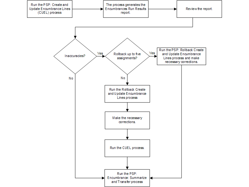

After the PSP: Create and Update Encumbrance Lines process completes its tasks, the process generates the Encumbrance Run Results report, which you can view from the Requests window. Use the Encumbrances Run Results report to detect inaccuracies (such as incorrect charging instructions) before you transfer the encumbrances to Oracle General Ledger or Oracle Grants Accounting.
If you detect inaccuracies, then you must run the PSP: Rollback Create and Update Encumbrance Lines process to undo the encumbrance calculations. You can undo the calculations for the entire process or up to five employees simultaneously. The Rollback Create and Update Encumbrance Lines process reverts encumbrances that the PSP: Create and Update Encumbrance Lines process created. You can run the PSP: Create and Update Encumbrance Lines process to create the encumbrance lines again.
The following figure illustrates how you can review and undo encumbrances:

Use the PSP: Create and Update Encumbrance Lines process to create, update, and liquidate encumbrances.
See: Processes
To run the Create and Update Encumbrance Lines process
Navigate to the Submit Requests window.
In the Name field, select the PSP: Create and Update Encumbrance Lines process.
In the Parameters window, select the payroll that the process must use. If you do not specify the payroll, then the application runs the process for all the payrolls that you selected in the Encumbrance Payroll and Assignment Selection window.
Submit the process. The Create and Update Encumbrance Lines process automatically generates the Encumbrance Run Results report. View this report from the Requests window to display the encumbrances that the process creates.
Note: If the PSP: Create and Update Encumbrance Lines process fails (for example, if the FastFormula that you specified is not valid), then you can fix the errors and run the PSP: Retry Create and Update Encumbrance Lines process.
