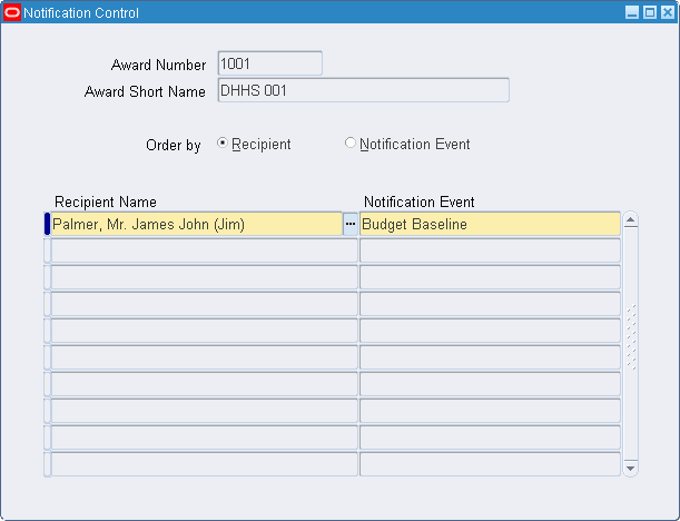

Setting Up Notification Recipients Procedure
the picture is described in the document text
To set up notification recipients for Workflow, perform the following steps.
  1. In Grants Accounting, navigate to the Find Award window as follows:
    Awards
  2. Enter search parameters for an award and click Find to execute the search.
    The Award Management Folder window appears.
  3. Select the award and click Open to go to the Award Management window.
  4. Navigate to the Notification Control window as follows:
    Tools - Notification Control
  5. Enter data in each field of the Notification Control window as described in the Notification Control Window Description table.
    Note: Assign each event notification to a recipient separately.
  6. Save or save and continue as follows:
    File - Save or Save and Proceed
  7. Close the window.
Field Name Type Features Description
Award Number default, display only   award number
Award Short Name default, display only   award short name
Order by default, required radio button specifies order that recipients are listed; ordered by Recipient or Notification Event. Default selection is Recipient.
Recipient Name required list of values name of award personnel that should receive Workflow notification. Users can add or delete recipients.
Note: Award personnel for an award are automatically entered and assigned to each event. For example, if there are 2 award personnel and 5 events, the 2 award personnel are each assigned to all 5 events so that 10 entries appear in the window. Users can add or delete recipients.
Note: Award personnel are defined in the Personnel Tab region of the Award Management window.
Notification Event required list of values event that the recipient should receive notifications for. Recipient event options are for installments, reports, and budgets.
Note: Recipients must be assigned to each event separately. For example, if there are 40 events and a recipient should receive notifications for all 40 events, the recipient must be entered in this window 40 times.
