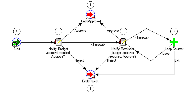

The Budget Subprocess is initiated during the budget workflow process when a budget approver or award manager for a budget is selected. The subprocess notifies the budget approver or award manager that a budget has been submitted for approval. The award manager can approve or reject the budget.

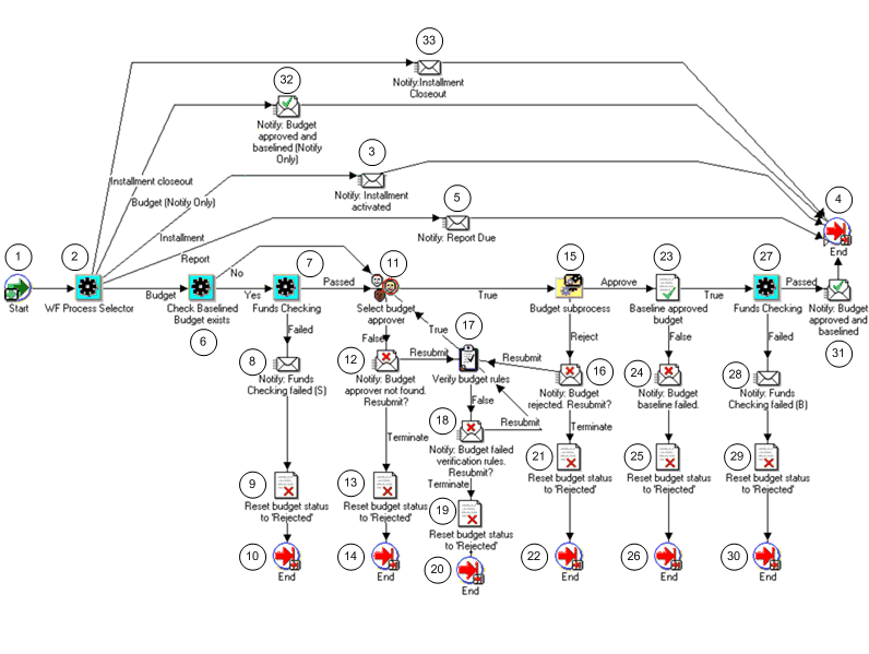

The diagram below shows the Grants Accounting workflow nodes as described in the accompanying text.
Grants Accounting Workflow Diagram
This section describes the Grants Accounting Workflow process.
This is a standard function activity that marks the start of the process.
| Function | Result Type | Prerequisite Activities |
| WF_STANDARD.NOOP | None | None |
This function activity determines whether the installment, report, or budget notification process is selected.
| GMS_WF_PKG.SELECT_WF_ PROCESS | GMS WF Process Selector | Start |
This activity notifies key members that the installment is activated.
| Message | Result Type | Prerequisite Activities |
| Installment Active | None | WF Process Selector |
This function activity marks the end of the process.
| WF_STANDARD.NOOP | None | Notify: Installment Activated or Notify: Report Due or Notify: Budget Approved and Baselined |
This activity automatically notifies key members, at a specified time period such as 30 days, that the report is due.
| Report Due | None | WF Process Selector |
This function activity checks whether a baseline budget exists.
| GMS_WF_PKG.CHK_ BASELINED_BUDGET_EXISTS | GMS Baselined Budget Exists [Yes or No] | WF Process Selector |
This function activity checks to see if funds are available.
| GMS_WF_PKG.FUNDS_CHECK | Funds Checking Result [Passed or Failed] | Check Baselined Budget Exists |
This activity notifies the person that submitted the budget that funds check failed.
| Funds Checking failed (S) | None | Funds Checking |
This function activity resets the budget status to rejected.
| GMS_WF_PKG.REJECT_BUDGET | None | Notify: Funds Checking Failed (S) |
| WF_STANDARD.NOOP | None | Reset Budget Status to Rejected |
This function activity selects a person that can approve the budget for baselining.
| GMS_WF_PKG.SELECT_ BUDGET_APPROVER | Boolean | Check Baselined Budget Exists or Funds Checking or Verify Budget Rules |
This activity notifies the person that submitted the budget that the budget approver was not found. You can create an award manager and resubmit or terminate the budget.
| Budget approver not found. | Resubmission [Resubmit or Terminate] | Select Budget Approver |
| GMS_WF_PKG.REJECT_BUDGET | None | Notify: Budget Approver Not Found. Resubmit? |
The budget subprocess notifies the budget approver or award manager that a budget is submitted for approval.
For information on the Budget Subprocess, see Budget Subprocess.
| Approval | Select Budget Approver |
This activity notifies the person that submitted the budget that the budget was rejected. The user can terminate or resubmit the budget.
| Budget rejected | Resubmission | Budget Subprocess |
This function activity checks to see whether any budget lines exist.
| GMS_WF_PKG.VERIFY_BUDGET_RULES | Boolean | Notify: Budget Approver Not Found. Resubmit? or Notify: Budget Rejected. Resubmit? or Notify: Budget Failed Verification Rules. Resubmit? |
This activity notifies the person that submitted the budget that no budget lines exist. Users can create budget lines and resubmit the budget or terminate the budget.
| Budget failed verification rules | Resubmission | Verify Budget Rules |
| GMS_WF_PKG.REJECT_BUDGET | None | Notify: Budget Failed Verification Rules. Resubmit? |
| GMS_WF_PKG.REJECT_BUDGET | None | Notify: Budget Rejected. Resubmit? |
This function activity baselines the approved budget.
| GMS_WF_PKG.BASELINE_ BUDGET | Boolean | Budget Subprocess |
This activity notifies the person that approved the budget that the budget baseline failed.
| Budget baseline failed. | None | Baseline Approved Budget |
| GMS_WF_PKG.REJECT_BUDGET | None | Notify: Budget Baseline Failed |
| GMS_WF_PKG.FUNDS_CHECK | Funds Checking Result | Baseline Approved Budget |
This activity notifies the person that approved the budget that funds checking failed during baselining.
| Funds Checking failed (B) | None | Funds Checking |
| GMS_WF_PKG.REJECT_BUDGET | None | Notify: Funds Checking Failed (B) |
This activity notifies all key members that the budget is approved and baselined.
| Budget approved and baselined. | None | Funds Checking |
This activity notifies all key members that the budget is approved and that the baseline processing has created a baseline version of the award budget.
| Budget approved and baselined. | None | WF Process Selector |
This activity notifies all key members when an installment end date approaches.
| Installment Closeout | None | WF Process Selector |
The diagram below shows the budget subprocess nodes as described in the accompanying text.
This section describes the Budget Subprocess.
This activity notifies the budget approver or award manager that a budget is submitted for approval.
| Budget approval required. | Approval | Start |
| WF_STANDARD.NOOP | None | Notify: Budget Approval Required. Approve? or Notify: Reminder Budget Approval Required. Approve? |
| WF_STANDARD.NOOP | None | Notify: Budget Approval Required. Approve? or Notify: Reminder Budget Approval Required. Approve? or Loop Counter |
This activity sends the budget approver or award manager a reminder that a budget is submitted for approval. The award manager can approve or reject the budget.
| Reminder: budget approval required. | Approval | Notify: Budget Approval Required. Approve? or Loop Counter |
This function activity checks whether the budget is approved or rejected. If no action has been taken, the function activity initiates another notification to the budget approver or award manager. After a specified number of timeouts defined by users, the function activity exits the workflow.
| WF_STANDARD. LOOPCOUNTER | Loop Counter | Notify: Reminder Budget Approval Required. Approve? |
