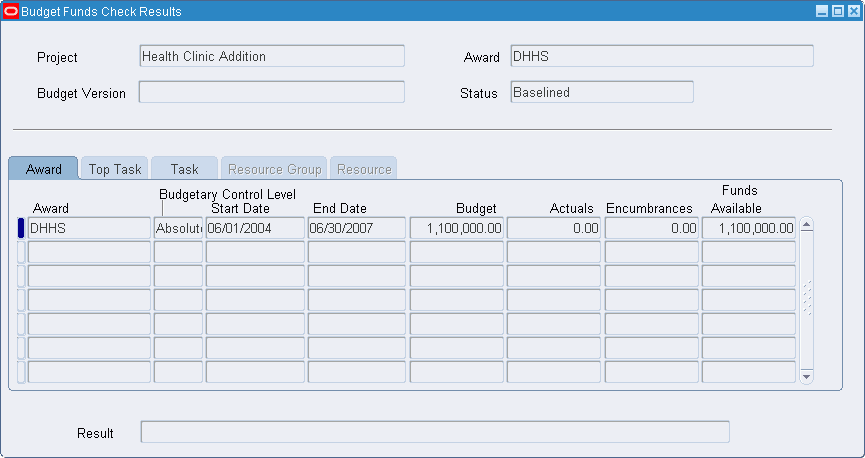

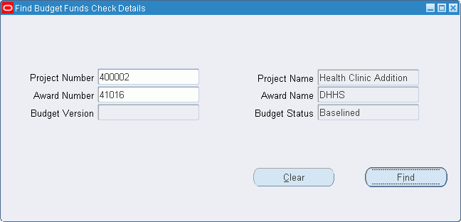

If an award budget fails funds check during the submit or baseline processes, users can view the Budget Funds Check Results window to determine why funds check failed.
Note: The first time an award budget is baselined, the funds check process is not necessary and thus is not activated.
Funds check results are dependent on budgetary control settings. If a budgetary control setting is Absolute, funds check will verify that the new budget amount is greater than or equal to the total amount of existing transactions. If the new budget amount is less than the total existing transactions, the budget will fail funds check.

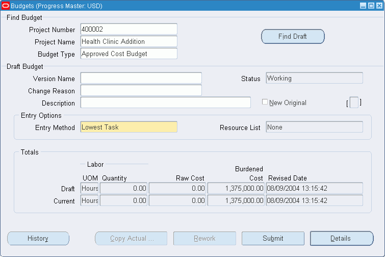

To enter an original award budget, perform the following steps.
In Grants Accounting, navigate to the Award Budgets window as follows:
Budgets - Award Budgets
In the Award field, select an award from the list of values.
Note: To select a particular award from the list of values, the award must already be entered and associated with a project.
In the Project Number field, enter a project number or in the Project Name field, enter a project name, or select the project number or project name from the list of values.
Click Find Draft.
The fields in the Entry Options region are populated, the Status field displays a status of Working, and the Draft fields in the Totals region displays only the current date in the Revised Date field.
Note: Users can accept or change the default budget entry method. The budget entry method selected by users affect funds check. To verify the compatibility of budget entry method and budgetary control settings and the compatibility of budget entry method time phase with budgetary control time intervals, see Budget Entry Method, Budgetary Control, and Funds Check.
Note: Users can accept or change the default resource list when entering an original draft budget for the award. Select the correct resource list before entering budget lines. If the resource list is changed after entering budget lines for the draft budget, Grants Accounting deletes the draft lines, and users must reenter the budget lines. Resource lists cannot be changed after the budget version is baselined.
Optionally, enter the version name in the Version Name field.
Optionally, enter a description for the budget version in the Description field.

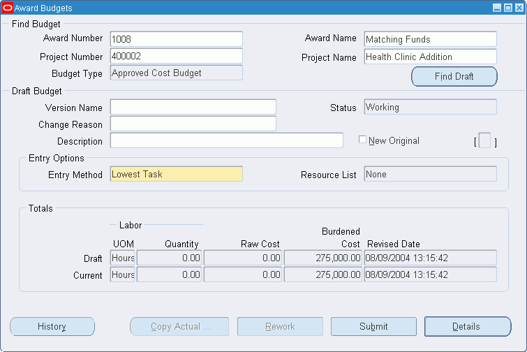

To find a draft award budget, perform the following steps.
In the Project Number field, select a project number and a project name from the list of values.
To find an existing draft award budget, click Find Draft.

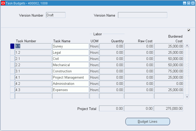

From the Award Budgets window, click Details.
Note: If entering an award budget at the project level, the Budget Lines window appears.
Note: If entering an award budget at the task level, the Task Budgets window appears.
From the Task Budgets window, click Budget Lines to open the Budget Lines window.

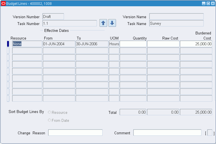

Note: Date Range is a user-defined budgeting period. When users define a budget entry method, they specify the level at which they want to budget, whether to budget by resource, and the budgeting time period. The time periods that users select from when defining the budget entry method include Date Range, General Ledger Period, Projects Period, and None. Grants Accounting recommends users adopt the following guidelines when entering budgets in the Budget Lines window that are time phased by Date Range:
Do not overlap beginning and ending budgeting time periods.
Plan budgeting time periods and test to confirm that the system accepts the specified date ranges.
The following is an example of acceptable date ranges:
Resource 1 is budgeted for date range 01/01/99 - 06/30/99
Resource 2 is budgeted for date range 01/01/99 - 06/30/99
Resource 1 is budgeted for date range 07/01/99 - 12/31/99
The following is an example of unacceptable date ranges:
Resource 1 is budgeted for date range 01/01/99 - 12/31/99
Enter budget lines.
For information on entering budget lines, see Entering Budget Lines, Oracle Project Management User Guide.
For information on budget entry, see Budget Entry Method, Budgetary Control, and Funds Check.

To revise a baselined award budget, perform the following steps.
From the Award Budgets window, change the award budget version name in the Version Name field.
In the Change Reason field, enter a reason for changing the award budget version from a previous version.
In the Description field, enter a description for the new award budget version.
Update the draft.
To update the draft award budget, see Entering Award Budget Lines in this chapter.
From the Award Budgets window, click Submit.
Note: If you delete all budget lines from the current working version, then you cannot submit the budget version for approval and baseline processing. You must enter at least one budget line for a burdened cost of zero before you can submit the version.
Note: When the budget is submitted, a notification window appears assigning a concurrent program identification number. If you requery the window without Workflow enabled, then the Submit button is replaced by Baseline, the budget status changes from Working to Submitted, and the budget is ready for you to create a baseline version. If you requery with Workflow enabled, then the Submit button is grayed out and the award budget is ready for approval in Workflow.
Note: If the budget fails funds check, the button remains Submit. If Workflow is enabled when the budget fails funds check, the budget is not forwarded to Workflow for approval. If the budget does not fail funds check and Workflow is enabled, the Submit button is grayed out.
Note: If Workflow is not enabled and the GMS: Enable Funds Check for Budget Submission profile option is set to No, then budget submission will skip funds checking.
From the Award Budgets window, click Baseline.
Note: When you create a baseline budget version, a notification window appears assigning a concurrent program identification number. If you requery the window without Workflow enabled, then the Baseline button is replaced by the Submit button and the budget status changes from Submitted to Working.
Note: If the budget fails funds check, the button remains Baseline.
For information on baselining a draft award budget, see Baselining a Draft, Oracle Project Management User Guide.
To approve a budget in Workflow, see Approving Notifications Procedure.

| Field Name | Type | Features | Description |
| Award Number | required | list of values | award number |
| Award Name | required | list of values | award name |
| Project Number | required | list of values | project number will default in if project name is entered |
| Project Name | required | list of values | project name will default in if project number is entered |
| Budget Type | read only | budget type description; defaults in Approved Cost Budget | |
| Find Draft | button | pulls in information from project and award budget combination | |
| Version Name | optional | budget version | |
| Status | read only | When users enter or update a draft award budget, the field displays Working. When a draft award budget is submitted, the field displays Submitted. | |
| Change Reason | optional | reason for change | |
| Description | optional | budget description | |
| New Original | optional | check box | if selected, this draft award budget, when baselined, becomes revised original budget |
| Descriptive Flexfield | optional | field for user customization | |
| Entry Method | required | list of values | determines budgeting level of work breakdown structure and whether budget is time-phased or non-time phased |
| Resource List | required | list of values | determines whether budget is by summary amounts or by detail budget lines categorized by resource |
| Draft UOM | display only | displays unit of measurement for labor for working budget version that was not baselined | |
| Draft Quantity | display only | displays sum of labor hours for working budget version that was not baselined | |
| Draft Raw Cost | display only | displays sum of raw costs for working budget version that was not baselined | |
| Draft Burdened Cost | display only | displays sum of burdened costs for working budget version that was not baselined | |
| Draft Revised Date | display only | displays revision date for working budget version that was not baselined | |
| Current UOM | display only | displays unit of measurement for labor for most recent baselined budget version | |
| Current Quantity | display only | displays sum of labor hours for most recent baselined budget version | |
| Current Raw Cost | display only | displays sum of raw costs for most recent baselined budget version | |
| Current Burdened Cost | display only | displays sum of burdened costs for most recent baselined budget version | |
| Current Revised Date | display only | displays revision date for most recent baselined budget version | |
| History | button | displays prior award budget | |
| Copy Actual | button | copies actual amounts to budget amounts | |
| Rework | button | changes budget status from submitted to working | |
| Submit | button | sends request to concurrent manager to run GMS: Submit/Baseline Award Budgets | |
| Details | button | displays award budget details |
| Version Number | display only | budget version number | |
| Version Name | display only | budget version name | |
| Task Number | display only | unique identification number of task within project | |
| Task Name | display only | descriptive task name | |
| UOM | display only | labor unit of measure for task number and task name | |
| Quantity | display only | quantity of labor unit of measure for task number and task name | |
| Raw Cost | display only | total raw cost for task number and task name | |
| Burdened Cost | display only | total burdened cost for task number and task name | |
| [Quantity] Project Total | display only | total quantity of labor unit of measure for all project tasks | |
| [Raw Cost] Project Total | display only | total raw costs for all project tasks | |
| [Burdened Cost] Project Total | display only | total burdened costs for all project tasks | |
| Budget Lines | button | opens Budget Lines window |
| Task Number | display only | up and down arrows | unique identification number of task within project |
| Task Name | display only | descriptive name of task within project | |
| View Lines For | read only | displays burdened cost | |
| Period For Totals | list of values: pop-up calendar | beginning and ending dates for budget periods | |
| Budget Periods Earliest | read only | earliest budget period date | |
| Budget Periods First | required | list of values: pop-up calendar | first budget period |
| Budget Periods Latest | read only | latest budget period | |
| Resource | required | list of values | allows users to select resource that users want to budget. Resources are user-defined categories of labor, services, materials, and equipment needed to track, complete, and account for project work. |
| Amount Type | required | list of values | allows user to select an amount type allowed by budget entry method. In Grants Accounting, amount type must be Burdened Cost. |
| [Month--Year] | required | left and right arrow buttons | Budget amount for resource, amount type, and budget period displayed. Use left and right arrow buttons to change budget periods displayed. |
| Period Totals | read only | total of all displayed budget periods for a resource and amount type | |
| Sort Budget Lines By | optional | option button | Enables user to select an option to order budget lines by resource or by period start date. This option is only available if the time phase is Date Range. |
| Change Reason | optional | list of values | enabled by pressing Tab key on keyboard; user-defined reasons for revising budget lines for resource and budget period |
| Comments | optional | descriptive comments for revising budget lines for the resource and budget period |
To view the funds check results of an award budget that failed the budget baseline process, perform the following steps.
In Grants Accounting, navigate to the Find Funds Check Details (Budget) window as follows:
Budgets - Funds Check Results (Budget)
Enter data in the Find Funds Check Details (Budget) window as described in the Find Budget Funds Check Details Window Description table.
Click Find to open the Budget Funds Check Results window.
Review each field of the Budget Funds Check Results window as described in the Budget Funds Check Results Window Description, Awards Tab table.
Close the window.
| Project Number | required | list of values | project number |
| Project Name | default, display only | project name | |
| Award Name | default, display only | award name | |
| Budget Version | default, display only | budget version. Field populated after project number and award number entered. | |
| Budget Status | default, display only | status of budget | |
| Clear | button | erases data from fields | |
| Find | button | opens Budget Funds Check Results window |
| Project | display only | project name | |
| Award | display only | award name | |
| Budget Version | display only | budget version | |
| Status | display only | status of funds check; Pending, Approved, Rejected, or Fatal | |
| Result | display only | result of funds check at task level; transaction passed or failed funds check at task level | |
| Budgetary Control Setting | display only | budgetary control setting; Absolute, Advisory, or None | |
| Start Date | display only | award budget start date | |
| End Date | display only | award budget end date | |
| Budget | display only | new budget amount | |
| Actuals | display only | actuals amount | |
| Encumbrance | display only | encumbrance amount | |
| Funds Available | display only | amount of award budget funds available |

The project budget is a consolidation or summary of all the award budgets funding a project. When an award budget is baselined, the project budget is automatically summarized.
Oracle Grants Accounting determines summary amounts for the Project Approved Cost Budget when you submit the process to create a baseline. If multiple award budgets fund a single project, then this process automatically determines the budget entry method to use for the project budget. The following business rules determine the budget entry method that Oracle Grants Accounting uses during the baseline process:
If the award budgets for the project use the same budget entry method, resource list and period type, then Oracle Grants Accounting uses the specified budget entry method and resource list for the project budget.
Using the profile option: GMS: Project Budget Entry Method - Categorized by Resource
Oracle Grants Accounting uses the budget entry method specified in this profile option when either of the following conditions exist:
The award budgets use different budget entry methods, but the same resource list
The award budgets use the same budget entry method and resource list, and are time phased by date range
If this profile option is not defined, the user will receive an error message when attempting to submit the award budget.
Using the profile option: GMS: Project Budget Entry Method - Uncategorized
The award budgets use different budget entry methods and different resource lists
The award budgets use budget entry methods with different resource lists and are time phased by date range
In Grants Accounting, a project budget is available for viewing only. To view a project budget, perform the following steps.
In Grants Accounting, navigate to the Project Budgets window as follows:
Budgets - Project Budgets
The Project Budgets window appears.
In the Project Number field, enter the project number and press the Tab key on the keyboard to populate the Project Name field.
In the Budget Type field, select Approved Cost Budget from the list of values.
Note: For sponsored projects only, the Project Budgets window can be used to enter other budget types, such as Forecast Cost Budgets.
Click Find Draft to view consolidated budget information.
For information on defining the budget entry method, see Oracle Grants Accounting Setup Overview.
Close the window.
| Project Number | required | project number | |
| Project Name | required | project name | |
| Budget Type | required | list of values | users must choose Approved Cost Budget from the list of values to view a consolidation of award budgets |
| Find Draft | button | searches for data based on parameters entered | |
| Version Name | display only | list of values | budget version Note: display only for Approved Cost Budget; optional for all other budget types |
| Status | display only | active or inactive | |
| Change Reason | display only | reason for change Note: display only for Approved Cost Budget; optional for all other budget types | |
| Description | display only | budget description Note: display only for Approved Cost Budget; optional for all other budget types | |
| New Original | display only | check box | select to create a new original Note: display only for Approved Cost Budget; optional for all other budget types |
