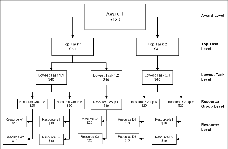

The figure on the following page shows a diagram of funds check rollup levels for a sample award.
Funds Check Rollup Levels
At the Resource level, the available budgets for resources are rolled up into the available budget for the Resource Group level. The available budgets for the resource groups roll up into the available budget for the Lowest Task level. The available budgets for the lowest tasks then roll up into the available budget for the Top Task level. Finally, the available budgets for the top tasks roll up into the available budget for the Award level.
For example, as illustrated for Top Task 1 in the diagram above, Resource A1 and Resource A2 each have a total available budget of $10. Combined, the total budgets of Resource A1 and A2 roll up into the available budget of $20 at the Resource Group A level. The total available budgets of Resource Group A and Resource Group B roll up into the available budget of Lowest Task 1.1, which equals $40. The total available budgets of Lowest Task 1.1 plus Lowest Task 1.2 roll up into the available budget of Top Task 1, which equals $80. The total available budget of Top Task 1, $80, plus the total available budget of Top Task 2, $40, roll up into the available budget of Award 1, which equals $120.
The Funds Check Rollup Example shows two examples of resource level rollups.
Transaction 1 for $15, charged against Resource A1 with a total budget of $10, is funds checked with a budgetary control setting of Advisory. The transaction passes with an advisory notice and is then rolled up to Resource Group A. At the Resource Group A level, with a budgetary control setting of Absolute, and a total budget of $20, Transaction 1 passes funds check without an advisory notice.
Since Transaction 1 passes funds check, the available budget for Resource A1 is updated to $ -5. The available budget for Resource A2 remains $10. The rolled up available budget for Resource Group A is updated to $5.
Transaction 2 for $10, charged against Resource A2 with a total budget of $10, is funds checked with a budgetary control setting of Advisory. Transaction 2 passes funds check without an advisory notice. However, Transaction 2 fails funds check when it is rolled up to the Resource Group A level because the available budget, after Transaction 1 passed, of $5 is insufficient to cover the $10 transaction.
Due to the budgetary control settings, Transaction 1 used a portion of the available Resource A2 budget at the Resource Group A level.

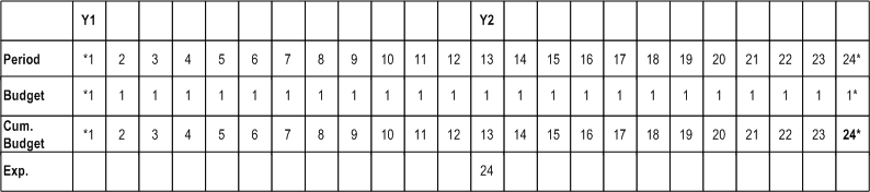

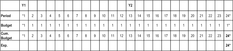

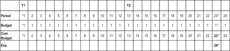

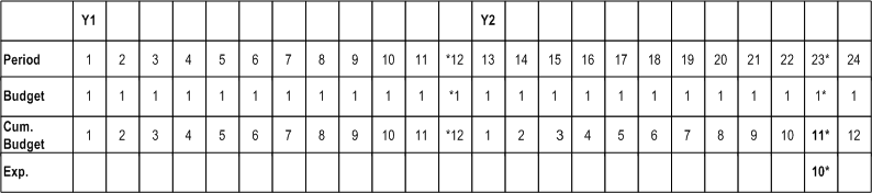

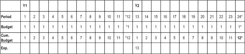

Funds check calculations are not based upon the system date, which is the current date. They are based upon the expenditure item date. The funds check process determines the available budget by summing budget periods based on the time interval parameters of amount type and boundary code and then subtracting actual and encumbrance amounts.

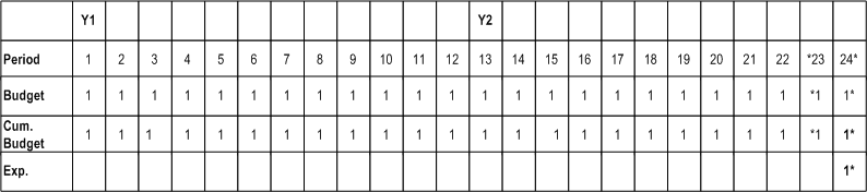

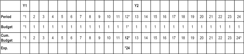

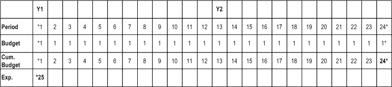

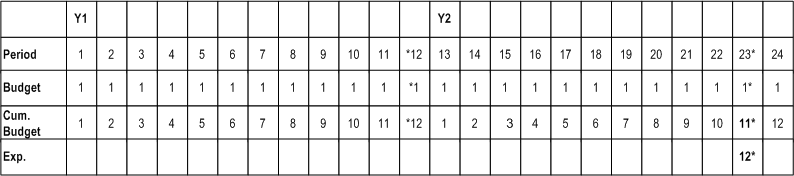

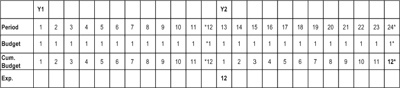

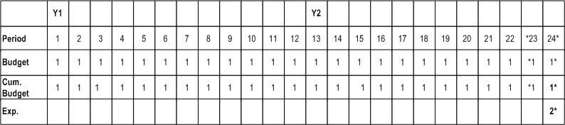

The following figures show funds check calculations based on the following conditions:
two year award with 24 periods
periods are GL, PA, or date range
one dollar is budgeted per period for the duration of the award
cumulative budget varies depending upon whether the amount type is project-to-date, year-to-date, or period-to-date
last row of the each figure shows the expenditure item amount for the example
Figures also include asterisks before the beginning time period, representing the amount type, and asterisks after the ending time period, representing the boundary code.
Y1 represents year one in the tables and Y2 represents year two.
The example below shows a failed example of funds check based upon an amount type/boundary code of Project-to-Date/Project. Funds check failed because the sum of the budget, $24, from the project start to the project end, is less than the expenditure of $25.
Example of Funds Check Failed Using Amount Type/Boundary Code Parameters of Project-to-Date/Project
The example below shows a passed example of funds check based upon an amount type/boundary code of Project-to-Date/Project. Funds check passed because the sum of the budget, $24, from the project start to the project end, is equal to or greater than the expenditure of $24.
Example of Funds Check Passed Using Amount Type/Boundary Code Parameters of Project-to-Date/Project
The example below shows a failed example of funds check based upon an amount type/boundary code of Project-to-Date/Year. Funds check failed because the sum of the budget, $12, from the project start to the fiscal year end in which the expenditure item occurs, is less than the expenditure of $24.
Example of Funds Check Failed Using Amount Type/Boundary Code Parameters of Project-to-Date/Year
The example below shows a passed example of funds check based upon an amount type/boundary code of Project-to-Date/Year. Funds check passed because the sum of the budget, $24, from the project start to the fiscal year end in which the expenditure item occurs, is equal to or greater than the expenditure of $24.
Example of Funds Check Passed Using Amount Type/Boundary Code Parameters of Project-to-Date/Year
The example below shows a failed example of funds check based upon an amount type/boundary code of Project-to-Date/Period. Funds check failed because the sum of the budget, $23, from the project start to the period end in which the expenditure item occurs, is less than the expenditure of $24.
Example of Funds Check Failed Using Amount Type/Boundary Code Parameters of Project-to-Date/Period
The example below shows a passed example of funds check based upon an amount type/boundary code of Project-to-Date/Period. Funds check passed because the sum of the budget, $24, from the project start to the period end in which the expenditure item occurs, is equal to or greater than the expenditure of $24.
Example of Funds Check Passed Using Amount Type/Boundary Code Parameters of Project-to-Date/Period
The example below shows a failed example of funds check based upon an amount type/boundary code of Year-to-Date/Year. Funds check failed because the sum of the budget, $12, from the fiscal year start to the fiscal year end in which the expenditure item occurs, is less than the expenditure of $13.
Example of Funds Check Failed Using Amount Type/Boundary Code Parameters of Year-to-Date/Year
The example below shows a passed example of funds check based upon an amount type/boundary code of Year-to-Date/Year. Funds check passed because the sum of the budget, $12, from the fiscal year start to the fiscal year end in which the expenditure item occurs, is equal to or greater than the expenditure of $12.
Example of Funds Check Passed Using Amount Type/Boundary Code Parameters of Year-to-Date/Year
The example below shows a failed example of funds check based upon an amount type/boundary code of Year-to-Date/Period. Funds check failed because the sum of the budget, $11, from the fiscal year start to the period end in which the expenditure item occurs, is less than the expenditure of $12.
Example of Funds Check Failed Using Amount Type/Boundary Code Parameters of Year-to-Date/Period
The example below shows a passed example of funds check based upon an amount type/boundary code of Year-to-Date/Period. Funds check passed because the sum of the budget, $11, from the fiscal year start to the period end in which the expenditure item occurs, is equal to or greater than the expenditure of $10.
Example of Funds Check Passed Using Amount Type/Boundary Code Parameters of Year-to-Date/Period
