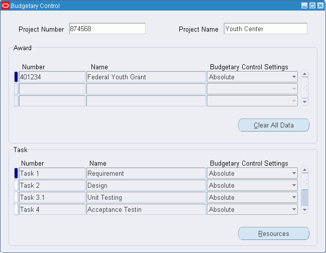

To change budgetary control settings for a project at the Award or Task levels, perform the following steps.
In Grants Accounting, navigate to the Budgetary Control window as follows:
Budgets - Budgetary Control
In the Project Number field, select a project number from the list of values or in the Project Name field, select a project name from the list of values.
The Award Number, Award Name, and Budgetary Control Settings fields are defaulted in.
Note: You must first create a baseline version for the award budget. If the award budget does not have a baseline version, the project does not appear in the list of values.
To change budgetary control settings, in the Award or Task region select Absolute, Advisory, or None from the Budgetary Control Settings field drop-down list.
The budgetary control settings selected by users affect funds check.
To verify the compatibility of budget entry method variables with budgetary control settings and the compatibility of budget entry method time phase with budgetary control time intervals, see Budget Entry Method, Budgetary Control, and Funds Check.
Save changes to budgetary control settings as follows:
File - Save or Save and Proceed
Close the window.
| Field Name | Type | Features | Description |
| Project Number | required | list of values | project number |
| Project Name | required | list of values | project name |
| Number | required | list of values | award number |
| Name | required | list of values | award name |
| Budgetary Control Setting | required | drop-down list | budgetary control setting for award; Absolute, Advisory, None |
| Clear All Data | button | erases data from fields | |
| Number | optional | list of values | task number |
| Name | optional | list of values | task name |
| Budgetary Control Settings | optional | drop-down list | budgetary control setting for task; Absolute, Advisory, None |
| Resources | button | opens Budgetary Control - Resources window |

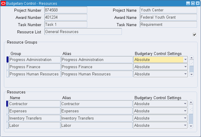

To change budgetary control settings for a project at the Resource Groups or Resource levels, perform the following steps.
Click Resources.
The Budgetary Control - Resources window appears.
In the Resource Groups or Resources region, change budgetary control settings as needed by selecting Absolute, Advisory, or None from the Budgetary Control Settings field drop-down list.
Close the window.
| Project Number | display only | project number | |
| Project Name | display only | project name | |
| Award Number | display only | award number | |
| Award Name | display only | award name | |
| Task Number | display only | task number | |
| Task Name | display only | task name | |
| Resource List | display only | resource list used by this project and award | |
| [Data Coordination Check Box] | optional | check box | If selected, data in the Budgetary Control - Resources window is automatically updated and coordinated with data from the Budgetary Control window. If deselected, data in window is updated only when users click in the window. |
| Note: Leave deselected to enhance performance when querying records in the Budgetary Control - Resources window. | |||
| Group | optional | list of values | resource group name |
| Alias | optional | list of values | resource group alias |
| Budgetary Control Settings | optional | drop-down list | budgetary control setting for resource group; Absolute, Advisory, None |
| Name | optional | list of values | resource name |
| Alias | optional | list of values | resource alias |
| Budgetary Control Settings | optional | drop-down list | budgetary control setting for resource; Absolute, Advisory, None |
