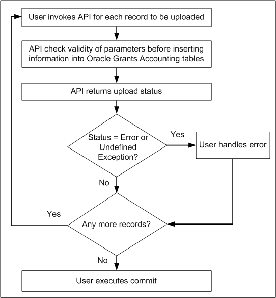

The Budget API Process Flowchart shows the Budget API process flowchart as described in the Budget API Process table.
The table below describes the Budget API process.
For additional information about budgets, see: Entering Award Budgets Procedure.
| Event | Description |
| 1. | Users invoke API for each record to be uploaded. |
| 2. | API checks validity of parameters before inserting information into Grants Accounting tables. |
| 3. | API returns the status of the upload. |
| 4. | An error or undefined exception message appears for each record that fails during the process. |
| 5. | Users handle errors. If necessary, user corrects input parameters based on error message. |
| 6. | Users re-execute APIs for failed records; events 1 - 3 repeat until all applicable records have been uploaded. |
| 7. | Users execute commit. |
